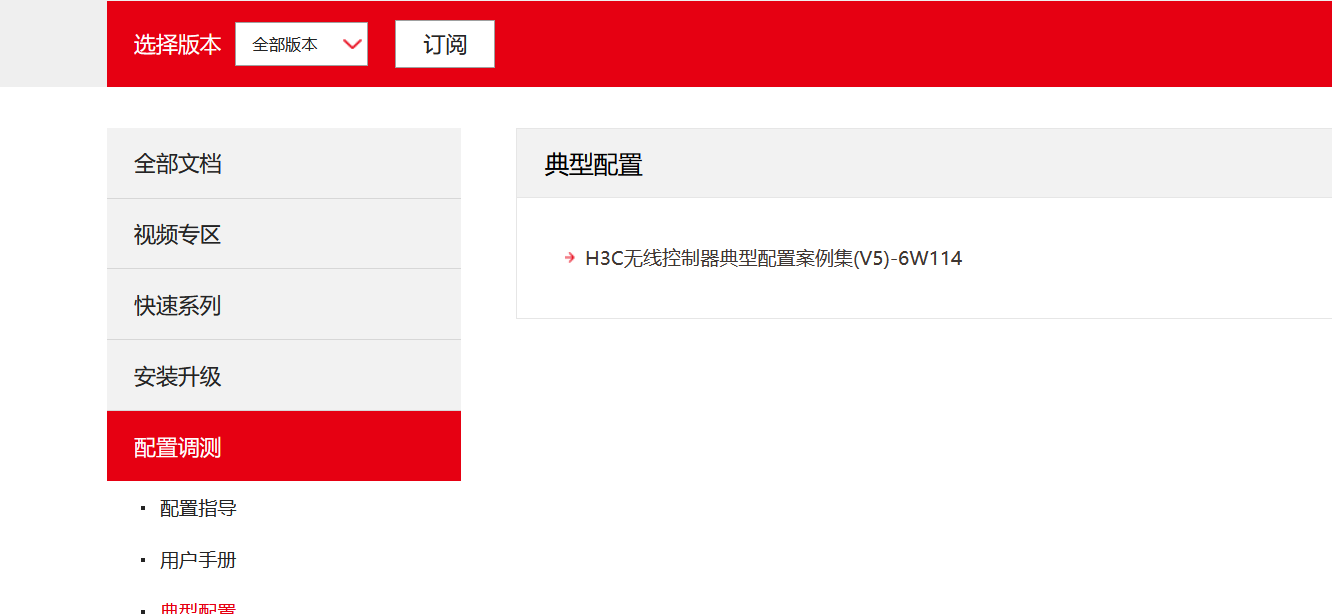

不知道密码就得重启ctrl+B去清除了
https://www.h3c.com/cn/d_202108/1453973_30005_40.htm
配置的话你看一下典型案例吧
https://www.h3c.com/cn/Service/Document_Software/Document_Center/Wlan/WX/H3C_WX3000/?category=93426&subcategory=93438

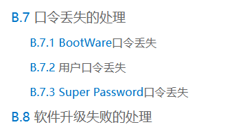

您好,可以清楚密码再设置,参考
进入bootroom菜单清除Console密码
通过console线和crt软件连接并登陆设备,然后把设备断电重启。控制台上会打印如下信息,当出现“press Ctrl+B”的时候快速按住“Ctrl+B” 进入botroom菜单
System is starting...
Press Ctrl+D to access BASIC-BOOTWARE MENU
Booting Normal Extend BootWare
The Extend BootWare is self-decompressing.......................Done!
BootWare Validating...
Press Ctrl+B to enter extended boot menu...
BotWare password: Not required. Please press Enter to continue.
Password recovery capability is enabled.
Note: The current operating device is flash
Enter < Storage Device Operation > to select device.
      按住“Ctrl+B”进入如下菜单。选择“<6> Skip Current System Configuration”跳过当前配置启动,不同设备可能不是数字6,
