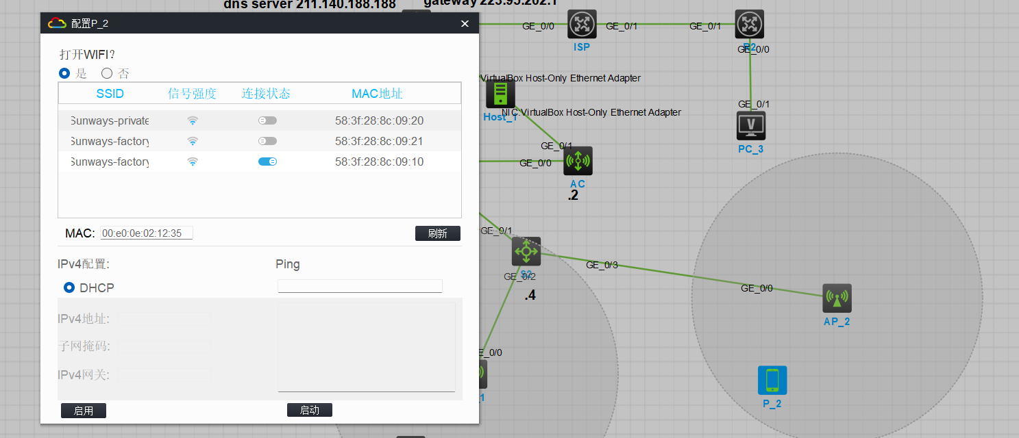

出现第三个无线信号,怎么删除

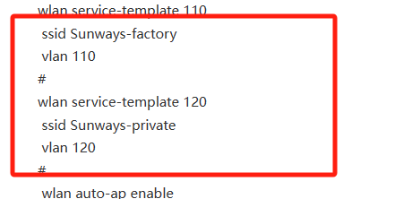

wlan service-template 110
 ssid Sunways-factory
 vlan 110
wlan service-template 120
 ssid Sunways-private
 vlan 120
 wlan auto-ap enable
 wlan auto-persistent enable
wlan ap-group default-group
 vlan 1
wlan virtual-ap-group default-virtualapgroup
wlan ap AP_1 model WA6320-HCL
 serial-id H3C_58-3F-22-F6-08-00
 radio 1
  radio enable
  service-template 110 vlan 110
 radio 2
  radio enable
  service-template 120 vlan 120
wlan ap AP_2 model WA6320-HCL
 serial-id H3C_58-3F-28-8C-09-00
 radio 1
  radio enable
 radio 2
  radio enable
wlan ap AP_3 model WA6320-HCL
 serial-id H3C_58-3F-33-9B-0A-00
 radio 1
  radio enable
 radio 2
  radio enable
关闭相应的无线服务模板就行
模拟器多少有点不稳定
zhiliao_sEUyB 发表时间:2024-04-16 更多>>
就2个,无线信号重复了一个,配置没重复啊,我删那个?
zhiliao_wXtwOj 发表时间:2024-04-16
重启一下ac吧
模拟器多少有点不稳定
您好,删除或者关闭对应的模板
