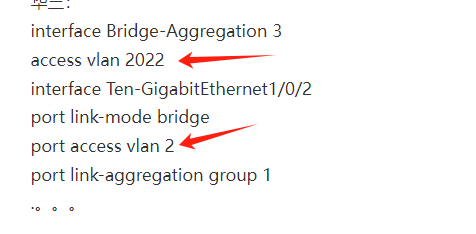

华三:
interface Bridge-Aggregation 3
access vlan 2022
interface Ten-GigabitEthernet1/0/2
port link-mode bridge
port access vlan 2
port link-aggregation group 1

你的聚合口和成员口vlan不一致
实际配置上是一样的
