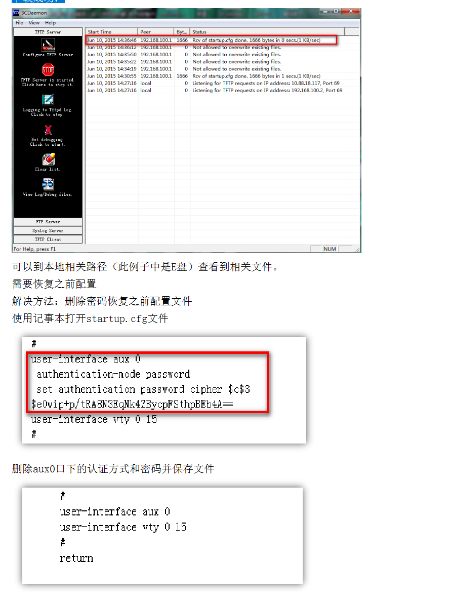

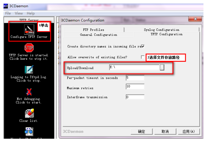

给设备和电脑配置成同网段IP地址(举例:WAC配置成192.168.100.1,电脑配置成192.168.100.2),在电脑上通过3CD软件搭建tftp服务器

<H3C>tftp 192.168.100.2 put startup.cfg
  File will be transferred in binary mode
  Sending file to remote TFTP server. Please wait... |
  TFTP:     1666 bytes sent in 0 second(s).
  File uploaded successfully.
<H3C>
下载成功:
覆盖当前配置文件
<H3C>tftp 192.168.100.20 get startup.cfg
The file startup.cfg exists. Overwrite it? [Y/N]:y
  Verifying server file...
  Deleting the old file, please wait...
  Downloading file from remote TFTP server, please wait....
  TFTP:     1166 bytes received in 0 second(s)
  File downloaded successfully.
