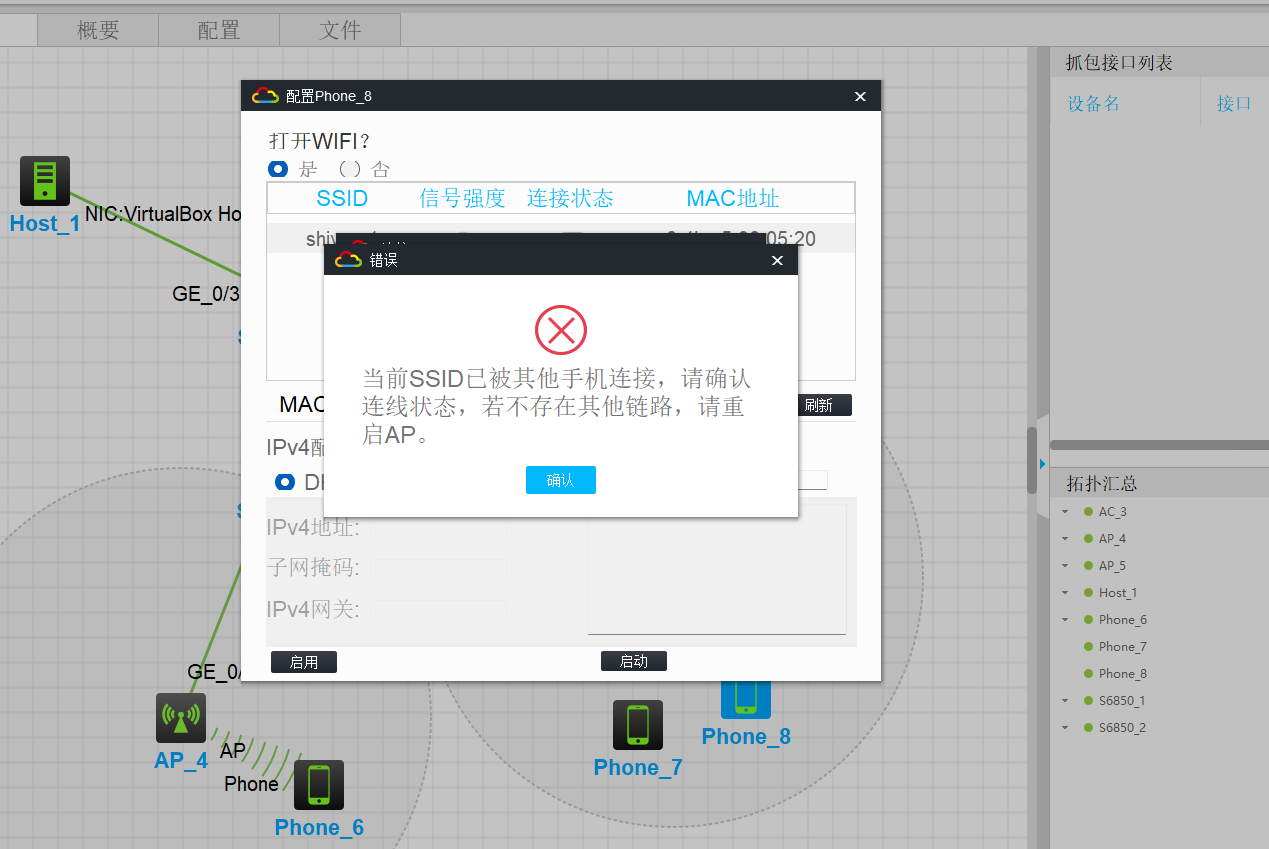

在华三模拟器中phone开启wiff时显示当前ssid已被其他手机连接
2024-04-28提问
  • 0收藏,1653浏览
粉丝:0人 关注:2人

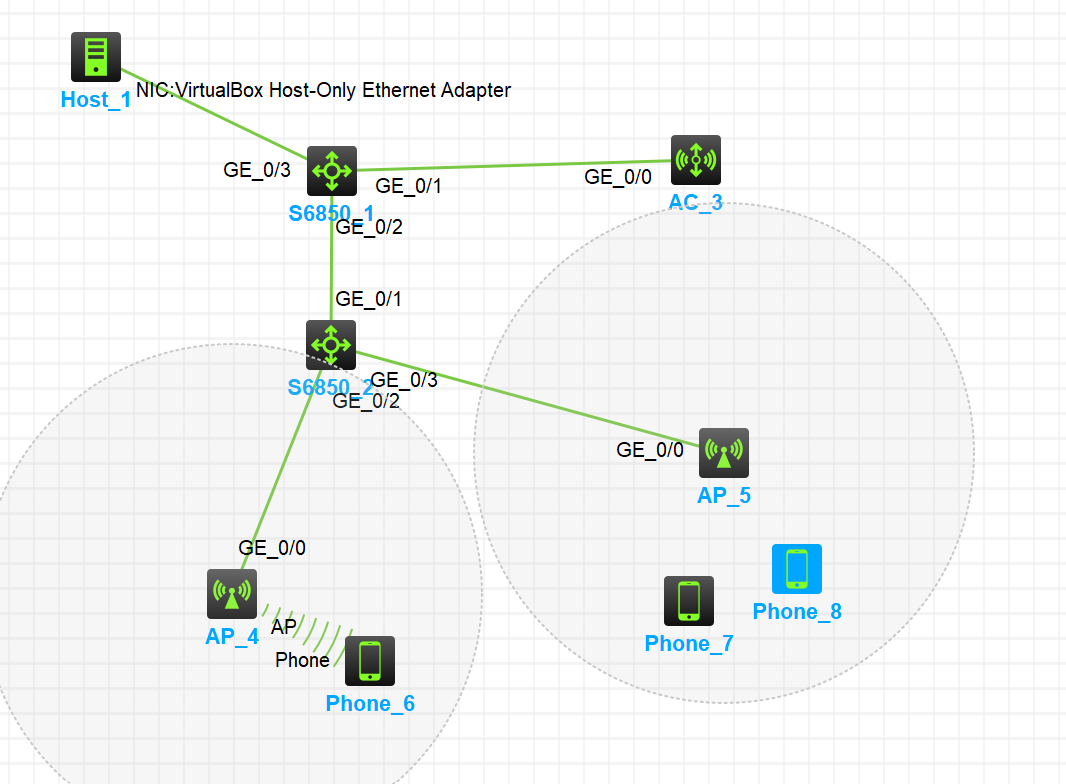

我这个ssid名没有在用,开启时显示ssid已被其他手机连接
具体配置如下
[ac]display  wlan service-template
Total number of service templates: 3
Service template name           SSID                                    Status
ceshi-1                         way                                     Enabled
wuxian-1                        ceshi-1                                 Enabled
wuxian-2                        shiyan-1                                Enabled
[ac]display  wlan ap all
Total number of APs: 3
Total number of connected APs: 2
Total number of connected manual APs: 2
Total number of connected auto APs: 0
Total number of connected common APs: 2
Total number of connected WTUs: 0
Total number of inside APs: 0
Maximum supported APs: 60000
Remaining APs: 59998
Total AP licenses: 60000
Local AP licenses: 60000
Server AP licenses: 0
Remaining Local AP licenses: 59998
Sync AP licenses: 0
                                 AP information
 State : I = Idle,      J  = Join,       JA = JoinAck,    IL = ImageLoad
         C = Config,    DC = DataCheck,  R  = Run,   M = Master,  B = Backup
AP name                        APID  State Model           Serial ID
way                            4     R/M   WA6320-HCL      H3C_A0-4B-C5-36-05-00
ceshi-1                        1     R/M   WA6320-HCL      H3C_9E-100-6B-94-04-0
                                                           0
shiyan-1                       3     I     WA6320-HCL      Not configured
[ac]wlan ap ceshi-1  model WA6320-HCL
[ac-wlan-ap-ceshi-1]dis th
 serial-id H3C_9E-100-6B-94-04-00
 vlan 1
 vlan 10
 radio 1
  channel 36
  radio enable
  service-template wuxian-1 vlan 10
 radio 2
 gigabitethernet 1
return
[ac-wlan-ap-ceshi-1]wlan ap way   model WA6320-HCL
[ac-wlan-ap-way]dis th
 serial-id H3C_A0-4B-C5-36-05-00
 led-mode normal
 vlan 1
 radio 1
  channel 44
  radio enable
  service-template ceshi-1 vlan 10
 radio 2
  channel 7
  radio enable
 gigabitethernet 1
return
[ac]wlan service-template  wuxian-1
[ac-wlan-st-wuxian-1]dis th
 ssid ceshi-1
 service-template enable
return
[ac]wlan service-template  ceshi-1
[ac-wlan-st-ceshi-1]dis th
 ssid way
return
重启下AP
神了,wiff可以打开了,他提示我开启dhcp失败,目前phone已经连接一台ap,另一台ap连不了
zhiliao_kysYnO 发表时间:2024-04-28 更多>>
