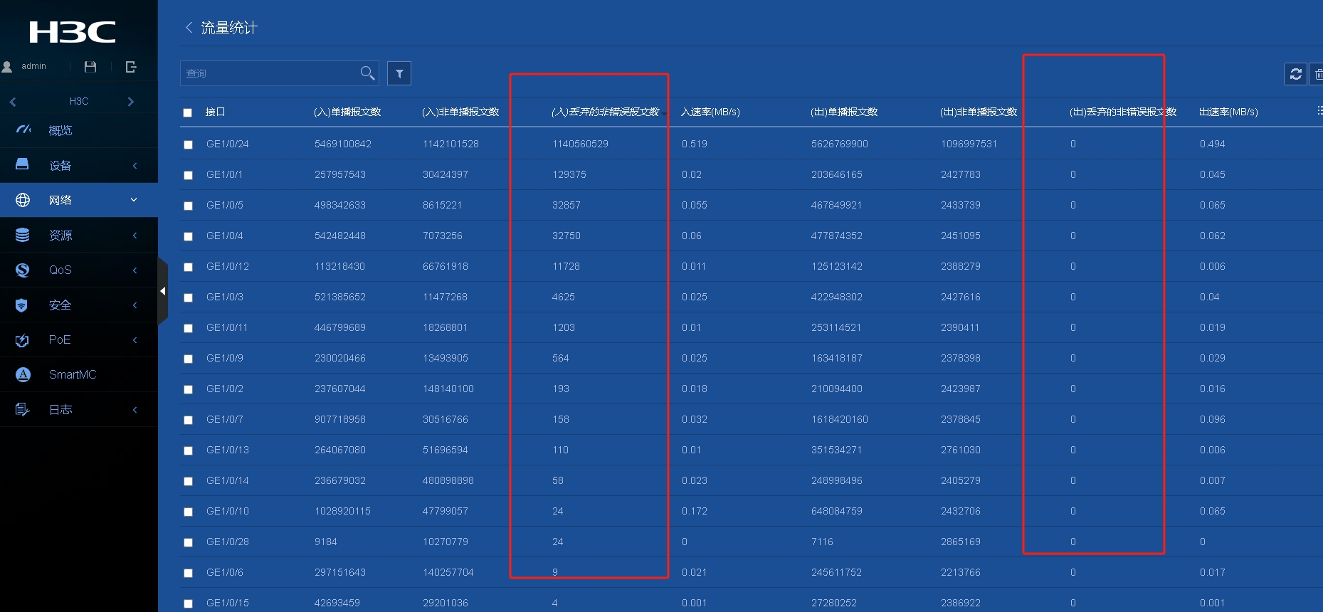

H3C 华三S5120v3s 交换机  (入)丢弃的非错误报文数  好多端口都出现,但是(出)丢弃的非错误报文数都为0,请问怎么解决。
1、检查下带宽利用率
2、看下有没有crc、error,如果有,那就是线路有问题
Last 300 seconds input: 76 packets/sec 20081 bytes/sec 0% Last 300 seconds output: 67 packets/sec 45960 bytes/sec 0%
zhiliao_7he0FT 发表时间:2024-05-20 更多>>
<H3C>display interface GigabitEthernet 1/0/1 GigabitEthernet1/0/1 Current state: UP Line protocol state: UP IP packet frame type: Ethernet II, hardware address: 642f-c73d-84fe Description: GigabitEthernet1/0/1 Interface Bandwidth: 1000000 kbps Loopback is not set Media type is optical fiber, Port hardware type is 1000_BASE_LX_SFP 1000Mbps-speed mode, full-duplex mode Link speed type is autonegotiation, link duplex type is autonegotiation Flow-control is not enabled Maximum frame length: 12288 Allow jumbo frames to pass Broadcast max-ratio: 100% Multicast max-ratio: 100% Unicast max-ratio: 100% Known-unicast max-ratio: 100% PVID: 11 MDI type: Automdix Port link-type: Access Tagged VLANs: None Untagged VLANs: 11 Port priority: 0 Last link flapping: 7 weeks 2 days 3 hours 8 minutes Last clearing of counters: Never Current system time:2024-05-20 14:10:59 Lisbon+00:00:00 Last time when physical state changed to up:2013-01-01 00:01:12 Lisbon+00:00:00 Last time when physical state changed to down:2013-01-01 00:00:26 Lisbon+00:00:00 Peak input rate: 9382271 bytes/sec, at 2013-02-07 06:39:11 Peak output rate: 11422809 bytes/sec, at 2013-02-17 03:36:46 Last 300 seconds input: 76 packets/sec 20081 bytes/sec 0% Last 300 seconds output: 67 packets/sec 45960 bytes/sec 0% Input (total): 288486961 packets, 153017053888 bytes 258052197 unicasts, 17461732 broadcasts, 12973032 multicasts, 0 pauses Input (normal): 288486961 packets, - bytes 258052197 unicasts, 17461732 broadcasts, 12973032 multicasts, 0 pauses Input: 0 input errors, 0 runts, 0 giants, 0 throttles 0 CRC, 0 frame, - overruns, 0 aborts - ignored, - parity errors Output (total): 206166190 packets, 116368889597 bytes 203737707 unicasts, 71762 broadcasts, 2356721 multicasts, 0 pauses Output (normal): 206166190 packets, - bytes 203737707 unicasts, 71762 broadcasts, 2356721 multicasts, 0 pauses Output: 0 output errors, - underruns, - buffer failures 0 aborts, 0 deferred, 0 collisions, 0 late collisions 0 lost carrier, - no carrier
zhiliao_7he0FT 知了小白
检查了,好像没有问题哦
KELEN 知了小白
我是打开stp后,你这种情况就多了起来,不开就没有。我也有点没搞清楚情况.
我的设备是s6800-54qt-h3,我本来是看到日志上有许多的端口频繁的up/down ,想打开stp改善一下。但结果up/donw频繁的问题依旧,然后“丢弃的非错误报文”多了起来~物理链路排查过都没有啥问题。
