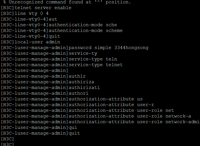

小贝路由器,MSG360 有console线,已经进去了,也能ping通,怎么看http是不是开启的,telnet已经开了,但是测试telnet端口不通 00

<H3C>sys System View: return to User View with Ctrl+Z. [H3C] [H3C]http server enable ^ % Unrecognized command found at '^' position. [H3C]telnet server enable [H3C]line vty 0 4 [H3C-line-vty0-4]aut [H3C-line-vty0-4]authentication-mode sche [H3C-line-vty0-4]authentication-mode scheme [H3C-line-vty0-4]quit [H3C]local-user admin [H3C-luser-manage-admin]password simple 3344hongsong [H3C-luser-manage-admin]service-ty [H3C-luser-manage-admin]service-type teln [H3C-luser-manage-admin]service-type telnet [H3C-luser-manage-admin] [H3C-luser-manage-admin]authir [H3C-luser-manage-admin]authiriza [H3C-luser-manage-admin]authirizati [H3C-luser-manage-admin]authori [H3C-luser-manage-admin]authorization-attribute us [H3C-luser-manage-admin]authorization-attribute user-r [H3C-luser-manage-admin]authorization-attribute user-role net [H3C-luser-manage-admin]authorization-attribute user-role network-a [H3C-luser-manage-admin]authorization-attribute user-role network-admin [H3C-luser-manage-admin]qui [H3C-luser-manage-admin]quit

配置没问题,ping0.100通吗

看着配置没啥问题。
