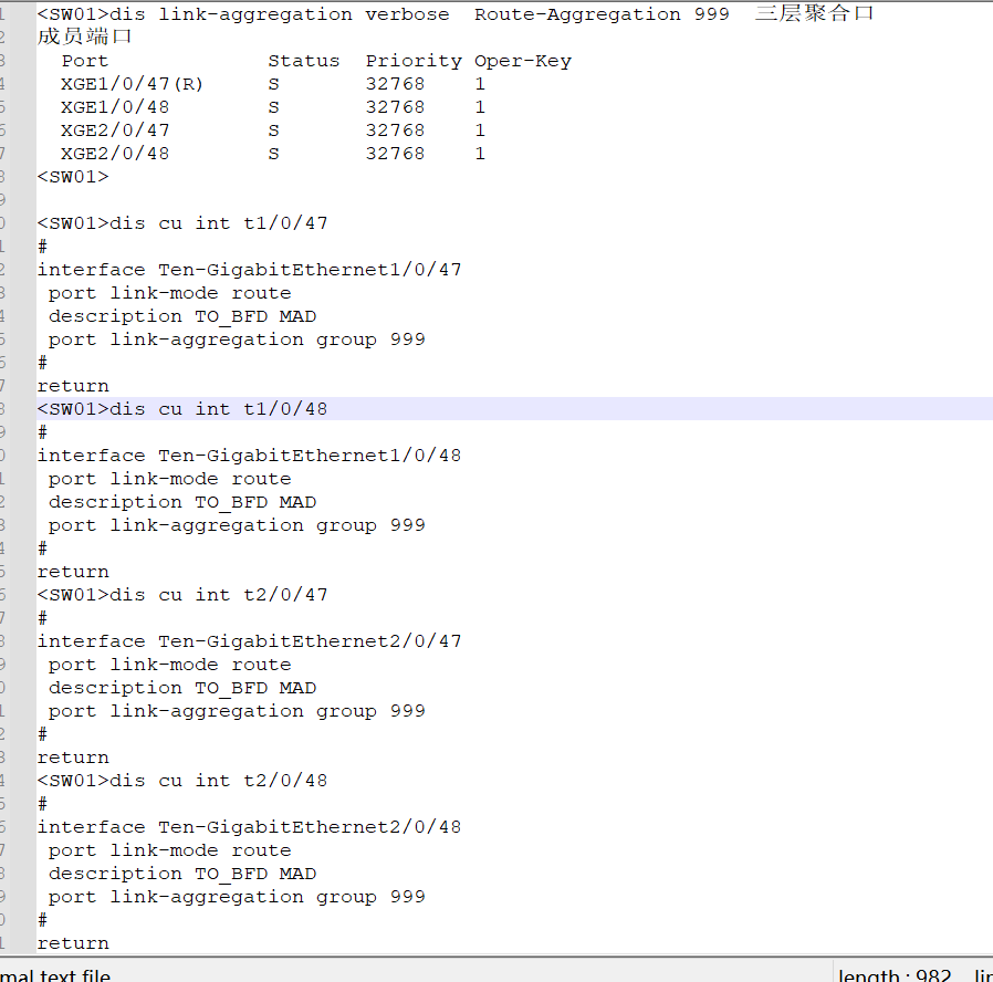

IRF组网三层聚合口 MAD BFD :Failed to enable MAD BFD.谁知道这个原因?
[SW01-Route-Aggregation999]mad bfd enable

看一下你mad 的物理接口上是怎么配置的?
可能是你的这个版本低。升级到新版本可能就支持三层聚合口了

<SW01>dis link-aggregation verbose Route-Aggregation 999 三层聚合口 成员端口 Port Status Priority Oper-Key XGE1/0/47(R) S 32768 1 XGE1/0/48 S 32768 1 XGE2/0/47 S 32768 1 XGE2/0/48 S 32768 1 <SW01> <SW01>dis cu int t1/0/47 # interface Ten-GigabitEthernet1/0/47 port link-mode route description TO_BFD MAD port link-aggregation group 999 # return <SW01>dis cu int t1/0/48 # interface Ten-GigabitEthernet1/0/48 port link-mode route description TO_BFD MAD port link-aggregation group 999 # return <SW01>dis cu int t2/0/47 # interface Ten-GigabitEthernet2/0/47 port link-mode route description TO_BFD MAD port link-aggregation group 999 # return <SW01>dis cu int t2/0/48 # interface Ten-GigabitEthernet2/0/48 port link-mode route description TO_BFD MAD port link-aggregation group 999 # return <SW01>

回复zhiliao_dz3Y6:
看你接口配置的没问题

做BFD MAD的接口关闭STP功能
