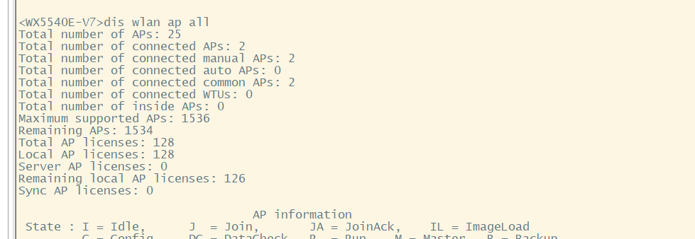

新增加12台无线AP,是否需要购买授权
粉丝:20人 关注:2人
看Remaining local AP licenses
dis wlan ap all可以看到
dis wlan ap all
# 显示所有AP的信息。
<Sysname> display wlan ap all
Total number of APs: 1
Total number of connected APs: 1
Total number of connected manual APs: 1
Total number of connected auto APs: 0
Total number of connected common APs: 1
Total number of connected WTUs: 0
Total number of inside APs: 0
Maximum supported APs: 2048
Remaining APs: 2047
Total AP licenses: 128
Local AP licenses: 128
Server AP licenses: 0
Remaining local AP licenses: 127
Sync AP licenses: 0
