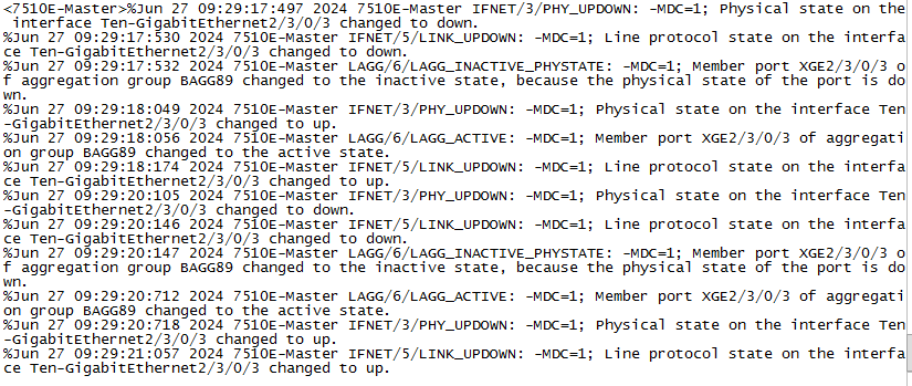

核心交换机:
 link-aggregation global load-sharing mode destination-ip source-ip
interface Bridge-Aggregation89
 description "2haolou"
 port link-type trunk
 undo port trunk permit vlan 1
 port trunk permit vlan 2 to 3999
 undo stp enable
interface Ten-GigabitEthernet1/3/0/3
 port link-mode bridge
 description ** 2#4F H3C 7503 10.250.31.243 **
 undo stp enable
 mirroring-group 2 mirroring-port both
 port link-aggregation group 89
interface Ten-GigabitEthernet2/3/0/3
 description ** 2#4F H3C 7503 2/0/48 **
 shutdown
 undo stp enable
 mirroring-group 4 mirroring-port both
2号楼交换机:
interface Bridge-Aggregation100
 description *WAN-S7510*
 port trunk permit vlan 2 to 4094
interface Ten-GigabitEthernet2/0/47
 port link-aggregation group 100
interface Ten-GigabitEthernet2/0/48
设备配置检查没有发现异常,确提示有环路。想知道怎么检查确认。或者其他方法决绝。
检查下线接的有没有问题,日志发上来看下

2号楼交换机配置了STP没有?

确认一下两端的聚合配置吧,建议配置动态聚合
