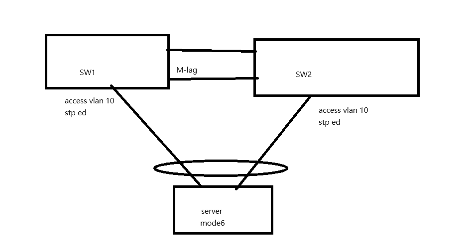

组网如图:
交换机提示ip冲突
日志:
%Aug 16 21:11:11:301 2021 I-JH-01 ARP/6/ARP_USER_DUPLICATE_IPADDR_DETECT: Detected a user IP address conflict. New user (MAC XX, SVLAN 1002, CVLAN --) on interface Bridge-Aggregation3 and old user (MAC XX, SVLAN 1002, CVLAN --) on interface Bridge-Aggregation3 were using the same IP address XXXX
意思是,聚合3上收到了相同的arp信息么,对下服务器不是网卡做的聚合吗,如果交换机上的跨设备聚合状态正常,建议还是检查下服务器网卡配置吧
交换机这边没做聚合,是两个access口,服务器是聚合mode6
