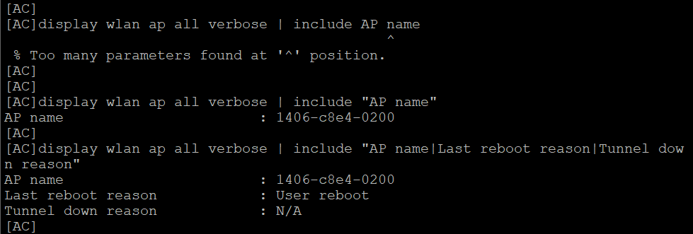

PS:
因为看到其它答案里有写错的,所以想说一下,如果想用include命令检索带空格的字段,需要添加双引号,否则会报错。
比如:
display wlan ap all verbose | include "AP name|Last reboot reason|Tunnel down reason"
