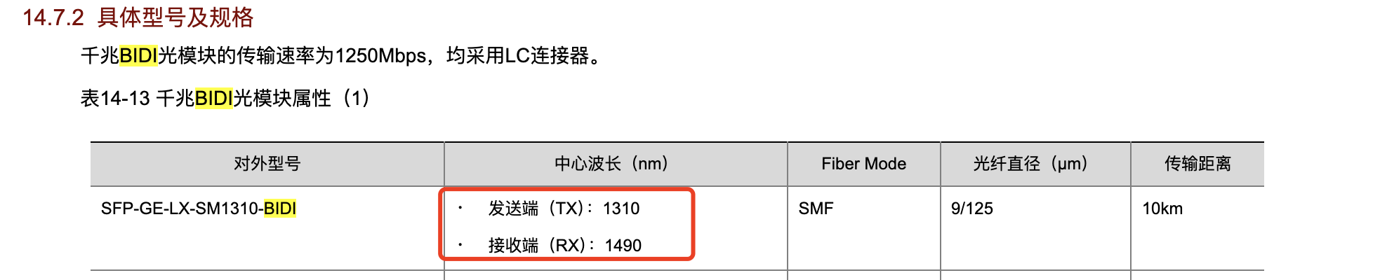

单模单芯,分为发送端和接收端,波长不同
https://www.h3c.com/cn/d_202406/2178187_30005_0.htm#_Toc169100186
