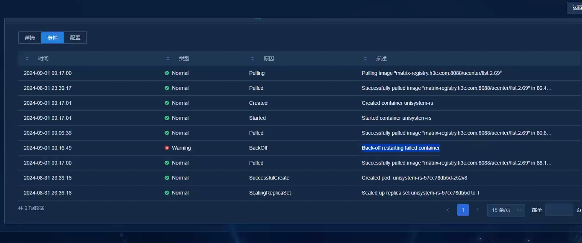

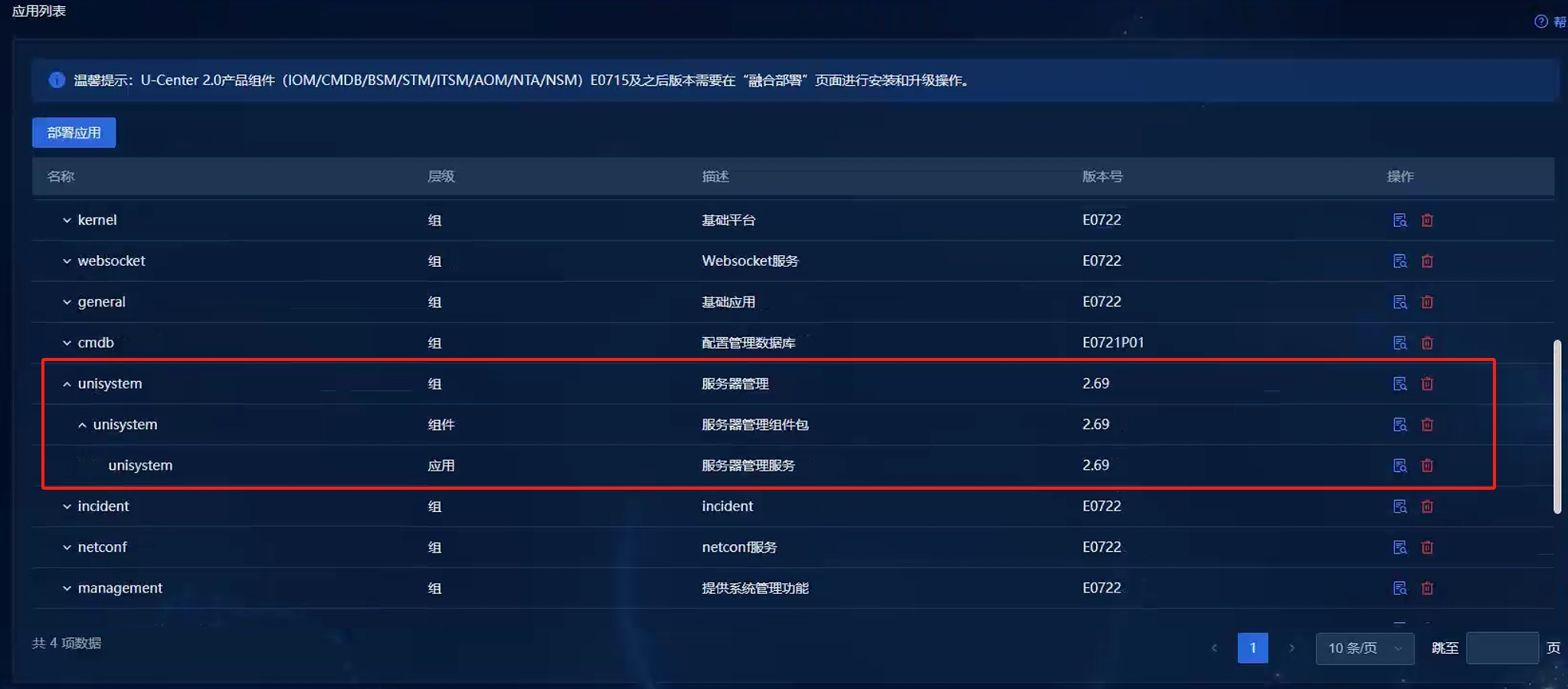

UniSystem2.69在U-Center2.0E0722安装后,添加服务器时,点击确定后,服务就自动重启,反复尝试多次均如此。

日志里报这个java崩溃财错误# # A fatal error has been detected by the Java Runtime Environment: # # SIGILL (0x4) at pc=0x00007ff6894234ce, pid=49, tid=0x00007ff68a0ee700 # # JRE version: OpenJDK Runtime Environment (8.0_232-b09) (build 1.8.0_232-b09) # Java VM: OpenJDK 64-Bit Server VM (25.232-b09 mixed mode linux-amd64 compressed oops) # Problematic frame: # C [libcryptopp.so+0x38d4ce] CryptoPP::Rijndael::Base::UncheckedSetKey(unsigned char const*, unsigned int, CryptoPP::NameValuePairs const&)+0x9e # # Core dump written. Default location: /UniSystem/core or core.49 # # An error report file with more information is saved as: # /UniSystem/hs_err_pid49.log # # If you would like to submit a bug report, please visit: # ***.***/bugreport/crash.jsp # The crash happened outside the Java Virtual Machine in native code. # See problematic frame for where to report the bug.

1.日志里有JAVA崩溃的日志
2.降级到2.64版本,仍然不行,

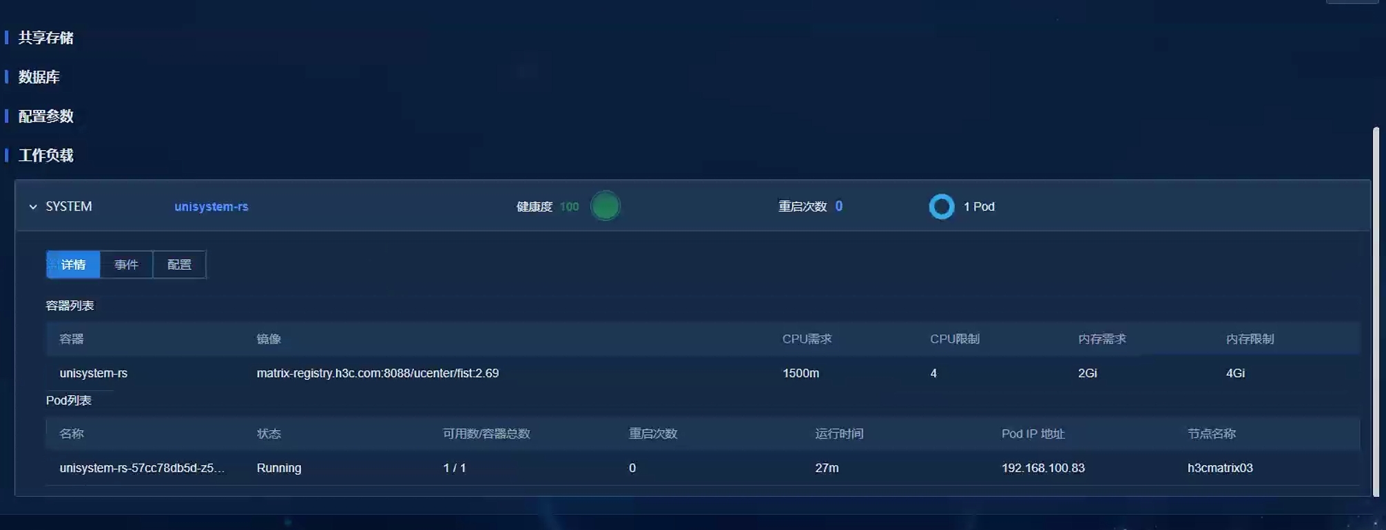

3.在matrix里看资源充足。
4. 都在一台服务器上。
5. 清除后仍然如此。
6. 重启服务后,添加仍然重启,
