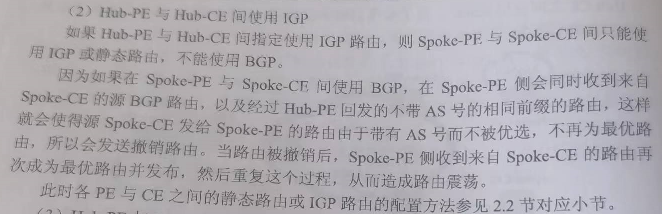

对spoke-pe和spoke-ce之间用bgp,spoke-pe会收到来自spoke-ce的源路由,以及经过hub-pe回发的不带AS号的相同前缀的路由,对此不理解,请大神解惑一下,谢谢!

建议看下手册和案例:
08-MPLS L3VPN配置-新华三集团-H3C
2.18.2  配置Hub&Spoke组网示例
1. 组网需求
·     Spoke-CE之间不能直接通信,只能通过Hub-CE转发Spoke-CE之间的流量。
·     Spoke-CE与Spoke-PE之间、Hub-CE与Hub-PE之间配置EBGP交换VPN路由信息。
·     Spoke-PE与Hub-PE之间配置OSPF实现PE内部的互通、配置MP-IBGP交换VPN路由信息。
2. 组网图
图2-4 Hub&Spoke组网图

(4)     在PE与CE之间建立EBGP对等体,引入VPN路由
# 配置Spoke-CE 1。
<Spoke-CE1> system-view
[Spoke-CE1] bgp 65410
[Spoke-CE1-bgp-default] peer 11::2 as-number 100
[Spoke-CE1-bgp-default] address-family ipv6
[Spoke-CE1-bgp-default-ipv6] peer 11::2 enable
[Spoke-CE1-bgp-default-ipv6] import-route direct
[Spoke-CE1-bgp-default-ipv6] quit
[Spoke-CE1-bgp-default] quit
# 配置Spoke-CE 2。
<Spoke-CE2> system-view
[Spoke-CE2] bgp 65420
[Spoke-CE2-bgp-default] peer 12::2 as-number 100
[Spoke-CE2-bgp-default] address-family ipv6
[Spoke-CE2-bgp-default-ipv6] peer 12::2 enable
[Spoke-CE2-bgp-default-ipv6] import-route direct
[Spoke-CE2-bgp-default-ipv6] quit
[Spoke-CE2-bgp-default] quit
# 配置Hub-CE。
<Hub-CE> system-view
[Hub-CE] bgp 65430
[Hub-CE-bgp-default] peer 13::2 as-number 100
[Hub-CE-bgp-default] peer 14::2 as-number 100
[Hub-CE-bgp-default] address-family ipv6
[Hub-CE-bgp-default-ipv6] peer 13::2 enable
[Hub-CE-bgp-default-ipv6] peer 14::2 enable
[Hub-CE-bgp-default-ipv6] import-route direct
[Hub-CE-bgp-default-ipv6] quit
[Hub-CE-bgp-default] quit
# 配置Spoke-PE 1。
[Spoke-PE1] bgp 100
[Spoke-PE1-bgp-default] ip vpn-instance vpn1
[Spoke-PE1-bgp-default-vpn1] peer 11::1 as-number 65410
[Spoke-PE1-bgp-default-vpn1] address-family ipv6
[Spoke-PE1-bgp-default-ipv6-vpn1] peer 11::1 enable
[Spoke-PE1-bgp-default-ipv6-vpn1] quit
[Spoke-PE1-bgp-default-vpn1] quit
[Spoke-PE1-bgp-default] quit
# 配置Spoke-PE 2。
[Spoke-PE2] bgp 100
[Spoke-PE2-bgp-default] ip vpn-instance vpn1
[Spoke-PE2-bgp-default-vpn1] peer 12::1 as-number 65420
[Spoke-PE2-bgp-default-vpn1] address-family ipv6
[Spoke-PE2-bgp-default-ipv6-vpn1] peer 12::1 enable
[Spoke-PE2-bgp-default-ipv6-vpn1] quit
[Spoke-PE2-bgp-default-vpn1] quit
[Spoke-PE2-bgp-default] quit
# 配置Hub-PE。
[Hub-PE] bgp 100
[Hub-PE-bgp-default] ip vpn-instance vpn1-in
[Hub-PE-bgp-default-vpn1-in] peer 13::1 as-number 65430
[Hub-PE-bgp-default-vpn1-in] address-family ipv6
[Hub-PE-bgp-default-ipv6-vpn1-in] peer 13::1 enable
[Hub-PE-bgp-default-ipv6-vpn1-in] quit
[Hub-PE-bgp-default-vpn1-in] quit
[Hub-PE-bgp-default] ip vpn-instance vpn1-out
[Hub-PE-bgp-default-vpn1-out] peer 14::1 as-number 65430
[Hub-PE-bgp-default-vpn1-out] address-family ipv6
[Hub-PE-bgp-default-ipv6-vpn1-out] peer 14::1 enable
[Hub-PE-bgp-default-ipv6-vpn1-out] peer 14::1 allow-as-loop 2
[Hub-PE-bgp-default-ipv6-vpn1-out] quit
[Hub-PE-bgp-default-vpn1-out] quit
[Hub-PE-bgp-default] quit
配置完成后,在PE设备上执行display bgp peer ipv6 vpn-instance命令,可以看到PE与CE之间的BGP对等体关系已建立,并达到Established状态。

# Spoke-CE 1和Spoke-CE 2之间可以ping通。从TTL值可以推算出Spoke-CE 1到Spoke-CE 2经过6跳(64-59+1),即Spoke-CE 1和Spoke-CE 2之间的流量需要通过Hub-CE转发。以Spoke-CE 1为例:
