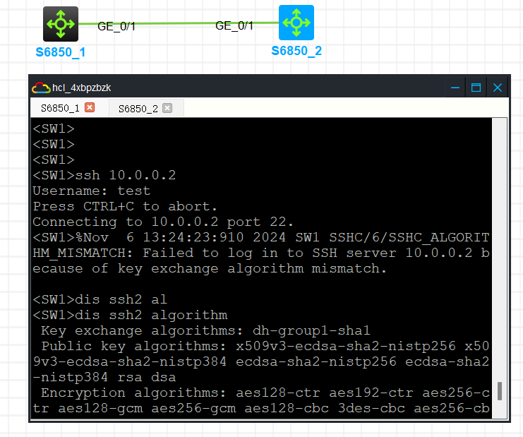

华为交换机ssh不上华三交换机:
%Jan  2 01:29:35:104 2011 cq-cloud-manage-EK&EM14 SSHS/6/SSHS_ALGORITHM_MISMATCH: SSH client 192.168.111.50 failed to log in because of key exchange algorithm mismatch.
%Jan  2 01:29:35:104 2011 cq-cloud-manage-EK&EM14 SSHS/6/SSHS_DISCONNECT: SSH user (null) (IP: 192.168.111.50) disconnected from the server.
粉丝:32人 关注:11人
这是因为两边交换机支持的密钥交换算法对不上,导致协商失败,所以会这样。
把两头的算法列表调一下就好了,H3C的调整命令是ssh2 algorithm key-exchange+算法列表,查看命令为display ssh2 algorithm。
