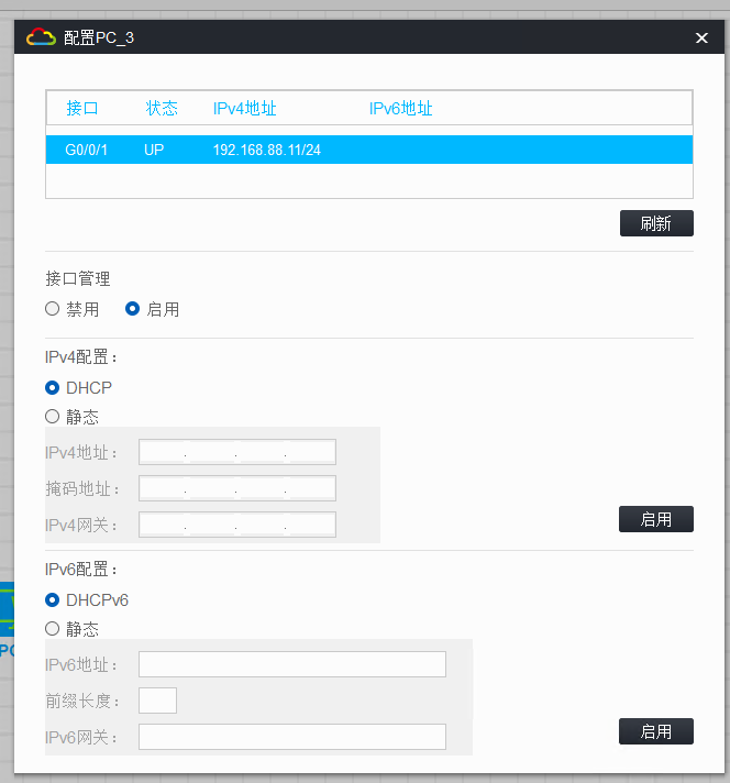

hcl pc获取不到IPV6的地址
2024-11-26提问
  • 0收藏,3351浏览
粉丝:23人 关注:0人
内存已经增加3G
 dhcp enable
dhcp server ip-pool 88
 gateway-list 192.168.88.1
 network 192.168.88.0 mask 255.255.255.0
 dns-list 61.139.2.69 223.5.5.5
 expired unlimited
ipv6 dhcp pool 88
 network FD01:204:488:488::/64 preferred-lifetime 21600 valid-lifetime 21600
 dns-server 240E:56:4000:8000::69
 dns-server 240E:56:4000::218
 gateway-list FD01:204:488:488::1
interface NULL0
interface Vlan-interface1
 ip address 192.168.66.2 255.255.255.0
 dhcp server apply ip-pool 66
 ipv6 address FD01:204:466:466::2/64
interface Vlan-interface88
 ip address 192.168.88.1 255.255.255.0
 dhcp server apply ip-pool 88
 ipv6 dhcp server apply pool 88
 ipv6 address FD01:204:488:488::1/64
 ipv6 nd autoconfig managed-address-flag
 ipv6 nd autoconfig other-flag
 undo ipv6 nd ra halt
 ipv6 nd ra interval 60 10
 port link-mode bridge
 port access vlan 88
 combo enable fiber
ip route-static 0.0.0.0 0 192.168.66.1
 ipv6 route-static :: 0 FD01:204:466:466::1

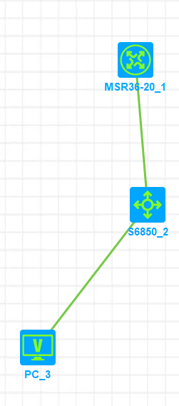

模拟器支持IPV6
 调整到内存512M以上就行 ,检查下配置吧,
组网说明:
本案例采用H3C HCL模拟器来模拟IPV6 DHCPv6典型组网配置。要求PC能够通过DHCP的方式获取到IPV6地址。

少了一句ipv6 dhcp select server
