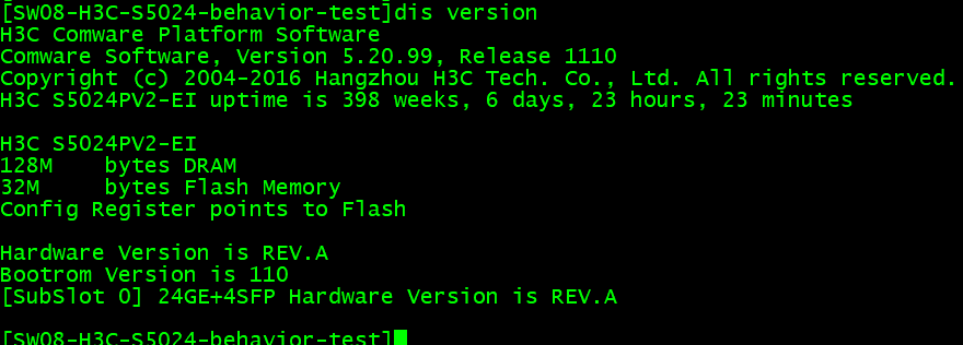

没有accounting命令,版本是H3C Comware Platform Software Comware Software, Version 5.20.99, Release 1110 Copyright (c) 2004-2016 Hangzhou H3C Tech. Co., Ltd. All rights reserved. H3C S5024PV2-EI uptime is 398 weeks, 6 days, 23 hours, 25 minutes H3C S5024PV2-EI 128M bytes DRAM 32M bytes Flash Memory Config Register points to Flash Hardware Version is REV.A Bootrom Version is 110 [SubSlot 0] 24GE+4SFP Hardware Version is REV.A
zhiliao_CTDp89 发表时间:2024-12-19
那就不用输入 直接统计

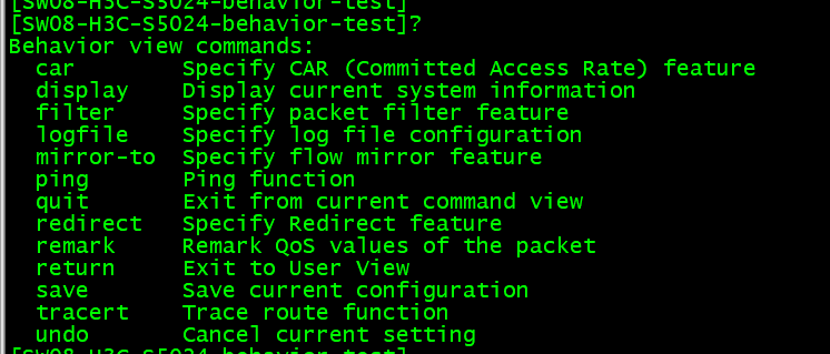

不输入,直接统计,就是我上面的截图,failed
回复zhiliao_sEUyB:
[SW08-H3C-S5024-behavior-test]dis current-configuration configuration acl-adv # acl number 3000 rule 10 permit icmp #
您好,可以实现
怎么实现,设备升级?Comware Software, Version 5.20.99, Release 1110
zhiliao_CTDp89 发表时间:2024-12-19 更多>>
zhiliao_CTDp89 知了小白
粉丝:0人 关注:9人
没有 accounting这个命令,所以我才在知了问的,
