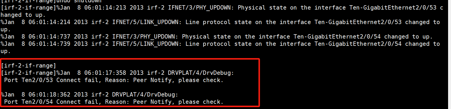

说是端口连接失败,但是端口状态都是是正常的
SW1
irf member 1 renumber 1
y
irf member 1 priority 32
interface range Ten-GigabitEthernet 1/0/53 to Ten-GigabitEthernet 1/0/54
shutdown
irf-port 1/2
port  group interface Ten-GigabitEthernet 1/0/53
port  group interface Ten-GigabitEthernet 1/0/54
undo shutdown
irf-port-configuration active
save
SW2
irf member 1 renumber 2
y
save force
reboot
(等待重启完成)
interface range Ten-GigabitEthernet 2/0/53 to Ten-GigabitEthernet 2/0/54
shutdown
irf-port 2/2
port  group interface Ten-GigabitEthernet 2/0/53
port  group interface Ten-GigabitEthernet 2/0/54
undo shutdown
save
脚本如上

irf-port 重复了
修改一台的配置吧
您好,端口重复了,修改其中的一台即可
