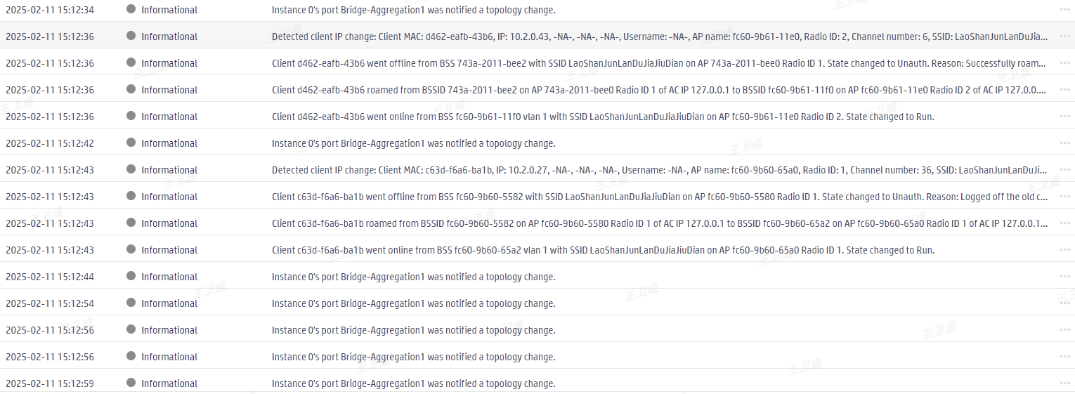

AC日志是什么原因导致的 ,这些是什么问题影响使用吗

这个是正常客户端上下线及漫游产生d日志
用户数多就会这样

Instance 0's port Bridge-Aggregation1 was notified a topology change. 2025-02-11 15:59:11 报告 Detected client IP change: Client MAC: 4226-6be2-8235, IP: 10.2.3.133, -NA-, -NA-, -NA-, Username: -NA-, AP name: fc60-9b60-a9a0, Radio ID: 1, Channel number: 149, SSID: LaoShanJunLanDuJiaJiuDian, BSSID: fc60-9b60-a9a2. 2025-02-11 15:59:08 报告 Client 4226-6be2-8235 went offline from BSS fc60-9b60-ec42 with SSID LaoShanJunLanDuJiaJiuDian on AP fc60-9b60-ec40 Radio ID 1. State changed to Unauth. Reason: Logged off the old client because intra-AC roam-out succeeded after sending BTM message.(Count: 3) 2025-02-11 15:59:08 报告 Client 4226-6be2-8235 roamed from BSSID fc60-9b60-ec42 on AP fc60-9b60-ec40 Radio ID 1 of AC IP 127.0.0.1 to BSSID fc60-9b60-a9a2 on AP fc60-9b60-a9a0 Radio ID 1 of AC IP 127.0.0.1 successfully. 2025-02-11 15:59:08 报告 Client 4226-6be2-8235 went online from BSS fc60-9b60-a9a2 vlan 1 with SSID LaoShanJunLanDuJiaJiuDian on AP fc60-9b60-a9a0 Radio ID 1. State changed to Run. 2025-02-11 15:59:08 报告 Instance 0's port Bridge-Aggregation1 was notified a topology change. 2025-02-11 15:59:08 报告 Detected client IP change: Client MAC: c63d-f6a6-ba1b, IP: 10.2.0.27, -NA-, -NA-, -NA-, Username: -NA-, AP name: fc60-9b61-1aa0, Radio ID: 1, Channel number: 60, SSID: LaoShanJunLanDuJiaJiuDian, BSSID: fc60-9b61-1aa2. 2025-02-11 15:59:03 报告 Client c63d-f6a6-ba1b went offline from BSS fc60-9b61-1ab0 with SSID LaoShanJunLanDuJiaJiuDian on AP fc60-9b61-1aa0 Radio ID 2. State changed to Unauth. Reason: Logged off the old client because intra-AC roam-out succeeded after sending BTM message.(Count: 1) 2025-02-11 15:59:03 报告 Client c63d-f6a6-ba1b roamed from BSSID fc60-9b61-1ab0 on AP fc60-9b61-1aa0 Radio ID 2 of AC IP 127.0.0.1 to BSSID fc60-9b61-1aa2 on AP fc60-9b61-1aa0 Radio ID 1 of AC IP 127.0.0.1 successfully. 2025-02-11 15:59:03 报告 Client c63d-f6a6-ba1b went online from BSS fc60-9b61-1aa2 vlan 1 with SSID LaoShanJunLanDuJiaJiuDian on AP fc60-9b61-1aa0 Radio ID 1. State changed to Run. 2025-02-11 15:59:03 报告 Instance 0's port Bridge-Aggregation1 was notified a topology change. 2025-02-11 15:59:00 报告 Detected client IP change: Client MAC: 12d0-b9f7-b3df, IP: 10.2.4.39, -NA-, -NA-, -NA-, Username: -NA-, AP name: fc60-9b60-cb60, Radio ID: 2, Channel number: 11, SSID: JunLanBanGong, BSSID: fc60-9b60-cb72. 2025-02-11 15:58:59 报告 Client 12d0-b9f7-b3df went offline from BSS fc60-9b61-4172 with SSID JunLanBanGong on AP fc60-9b61-4160 Radio ID 2. State changed to Unauth. Reason: Successfully roamed to another BSS and deleted old client entry. 2025-02-11 15:58:59 报告 Client 12d0-b9f7-b3df roamed from BSSID fc60-9b61-4172 on AP fc60-9b61-4160 Radio ID 2 of AC IP 127.0.0.1 to BSSID fc60-9b60-cb72 on AP fc60-9b60-cb60 Radio ID 2 of AC IP 127.0.0.1 successfully. 2025-02-11 15:58:59 报告 Client 12d0-b9f7-b3df went online from BSS fc60-9b60-cb72 vlan 20 with SSID JunLanBanGong on AP fc60-9b60-cb60 Radio ID 2. State changed to Run. 2025-02-11 15:58:59 报告 Instance 0's port Bridge-Aggregation1 was notified a topology change. 2025-02-11 15:58:57 报告 Client 86b0-9a60-65f3 went offline from BSS 743a-2011-bef0 with SSID LaoShanJunLanDuJiaJiuDian on AP 743a-2011-bee0 Radio ID 2. State changed to Unauth. Reason: Logged off the old client because intra-AC roam-out succeeded after sending BTM message.(Count: 15) 2025-02-11 15:58:56 报告 Detected client IP change: Client MAC: 86b0-9a60-65f3, IP: 10.2.0.24, -NA-, -NA-, -NA-, Username: -NA-, AP name: fc60-9b60-fc80, Radio ID: 2, Channel number: 1, SSID: LaoShanJunLanDuJiaJiuDian, BSSID: fc60-9b60-fc90. 2025-02-11 15:58:56 报告 Client 86b0-9a60-65f3 roamed from BSSID 743a-2011-bef0 on AP 743a-2011-bee0 Radio ID 2 of AC IP 127.0.0.1 to BSSID fc60-9b60-fc90 on AP fc60-9b60-fc80 Radio ID 2 of AC IP 127.0.0.1 successfully. 2025-02-11 15:58:56 报告 Client 86b0-9a60-65f3 went online from BSS fc60-9b60-fc90 vlan 1 with SSID LaoShanJunLanDuJiaJiuDian on AP fc60-9b60-fc80 Radio ID 2. State changed to Run. 2025-02-11 15:58:56 报告 Client 0a9a-6841-6571 went offline from BSS fc60-9b61-1ac0 with SSID JunLanBanGong on AP fc60-9b61-1ac0 Radio ID 1. State changed to Unauth. Reason: Client sends disassociation frame to go offline in run state: reason code=8. 2025-02-11 15:58:51 报告 Instance 0's port Bridge-Aggregation1 was notified a topology change. 2025-02-11 15:58:50 报告 Client 9652-b528-6838 went offline from BSS fc60-9b61-03e2 with SSID LaoShanJunLanDuJiaJiuDian on AP fc60-9b61-03e0 Radio ID 1. State changed to Unauth. Reason: Successfully roamed to another BSS and deleted old client entry. 2025-02-11 15:58:48 报告 Client 9652-b528-6838 roamed from BSSID fc60-9b61-03e2 on AP fc60-9b61-03e0 Radio ID 1 of AC IP 127.0.0.1 to BSSID fc60-9b60-ec42 on AP fc60-9b60-ec40 Radio ID 1 of AC IP 127.0.0.1 successfully. 2025-02-11 15:58:48 报告 Client 9652-b528-6838 went online from BSS fc60-9b60-ec42 vlan 1 with SSID LaoShanJunLanDuJiaJiuDian on AP fc60-9b60-ec40 Radio ID 1. State changed to Run. 2025-02-11 15:58:48 报告 Detected client IP change: Client MAC: 9652-b528-6838, IP: 10.2.3.137, -NA-, -NA-, -NA-, Username: -NA-, AP name: fc60-9b60-ec40, Radio ID: 1, Channel number: 157, SSID: LaoShanJunLanDuJiaJiuDian, BSSID: fc60-9b60-ec42. 2025-02-11 15:58:48 报告 Instance 0's port Bridge-Aggregation1 was notified a topology change. 2025-02-11 15:58:48 报告 Detected client IP change: Client MAC: 9652-b528-6838, IP: 10.2.3.137, -NA-, -NA-, -NA-, Username: -NA-, AP name: fc60-9b61-03e0, Radio ID: 1, Channel number: 44, SSID: LaoShanJunLanDuJiaJiuDian, BSSID: fc60-9b61-03e2. 2025-02-11 15:58:47 报告 Client 9652-b528-6838 went offline from BSS fc60-9b61-1ad0 with SSID LaoShanJunLanDuJiaJiuDian on AP fc60-9b61-1ac0 Radio ID 2. State changed to Unauth. Reason: Successfully roamed to another BSS and deleted old client entry. 2025-02-11 15:58:47 报告 Client 9652-b528-6838 roamed from BSSID fc60-9b61-1ad0 on AP fc60-9b61-1ac0 Radio ID 2 of AC IP 127.0.0.1 to BSSID fc60-9b61-03e2 on AP fc60-9b61-03e0 Radio ID 1 of AC IP 127.0.0.1 successfully. 2025-02-11 15:58:47 报告 Client 9652-b528-6838 went online from BSS fc60-9b61-03e2 vlan 1 with SSID LaoShanJunLanDuJiaJiuDian on AP fc60-9b61-03e0 Radio ID 1. State changed to Run. 2025-02-11 15:58:47 报告 Detected client IP change: Client MAC: 426c-60e0-fa65, IP: 10.2.4.34, -NA-, -NA-, -NA-, Username: -NA-, AP name: fc60-9b60-ec40, Radio ID: 1, Channel number: 157, SSID: JunLanBanGong, BSSID: fc60-9b60-ec40. 2025-02-11 15:58:46 报告 Client 426c-60e0-fa65 went offline from BSS fc60-9b61-1ac0 with SSID JunLanBanGong on AP fc60-9b61-1ac0 Radio ID 1. State changed to Unauth. Reason: Successfully roamed to another BSS and deleted old client entry. 2025-02-11 15:58:46 报告 Client 426c-60e0-fa65 roamed from BSSID fc60-9b61-1ac0 on AP fc60-9b61-1ac0 Radio ID 1 of AC IP 127.0.0.1 to BSSID fc60-9b60-ec40 on AP fc60-9b60-ec40 Radio ID 1 of AC IP 127.0.0.1 successfully. 2025-02-11 15:58:46 报告 Client 426c-60e0-fa65 went online from BSS fc60-9b60-ec40 vlan 20 with SSID JunLanBanGong on AP fc60-9b60-ec40 Radio ID 1. State changed to Run. 2025-02-11 15:58:46 报告 Detected client IP change: Client MAC: b22f-9229-517a, IP: 10.2.0.47, -NA-, -NA-, -NA-, Username: -NA-, AP name: 743a-2012-41a0, Radio ID: 1, Channel number: 157, SSID: LaoShanJunLanDuJiaJiuDian, BSSID: 743a-2012-41a2. 2025-02-11 15:58:46 报告 Client b22f-9229-517a went offline from BSS fc60-9b60-cb70 with SSID LaoShanJunLanDuJiaJiuDian on AP fc60-9b60-cb60 Radio ID 2. State changed to Unauth. Reason: Logged off the old client because intra-AC roam-out succeeded after sending BTM message.(Count: 1) 2025-02-11 15:58:46 报告 Client b22f-9229-517a roamed from BSSID fc60-9b60-cb70 on AP fc60-9b60-cb60 Radio ID 2 of AC IP 127.0.0.1 to BSSID 743a-2012-41a2 on AP 743a-2012-41a0 Radio ID 1 of AC IP 127.0.0.1 successfully. 2025-02-11 15:58:46 报告 Client b22f-9229-517a went online from BSS 743a-2012-41a2 vlan 1 with SSID LaoShanJunLanDuJiaJiuDian on AP 743a-2012-41a0 Radio ID 1. State changed to Run. 2025-02-11 15:58:46 报告 Detected client IP change: Client MAC: 9652-b528-6838, IP: 10.2.3.137, -NA-, -NA-, -NA-, Username: -NA-, AP name: fc60-9b61-1ac0, Radio ID: 2, Channel number: 6, SSID: LaoShanJunLanDuJiaJiuDian, BSSID: fc60-9b61-1ad0. 2025-02-11 15:58:44 报告 Client 9652-b528-6838 went offline from BSS fc60-9b61-1ac2 with SSID LaoShanJunLanDuJiaJiuDian on AP fc60-9b61-1ac0 Radio ID 1. State changed to Unauth. Reason: Logged off the old client because intra-AC roam-out succeeded after sending BTM message.(Count: 2) 2025-02-11 15:58:44 报告 Client 9652-b528-6838 roamed from BSSID fc60-9b61-1ac2 on AP fc60-9b61-1ac0 Radio ID 1 of AC IP 127.0.0.1 to BSSID fc60-9b61-1ad0 on AP fc60-9b61-1ac0 Radio ID 2 of AC IP 127.0.0.1 successfully. 2025-02-11 15:58:44 报告 Client 9652-b528-6838 went online from BSS fc60-9b61-1ad0 vlan 1 with SSID LaoShanJunLanDuJiaJiuDian on AP fc60-9b61-1ac0 Radio ID 2. State changed to Run. 2025-02-11 15:58:44 报告 Instance 0's port Bridge-Aggregation1 was notified a topology change. 2025-02-11 15:58:44 报告 Detected client IP change: Client MAC: 4226-6be2-8235, IP: 10.2.3.133, -NA-, -NA-, -NA-, Username: -NA-, AP name: fc60-9b60-ec40, Radio ID: 1, Channel number: 157, SSID: LaoShanJunLanDuJiaJiuDian, BSSID: fc60-9b60-ec42. 2025-02-11 15:58:42 报告 Client 4226-6be2-8235 went offline from BSS fc60-9b61-1ac2 with SSID LaoShanJunLanDuJiaJiuDian on AP fc60-9b61-1ac0 Radio ID 1. State changed to Unauth. Reason: Successfully roamed to another BSS and deleted old client entry. 2025-02-11 15:58:42 报告 Client 4226-6be2-8235 roamed from BSSID fc60-9b61-1ac2 on AP fc60-9b61-1ac0 Radio ID 1 of AC IP 127.0.0.1 to BSSID fc60-9b60-ec42 on AP fc60-9b60-ec40 Radio ID 1 of AC IP 127.0.0.1 successfully. 2025-02-11 15:58:42 报告 Client 4226-6be2-8235 went online from BSS fc60-9b60-ec42 vlan 1 with SSID LaoShanJunLanDuJiaJiuDian on AP fc60-9b60-ec40 Radio ID 1. State changed to Run. 2025-02-11 15:58:42 报告 Instance 0's port Bridge-Aggregation1 was notified a topology change. 2025-02-11 15:58:41 报告 Detected client IP change: Client MAC: 12d0-b9f7-b3df, IP: 10.2.4.39, -NA-, -NA-, -NA-, Username: -NA-, AP name: fc60-9b61-4160, Radio ID: 2, Channel number: 1, SSID: JunLanBanGong, BSSID: fc60-9b61-4172. 2025-02-11 15:58:29 报告 Client 12d0-b9f7-b3df went offline from BSS fc60-9b60-6cb2 with SSID JunLanBanGong on AP fc60-9b60-6ca0 Radio ID 2. State changed to Unauth. Reason: Successfully roamed to another BSS and deleted old client entry. 2025-02-11 15:58:29 报告 Client 12d0-b9f7-b3df roamed from BSSID fc60-9b60-6cb2 on AP fc60-9b60-6ca0 Radio ID 2 of AC IP 127.0.0.1 to BSSID fc60-9b61-4172 on AP fc60-9b61-4160 Radio ID 2 of AC IP 127.0.0.1 successfully. 2025-02-11 15:58:29 报告 Client 12d0-b9f7-b3df went online from BSS fc60-9b61-4172 vlan 20 with SSID JunLanBanGong on AP fc60-9b61-4160 Radio ID 2. State changed to Run. 2025-02-11 15:58:29 报告 Detected client IP change: Client MAC: 4226-6be2-8235, IP: 10.2.3.133, -NA-, -NA-, -NA-, Username: -NA-, AP name: fc60-9b61-1ac0, Radio ID: 1, Channel number: 149, SSID: LaoShanJunLanDuJiaJiuDian, BSSID: fc60-9b61-1ac2. 2025-02-11 15:58:23 报告 Client 4226-6be2-8235 went offline from BSS fc60-9b60-5590 with SSID LaoShanJunLanDuJiaJiuDian on AP fc60-9b60-5580 Radio ID 2. State changed to Unauth. Reason: Logged off the old client because intra-AC roam-out succeeded after sending BTM message.(Count: 9) 2025-02-11 15:58:23 报告 Client 4226-6be2-8235 roamed from BSSID fc60-9b60-5590 on AP fc60-9b60-5580 Radio ID 2 of AC IP 127.0.0.1 to BSSID fc60-9b61-1ac2 on AP fc60-9b61-1ac0 Radio ID 1 of AC IP 127.0.0.1 successfully. 2025-02-11 15:58:23 报告 Client 4226-6be2-8235 went online from BSS fc60-9b61-1ac2 vlan 1 with SSID LaoShanJunLanDuJiaJiuDian on AP fc60-9b61-1ac0 Radio ID 1. State changed to Run. 2025-02-11 15:58:23 报告 Detected client IP change: Client MAC: 12d0-b9f7-b3df, IP: 10.2.4.39, -NA-, -NA-, -NA-, Username: -NA-, AP name: fc60-9b60-6ca0, Radio ID: 2, Channel number: 11, SSID: JunLanBanGong, BSSID: fc60-9b60-6cb2. 2025-02-11 15:58:22 报告 Client 12d0-b9f7-b3df went offline from BSS 3080-9b46-ce72 with SSID JunLanBanGong on AP 3080-9b46-ce60 Radio ID 2. State changed to Unauth. Reason: Successfully roamed to another BSS and deleted old client entry. 2025-02-11 15:58:22 报告 Client 12d0-b9f7-b3df roamed from BSSID 3080-9b46-ce72 on AP 3080-9b46-ce60 Radio ID 2 of AC IP 127.0.0.1 to BSSID fc60-9b60-6cb2 on AP fc60-9b60-6ca0 Radio ID 2 of AC IP 127.0.0.1 successfully. 2025-02-11 15:58:22 报告 Client 12d0-b9f7-b3df went online from BSS fc60-9b60-6cb2 vlan 20 with SSID JunLanBanGong on AP fc60-9b60-6ca0 Radio ID 2. State changed to Run. 2025-02-11 15:58:22 报告 Detected client IP change: Client MAC: b22f-9229-517a, IP: 10.2.0.47, -NA-, -NA-, -NA-, Username: -NA-, AP name: fc60-9b60-cb60, Radio ID: 2, Channel number: 11, SSID: LaoShanJunLanDuJiaJiuDian, BSSID: fc60-9b60-cb70. 2025-02-11 15:58:21 报告 Client b22f-9229-517a went online from BSS fc60-9b60-cb70 vlan 1 with SSID LaoShanJunLanDuJiaJiuDian on AP fc60-9b60-cb60 Radio ID 2. State changed to Run. 2025-02-11 15:58:21 报告 Instance 0's port Bridge-Aggregation1 was notified a topology change. 2025-02-11 15:58:14 报告 Client 7608-5a65-e84c went offline from BSS 743a-2012-41a2 with SSID LaoShanJunLanDuJiaJiuDian on AP 743a-2012-41a0 Radio ID 1. State changed to Unauth. Reason: Successfully roamed to another BSS and deleted old client entry. 2025-02-11 15:58:12 报告 Detected client IP change: Client MAC: 7608-5a65-e84c, IP: 10.2.0.133, -NA-, -NA-, -NA-, Username: -NA-, AP name: 743a-2011-51e0, Radio ID: 1, Channel number: 44, SSID: LaoShanJunLanDuJiaJiuDian, BSSID: 743a-2011-51e2. 2025-02-11 15:58:12 报告 Client 7608-5a65-e84c roamed from BSSID 743a-2012-41a2 on AP 743a-2012-41a0 Radio ID 1 of AC IP 127.0.0.1 to BSSID 743a-2011-51e2 on AP 743a-2011-51e0 Radio ID 1 of AC IP 127.0.0.1 successfully. 2025-02-11 15:58:12 报告 Client 7608-5a65-e84c went online from BSS 743a-2011-51e2 vlan 1 with SSID LaoShanJunLanDuJiaJiuDian on AP 743a-2011-51e0 Radio ID 1. State changed to Run. 2025-02-11 15:58:12 报告 Instance 0's port Bridge-Aggregation1 was notified a topology change. 2025-02-11 15:58:12 报告 Detected client IP change: Client MAC: 426c-60e0-fa65, IP: 10.2.4.34, -NA-, -NA-, -NA-, Username: -NA-, AP name: fc60-9b61-1ac0, Radio ID: 1, Channel number: 149, SSID: JunLanBanGong, BSSID: fc60-9b61-1ac0. 2025-02-11 15:58:05 报告 Client 426c-60e0-fa65 went online from BSS fc60-9b61-1ac0 vlan 20 with SSID JunLanBanGong on AP fc60-9b61-1ac0 Radio ID 1. State changed to Run. 2025-02-11 15:58:05 报告 Client be9d-3e28-4766 went offline from BSS fc60-9b60-5582 with SSID LaoShanJunLanDuJiaJiuDian on AP fc60-9b60-5580 Radio ID 1. State changed to Unauth. Reason: Client sends disassociation frame to go offline in run state: reason code=3. 2025-02-11 15:58:05 报告 Detected client IP change: Client MAC: 7ad2-711b-2ea6, IP: 10.2.3.153, -NA-, -NA-, -NA-, Username: -NA-, AP name: fc60-9b60-e660, Radio ID: 2, Channel number: 11, SSID: LaoShanJunLanDuJiaJiuDian, BSSID: fc60-9b60-e670. 2025-02-11 15:58:03 报告 Client 7ad2-711b-2ea6 went offline from BSS fc60-9b60-e662 with SSID LaoShanJunLanDuJiaJiuDian on AP fc60-9b60-e660 Radio ID 1. State changed to Unauth. Reason: Successfully roamed to another BSS and deleted old client entry. 2025-02-11 15:58:03 报告 Client 7ad2-711b-2ea6 roamed from BSSID fc60-9b60-e662 on AP fc60-9b60-e660 Radio ID 1 of AC IP 127.0.0.1 to BSSID fc60-9b60-e670 on AP fc60-9b60-e660 Radio ID 2 of AC IP 127.0.0.1 successfully. 2025-02-11 15:58:03 报告 Client 7ad2-711b-2ea6 went online from BSS fc60-9b60-e670 vlan 1 with SSID LaoShanJunLanDuJiaJiuDian on AP fc60-9b60-e660 Radio ID 2. State changed to Run. 2025-02-11 15:58:03 报告 Instance 0's port Bridge-Aggregation1 was notified a topology change. 2025-02-11 15:58:01 报告 Instance 0's port Bridge-Aggregation1 was notified a topology change. 2025-02-11 15:57:59 报告 Client 68dd-b763-f6df went offline from BSS 3080-9b46-c472 with SSID JunLanBanGong on AP 3080-9b46-c460 Radio ID 2. State changed to Unauth. Reason: Client sends deauthentication frame to go offline in run state: reason code=4. 2025-02-11 15:57:58 报告 Client 6aa8-9802-ddb3 went offline from BSS fc60-9b61-03e0 with SSID JunLanBanGong on AP fc60-9b61-03e0 Radio ID 1. State changed to Unauth. Reason: Logged off the old client because intra-AC roam-out succeeded after sending BTM message.(Count: 1) 2025-02-11 15:57:56 报告 Detected client IP change: Client MAC: 6aa8-9802-ddb3, IP: 10.2.4.175, -NA-, -NA-, -NA-, Username: -NA-, AP name: fc60-9b61-1ac0, Radio ID: 1, Channel number: 149, SSID: JunLanBanGong, BSSID: fc60-9b61-1ac0. 2025-02-11 15:57:56 报告 Client 6aa8-9802-ddb3 roamed from BSSID fc60-9b61-03e0 on AP fc60-9b61-03e0 Radio ID 1 of AC IP 127.0.0.1 to BSSID fc60-9b61-1ac0 on AP fc60-9b61-1ac0 Radio ID 1 of AC IP 127.0.0.1 successfully. 2025-02-11 15:57:56 报告 Client 6aa8-9802-ddb3 went online from BSS fc60-9b61-1ac0 vlan 20 with SSID JunLanBanGong on AP fc60-9b61-1ac0 Radio ID 1. State changed to Run. 2025-02-11 15:57:56 报告 Detected client IP change: Client MAC: 12d0-b9f7-b3df, IP: 10.2.4.39, -NA-, -NA-, -NA-, Username: -NA-, AP name: 3080-9b46-ce60, Radio ID: 2, Channel number: 6, SSID: JunLanBanGong, BSSID: 3080-9b46-ce72. 2025-02-11 15:57:55 报告 Client 12d0-b9f7-b3df went offline from BSS fc60-9b60-fe52 with SSID JunLanBanGong on AP fc60-9b60-fe40 Radio ID 2. State changed to Unauth. Reason: Successfully roamed to another BSS and deleted old client entry. 2025-02-11 15:57:55 报告 Client 12d0-b9f7-b3df roamed from BSSID fc60-9b60-fe52 on AP fc60-9b60-fe40 Radio ID 2 of AC IP 127.0.0.1 to BSSID 3080-9b46-ce72 on AP 3080-9b46-ce60 Radio ID 2 of AC IP 127.0.0.1 successfully. 2025-02-11 15:57:55 报告 Client 12d0-b9f7-b3df went online from BSS 3080-9b46-ce72 vlan 20 with SSID JunLanBanGong on AP 3080-9b46-ce60 Radio ID 2. State changed to Run. 2025-02-11 15:57:55 报告 Instance 0's port Bridge-Aggregation1 was notified a topology change. 2025-02-11 15:57:54 报告 Detected client IP change: Client MAC: 68dd-b763-f6df, IP: 10.2.4.33, -NA-, -NA-, -NA-, Username: -NA-, AP name: 3080-9b46-c460, Radio ID: 2, Channel number: 11, SSID: JunLanBanGong, BSSID: 3080-9b46-c472. 2025-02-11 15:57:53 报告 Client 68dd-b763-f6df went online from BSS 3080-9b46-c472 vlan 20 with SSID JunLanBanGong on AP 3080-9b46-c460 Radio ID 2. State changed to Run. 2025-02-11 15:57:53 报告 Detected client IP change: Client MAC: 7ad2-711b-2ea6, IP: 10.2.3.153, -NA-, -NA-, -NA-, Username: -NA-, AP name: fc60-9b60-e660, Radio ID: 1, Channel number: 157, SSID: LaoShanJunLanDuJiaJiuDian, BSSID: fc60-9b60-e662. 2025-02-11 15:57:52 报告 Client 7ad2-711b-2ea6 went offline from BSS fc60-9b60-e670 with SSID LaoShanJunLanDuJiaJiuDian on AP fc60-9b60-e660 Radio ID 2. State changed to Unauth. Reason: Successfully roamed to another BSS and deleted old client entry. 2025-02-11 15:57:52 报告 Client 7ad2-711b-2ea6 roamed from BSSID fc60-9b60-e670 on AP fc60-9b60-e660 Radio ID 2 of AC IP 127.0.0.1 to BSSID fc60-9b60-e662 on AP fc60-9b60-e660 Radio ID 1 of AC IP 127.0.0.1 successfully. 2025-02-11 15:57:52 报告 Client 7ad2-711b-2ea6 went online from BSS fc60-9b60-e662 vlan 1 with SSID LaoShanJunLanDuJiaJiuDian on AP fc60-9b60-e660 Radio ID 1. State changed to Run. 2025-02-11 15:57:52 报告 Instance 0's port Bridge-Aggregation1 was notified a topology change. 2025-02-11 15:57:52 报告 Instance 0's port Bridge-Aggregation1 was notified a topology change. 2025-02-11 15:57:51 报告 Detected client IP change: Client MAC: 449e-f91a-9ea1, IP: 10.2.0.211, -NA-, -NA-, -NA-, Username: -NA-, AP name: fc60-9b60-5c20, Radio ID: 1, Channel number: 157, SSID: LaoShanJunLanDuJiaJiuDian, BSSID: fc60-9b60-5c22. 2025-02-11 15:57:50 报告 Client 449e-f91a-9ea1 went online from BSS fc60-9b60-5c22 vlan 1 with SSID LaoShanJunLanDuJiaJiuDian on AP fc60-9b60-5c20 Radio ID 1. State changed to Run. 2025-02-11 15:57:49 报告 Client 449e-f91a-9ea1 went offline from BSS 3080-9b46-7420 with SSID JunLanBanGong on AP 3080-9b46-7420 Radio ID 1. State changed to Unauth. Reason: Client sends deauthentication frame to go offline in run state: reason code=3. 2025-02-11 15:57:49 报告 Instance 0's port Bridge-Aggregation1 was notified a topology change. 2025-02-11 15:57:48 报告 Detected client IP change: Client MAC: 0a9a-6841-6571, IP: 10.2.4.174, -NA-, -NA-, -NA-, Username: -NA-, AP name: fc60-9b61-1ac0, Radio ID: 1, Channel number: 149, SSID: JunLanBanGong, BSSID: fc60-9b61-1ac0. 2025-02-11 15:57:46 报告 Client 0a9a-6841-6571 went offline from BSS fc60-9b60-f6a0 with SSID JunLanBanGong on AP fc60-9b60-f6a0 Radio ID 1. State changed to Unauth. Reason: Logged off the old client because intra-AC roam-out succeeded after sending BTM message.(Count: 1) 2025-02-11 15:57:46 报告 Client 0a9a-6841-6571 roamed from BSSID fc60-9b60-f6a0 on AP fc60-9b60-f6a0 Radio ID 1 of AC IP 127.0.0.1 to BSSID fc60-9b61-1ac0 on AP fc60-9b61-1ac0 Radio ID 1 of AC IP 127.0.0.1 successfully. 2025-02-11 15:57:46 报告 Client 0a9a-6841-6571 went online from BSS fc60-9b61-1ac0 vlan 20 with SSID JunLanBanGong on AP fc60-9b61-1ac0 Radio ID 1. State changed to Run. 2025-02-11 15:57:46 报告 Detected client IP change: Client MAC: 6aa8-9802-ddb3, IP: 10.2.4.175, -NA-, -NA-, -NA-, Username: -NA-, AP name: fc60-9b61-03e0, Radio ID: 1, Channel number: 44, SSID: JunLanBanGong, BSSID: fc60-9b61-03e0. 2025-02-11 15:57:44 报告 Client 6aa8-9802-ddb3 went offline from BSS fc60-9b60-f6a0 with SSID JunLanBanGong on AP fc60-9b60-f6a0 Radio ID 1. State changed to Unauth. Reason: Logged off the old client because intra-AC roam-out succeeded after sending BTM message.(Count: 1) 2025-02-11 15:57:44 报告 Client 6aa8-9802-ddb3 roamed from BSSID fc60-9b60-f6a0 on AP fc60-9b60-f6a0 Radio ID 1 of AC IP 127.0.0.1 to BSSID fc60-9b61-03e0 on AP fc60-9b61-03e0 Radio ID 1 of AC IP 127.0.0.1 successfully. 2025-02-11 15:57:44 报告 Client 6aa8-9802-ddb3 went online from BSS fc60-9b61-03e0 vlan 20 with SSID JunLanBanGong on AP fc60-9b61-03e0 Radio ID 1. State changed to Run. 2025-02-11 15:57:44 报告 Instance 0's port Bridge-Aggregation1 was notified a topology change. 2025-02-11 15:57:41 报告 Instance 0's port Bridge-Aggregation1 was notified a topology change. 2025-02-11 15:57:38 报告 Detected client IP change: Client MAC: 4226-6be2-8235, IP: 10.2.3.133, -NA-, -NA-, -NA-, Username: -NA-, AP name: fc60-9b60-5580, Radio ID: 2, Channel number: 1, SSID: LaoShanJunLanDuJiaJiuDian, BSSID: fc60-9b60-5590. 2025-02-11 15:57:38 报告 Client 4226-6be2-8235 went online from BSS fc60-9b60-5590 vlan 1 with SSID LaoShanJunLanDuJiaJiuDian on AP fc60-9b60-5580 Radio ID 2. State changed to Run. 2025-02-11 15:57:38 报告 Client b2d6-3b95-af56 went offline from BSS fc60-9b61-0e60 with SSID JunLanBanGong on AP fc60-9b61-0e60 Radio ID 1. State changed to Unauth. Reason: Client sends disassociation frame to go offline in run state: reason code=3. 2025-02-11 15:57:38 报告 Instance 0's port Bridge-Aggregation1 was notified a topology change. 2025-02-11 15:57:37 报告 Detected client IP change: Client MAC: 6aa8-9802-ddb3, IP: 10.2.4.175, -NA-, -NA-, -NA-, Username: -NA-, AP name: fc60-9b60-f6a0, Radio ID: 1, Channel number: 52, SSID: JunLanBanGong, BSSID: fc60-9b60-f6a0. 2025-02-11 15:57:35 报告 Client 6aa8-9802-ddb3 roamed from BSSID fc60-9b61-03f2 on AP fc60-9b61-03e0 Radio ID 2 of AC IP 127.0.0.1 to BSSID fc60-9b60-f6a0 on AP fc60-9b60-f6a0 Radio ID 1 of AC IP 127.0.0.1 successfully. 2025-02-11 15:57:35 报告 Client 6aa8-9802-ddb3 went online from BSS fc60-9b60-f6a0 vlan 20 with SSID JunLanBanGong on AP fc60-9b60-f6a0 Radio ID 1. State changed to Run. 2025-02-11 15:57:35 报告 Instance 0's port Bridge-Aggregation1 was notified a topology change. 2025-02-11 15:57:35 报告 Detected client IP change: Client MAC: be9d-3e28-4766, IP: 10.2.0.3, -NA-, -NA-, -NA-, Username: -NA-, AP name: fc60-9b60-5580, Radio ID: 1, Channel number: 60, SSID: LaoShanJunLanDuJiaJiuDian, BSSID: fc60-9b60-5582. 2025-02-11 15:57:33 报告 Client be9d-3e28-4766 went offline from BSS fc60-9b61-0e62 with SSID LaoShanJunLanDuJiaJiuDian on AP fc60-9b61-0e60 Radio ID 1. State changed to Unauth. Reason: Logged off the old client because intra-AC roam-out succeeded after sending BTM message.(Count: 3) 2025-02-11 15:57:33 报告 Client be9d-3e28-4766 roamed from BSSID fc60-9b61-0e62 on AP fc60-9b61-0e60 Radio ID 1 of AC IP 127.0.0.1 to BSSID fc60-9b60-5582 on AP fc60-9b60-5580 Radio ID 1 of AC IP 127.0.0.1 successfully. 2025-02-11 15:57:33 报告 Client be9d-3e28-4766 went online from BSS fc60-9b60-5582 vlan 1 with SSID LaoShanJunLanDuJiaJiuDian on AP fc60-9b60-5580 Radio ID 1. State changed to Run. 2025-02-11 15:57:33 报告 Detected client IP change: Client MAC: 0a9a-6841-6571, IP: 10.2.4.174, -NA-, -NA-, -NA-, Username: -NA-, AP name: fc60-9b60-f6a0, Radio ID: 1, Channel number: 52, SSID: JunLanBanGong, BSSID: fc60-9b60-f6a0. 2025-02-11 15:57:32 报告 Client 0a9a-6841-6571 went offline from BSS fc60-9b61-03f2 with SSID JunLanBanGong on AP fc60-9b61-03e0 Radio ID 2. State changed to Unauth. Reason: Successfully roamed to another BSS and deleted old client entry. 2025-02-11 15:57:32 报告 Client 0a9a-6841-6571 roamed from BSSID fc60-9b61-03f2 on AP fc60-9b61-03e0 Radio ID 2 of AC IP 127.0.0.1 to BSSID fc60-9b60-f6a0 on AP fc60-9b60-f6a0 Radio ID 1 of AC IP 127.0.0.1 successfully. 2025-02-11 15:57:32 报告 Client 0a9a-6841-6571 went online from BSS fc60-9b60-f6a0 vlan 20 with SSID JunLanBanGong on AP fc60-9b60-f6a0 Radio ID 1. State changed to Run. 2025-02-11 15:57:32 报告 Detected client IP change: Client MAC: c63d-f6a6-ba1b, IP: 10.2.0.27, -NA-, -NA-, -NA-, Username: -NA-, AP name: fc60-9b61-1aa0, Radio ID: 2, Channel number: 1, SSID: LaoShanJunLanDuJiaJiuDian, BSSID: fc60-9b61-1ab0. 2025-02-11 15:57:30 报告 Client c63d-f6a6-ba1b went offline from BSS fc60-9b61-1aa2 with SSID LaoShanJunLanDuJiaJiuDian on AP fc60-9b61-1aa0 Radio ID 1. State changed to Unauth. Reason: Logged off the old client because intra-AC roam-out succeeded after sending BTM message.(Count: 4) 2025-02-11 15:57:30 报告 Client c63d-f6a6-ba1b roamed from BSSID fc60-9b61-1aa2 on AP fc60-9b61-1aa0 Radio ID 1 of AC IP 127.0.0.1 to BSSID fc60-9b61-1ab0 on AP fc60-9b61-1aa0 Radio ID 2 of AC IP 127.0.0.1 successfully. 2025-02-11 15:57:30 报告 Client c63d-f6a6-ba1b went online from BSS fc60-9b61-1ab0 vlan 1 with SSID LaoShanJunLanDuJiaJiuDian on AP fc60-9b61-1aa0 Radio ID 2. State changed to Run. 2025-02-11 15:57:30 报告 Instance 0's port Bridge-Aggregation1 was notified a topology change. 2025-02-11 15:57:28 报告 Instance 0's port Bridge-Aggregation1 was notified a topology change. 2025-02-11 15:57:25 报告 Detected client IP change: Client MAC: 7ad2-711b-2ea6, IP: 10.2.3.153, -NA-, -NA-, -NA-, Username: -NA-, AP name: fc60-9b60-e660, Radio ID: 2, Channel number: 11, SSID: LaoShanJunLanDuJiaJiuDian, BSSID: fc60-9b60-e670. 2025-02-11 15:57:21 报告 Client 7ad2-711b-2ea6 went offline from BSS fc60-9b60-e662 with SSID LaoShanJunLanDuJiaJiuDian on AP fc60-9b60-e660 Radio ID 1. State changed to Unauth. Reason: Successfully roamed to another BSS and deleted old client entry. 2025-02-11 15:57:21 报告 Client 7ad2-711b-2ea6 roamed from BSSID fc60-9b60-e662 on AP fc60-9b60-e660 Radio ID 1 of AC IP 127.0.0.1 to BSSID fc60-9b60-e670 on AP fc60-9b60-e660 Radio ID 2 of AC IP 127.0.0.1 successfully. 2025-02-11 15:57:21 报告 Client 7ad2-711b-2ea6 went online from BSS fc60-9b60-e670 vlan 1 with SSID LaoShanJunLanDuJiaJiuDian on AP fc60-9b60-e660 Radio ID 2. State changed to Run. 2025-02-11 15:57:21 报告 Detected client IP change: Client MAC: 7ad2-711b-2ea6, IP: 10.2.3.153, -NA-, -NA-, -NA-, Username: -NA-, AP name: fc60-9b60-e660, Radio ID: 1, Channel number: 157, SSID: LaoShanJunLanDuJiaJiuDian, BSSID: fc60-9b60-e662. 2025-02-11 15:57:20 报告 Client 7ad2-711b-2ea6 went offline from BSS fc60-9b60-e9d0 with SSID LaoShanJunLanDuJiaJiuDian on AP fc60-9b60-e9c0 Radio ID 2. State changed to Unauth. Reason: Successfully roamed to another BSS and deleted old client entry. 2025-02-11 15:57:20 报告 Client 7ad2-711b-2ea6 roamed from BSSID fc60-9b60-e9d0 on AP fc60-9b60-e9c0 Radio ID 2 of AC IP 127.0.0.1 to BSSID fc60-9b60-e662 on AP fc60-9b60-e660 Radio ID 1 of AC IP 127.0.0.1 successfully. 2025-02-11 15:57:20 报告 Client 7ad2-711b-2ea6 went online from BSS fc60-9b60-e662 vlan 1 with SSID LaoShanJunLanDuJiaJiuDian on AP fc60-9b60-e660 Radio ID 1. State changed to Run. 2025-02-11 15:57:20 报告 Detected client IP change: Client MAC: 7ad2-711b-2ea6, IP: 10.2.3.153, -NA-, -NA-, -NA-, Username: -NA-, AP name: fc60-9b60-e9c0, Radio ID: 2, Channel number: 6, SSID: LaoShanJunLanDuJiaJiuDian, BSSID: fc60-9b60-e9d0. 2025-02-11 15:57:19 报告 Client 7ad2-711b-2ea6 went offline from BSS fc60-9b60-e670 with SSID LaoShanJunLanDuJiaJiuDian on AP fc60-9b60-e660 Radio ID 2. State changed to Unauth. Reason: Client supporting BTM was navigated to 5GHz radio.(Count: 1) 2025-02-11 15:57:19 报告 Client 7ad2-711b-2ea6 roamed from BSSID fc60-9b60-e670 on AP fc60-9b60-e660 Radio ID 2 of AC IP 127.0.0.1 to BSSID fc60-9b60-e9d0 on AP fc60-9b60-e9c0 Radio ID 2 of AC IP 127.0.0.1 successfully. 2025-02-11 15:57:19 报告 Client 7ad2-711b-2ea6 went online from BSS fc60-9b60-e9d0 vlan 1 with SSID LaoShanJunLanDuJiaJiuDian on AP fc60-9b60-e9c0 Radio ID 2. State changed to Run. 2025-02-11 15:57:19 报告 Instance 0's port Bridge-Aggregation1 was notified a topology change. 2025-02-11 15:57:16 报告 Instance 0's port Bridge-Aggregation1 was notified a topology change. 2025-02-11 15:57:14 报告 Instance 0's port Bridge-Aggregation1 was notified a topology change. 2025-02-11 15:57:08 报告 Instance 0's port Bridge-Aggregation1 was notified a topology change. 2025-02-11 15:57:05 报告 Detected client IP change: Client MAC: 12d0-b9f7-b3df, IP: 10.2.4.39, -NA-, -NA-, -NA-, Username: -NA-, AP name: fc60-9b60-fe40, Radio ID: 2, Channel number: 1, SSID: JunLanBanGong, BSSID: fc60-9b60-fe52. 2025-02-11 15:57:02 报告 Client 12d0-b9f7-b3df went offline from BSS fc60-9b60-f652 with SSID JunLanBanGong on AP fc60-9b60-f640 Radio ID 2. State changed to Unauth. Reason: Successfully roamed to another BSS and deleted old client entry. 2025-02-11 15:57:02 报告 Client 12d0-b9f7-b3df roamed from BSSID fc60-9b60-f652 on AP fc60-9b60-f640 Radio ID 2 of AC IP 127.0.0.1 to BSSID fc60-9b60-fe52 on AP fc60-9b60-fe40 Radio ID 2 of AC IP 127.0.0.1 successfully. 2025-02-11 15:57:02 报告 Client 12d0-b9f7-b3df went online from BSS fc60-9b60-fe52 vlan 20 with SSID JunLanBanGong on AP fc60-9b60-fe40 Radio ID 2. State changed to Run. 2025-02-11 15:57:02 报告 Instance 0's port Bridge-Aggregation1 was notified a topology change. 2025-02-11 15:56:57 报告 Instance 0's port Bridge-Aggregation1 was notified a topology change. 2025-02-11 15:56:54 报告 Instance 0's port Bridge-Aggregation1 was notified a topology change. 2025-02-11 15:56:46 报告 Detected client IP change: Client MAC: 7608-5a65-e84c, IP: 10.2.0.133, -NA-, -NA-, -NA-, Username: -NA-, AP name: 743a-2012-41a0, Radio ID: 1, Channel number: 157, SSID: LaoShanJunLanDuJiaJiuDian, BSSID: 743a-2012-41a2. 2025-02-11 15:56:46 报告 Client 7608-5a65-e84c went offline from BSS 743a-2012-41b0 with SSID LaoShanJunLanDuJiaJiuDian on AP 743a-2012-41a0 Radio ID 2. State changed to Unauth. Reason: Successfully roamed to another BSS and deleted old client entry. 2025-02-11 15:56:46 报告 Client 7608-5a65-e84c roamed from BSSID 743a-2012-41b0 on AP 743a-2012-41a0 Radio ID 2 of AC IP 127.0.0.1 to BSSID 743a-2012-41a2 on AP 743a-2012-41a0 Radio ID 1 of AC IP 127.0.0.1 successfully. 2025-02-11 15:56:46 报告 Client 7608-5a65-e84c went online from BSS 743a-2012-41a2 vlan 1 with SSID LaoShanJunLanDuJiaJiuDian on AP 743a-2012-41a0 Radio ID 1. State changed to Run. 2025-02-11 15:56:46 报告 Instance 0's port Bridge-Aggregation1 was notified a topology change. 2025-02-11 15:56:44 报告 Instance 0's port Bridge-Aggregation1 was notified a topology change. 2025-02-11 15:56:39 报告 Instance 0's port Bridge-Aggregation1 was notified a topology change. 2025-02-11 15:56:36 报告 Detected client IP change: Client MAC: c63d-f6a6-ba1b, IP: 10.2.0.27, -NA-, -NA-, -NA-, Username: -NA-, AP name: fc60-9b61-1aa0, Radio ID: 1, Channel number: 60, SSID: LaoShanJunLanDuJiaJiuDian, BSSID: fc60-9b61-1aa2. 2025-02-11 15:56:15 报告 Client c63d-f6a6-ba1b went offline from BSS fc60-9b61-1ab0 with SSID LaoShanJunLanDuJiaJiuDian on AP fc60-9b61-1aa0 Radio ID 2. State changed to Unauth. Reason: Logged off the old client because intra-AC roam-out succeeded after sending BTM message.(Count: 3) 2025-02-11 15:56:15 报告 Client c63d-f6a6-ba1b roamed from BSSID fc60-9b61-1ab0 on AP fc60-9b61-1aa0 Radio ID 2 of AC IP 127.0.0.1 to BSSID fc60-9b61-1aa2 on AP fc60-9b61-1aa0 Radio ID 1 of AC IP 127.0.0.1 successfully. 2025-02-11 15:56:15 报告 Client c63d-f6a6-ba1b went online from BSS fc60-9b61-1aa2 vlan 1 with SSID LaoShanJunLanDuJiaJiuDian on AP fc60-9b61-1aa0 Radio ID 1. State changed to Run. 2025-02-11 15:56:15 报告 Instance 0's port Bridge-Aggregation1 was notified a topology change. 2025-02-11 15:56:13 报告 Instance 0's port Bridge-Aggregation1 was notified a topology change. 2025-02-11 15:56:10

这个报告也太频繁了,太多了吧!感觉不太对。

粘出来让我们看看是什么日志

这个是正常的,不知道如何组网的,如果ac旁挂建议把stp给关闭了

不影响;
stp tc报文  拓扑变化的通知;
终端上线的日志;
终端离线的日志;
终端漫游的日志;
