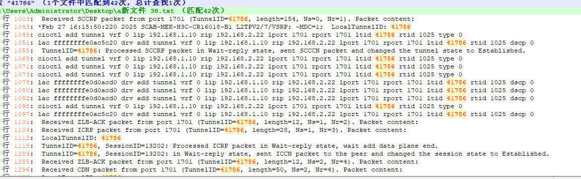

源192.168.1.10 到目的bras 192.168.2.22建立l2tp隧道建立失败。display l2tp tunnel 一直从Established 状态到stopping状态切换。display l2tp session 时有时无。debug显示已经控制层面协商------session协商----,对断是中兴设备,大神帮分析下debug。

*Feb 27 16:15:50:218 2025 SR8800 L2TPV2/7/EVENT: -MDC=1;
Parsed Message-Type AVP: 2.
Parsed Protocol-Version AVP. Version=1, Revision=0.
Parsed Framing-Capabilities AVP: 3.
*Feb 27 16:15:50:219 2025 SR8800 L2TPV2/7/EVENT: -MDC=1;
Parsed Bearer-Capabilities AVP: 1.
Parsed Firmware-Revision AVP: 1.
Parsed Host-Name AVP: LNS-MASTER.
Parsed Vendor-Name AVP: ZTE Corporation.
Parsed Assigned-Tunnel-ID AVP: 1025.
Parsed Receive-Window-Size AVP: 4.
Parsed Challenge AVP: 6a d6 ba b3 52 4c 02 a8 36 ae 15 b5 89 7f ca a1
Parsed Challenge-Response AVP: 05 b3 6c 85 45 57 b8 9c 2c 58 88 b5 e4 b9 e5 84
*Feb 27 16:15:50:219 2025 SR8800 L2TPV2/7/CONTROL-PKT: -MDC=1;
Encapsulated Message-Type AVP:
80 08 00 00 00 00 00 03
*Feb 27 16:15:50:220 2025 SR8800 L2TPV2/7/CONTROL-PKT: -MDC=1;
Encapsulated Challenge-Response AVP:
80 16 00 00 00 0d 63 4c 38 92 8f a0 ad 6d a3 e1
ae 85 b8 e3 31 e3
*Feb 27 16:15:50:220 2025 SR8800 L2TPV2/7/VSRP: -MDC=1; LocalTunnelID: 41786
RemoteTunnelID: 1025
LocalAddr: 192.168.1.10
RemoteAddr: 192.168.2.22
Notified the driver of adding a tunnel.
*Feb 27 16:15:50:220 2025 SR8800 L2TPV2/7/KEVENT: -MDC=1;
cioctl add tunnel vrf 0 lip 192.168.1.10 rip 192.168.2.22 lport 1701 rport 1701 ltid 41786 rtid 1025 type 0
lac ffffffffe0ac5c20 drv add tunnel vrf 0 lip 192.168.1.10 rip 192.168.2.22 lport 1701 rport 1701 ltid 41786 rtid 1025 dscp 0
result drv add tunnel 0
*Feb 27 16:15:50:220 2025 SR8800 L2TPV2/7/EVENT: -MDC=1;
TunnelID=41786: Processed SCCRP packet in Wait-reply state, sent SCCCN packet and changed the tunnel state to Established.

*Feb 27 16:15:50:237 2025 SR8800 L2TPV2/7/CONTROL-PKT: -MDC=1;
Received ICRP packet from port 1701 (TunnelID=41786, length=28, Ns=1, Nr=3). Packet content:
c8 02 00 1c a3 3a 33 92 00 01 00 03 80 08 00 00
00 00 00 0b 80 08 00 00 00 0e 79 7a
*Feb 27 16:15:50:237 2025 SR8800 L2TPV2/7/EVENT: -MDC=1;
Parsed Message-Type AVP: 11.
Parsed Assigned-Session-ID AVP: 31098.
*Feb 27 16:15:50:237 2025 SR8800 L2TPV2/7/VSRP: -MDC=1; IfName: Bas-interface123, Slot: 32768
LocalSessionID: 13202
RemoteSessionID: 31098
PPPUserID: 04a4000c00938c02cddabea2
Notified the driver of adding a session.
*Feb 27 16:15:50:238 2025 SR8800 L2TPV2/7/EVENT: -MDC=1;
TunnelID=41786, SessiOnID=13202: Processed ICRP packet in Wait-reply state, wait add data plane end.

Get adj drvpAdjEntry c00000030b17ea90
*Feb 27 16:15:49:980 2025 SR8800 L2TPV2/7/KEVENT: -MDC=1-Slot=17;
Get adj drv result 0 ifindex 0 AdjEntryAttribute 0 nexthop context[0] 186a2 nexthop context[1] ffffffff adj context[0] ffffffff adj context[1] ffffffff adj context[2] ffffffff adj context[3] 0 adj context[4] ffff3fff adj context[5] ffffff9f
LAC ffffffffe0ac5c30 drv add session ifindex 9567 lsid 13202 rsid 31098 dscp 0 attribute 1 subscriberid 0
*Feb 27 16:15:49:362 2025 SR8800 L2TPV2/7/KEVENT: -MDC=1-Slot=9;
Result drv add session 1073807369
*Feb 27 16:15:49:383 2025 SR8800 L2TPV2/7/KEVENT: -MDC=1-Slot=4;
ADJ call back 4 2738500498 16843
Result drv add session 0
ADJ call back 17 2738500498 16843
Modify get adj drv result 0 ifindex 9567 AdjEntryAttribute 0 Action 3 nexthop context[0] ffffffff nexthop context[1] ffffffff adj context[0] ffffffff adj context[1] 1f adj context[2] ffbffcff adj context[3] 573d adj context[4] ffff3fff adj context[5] ffff489f
Modify get adj drv result 0 ifindex 9567 AdjEntryAttribute 0 Action 3 nexthop context[0] ffffffff nexthop context[1] ffffffff adj context[0] ffffffff adj context[1] ffffffff adj context[2] 42ffffff adj context[3] ffffffff adj context[4] ffffffff adj context[5] fffffffd
LAC ffffffffe0d09f80 drv modify session ifindex 9567 lsid 13202 rsid 31098 dscp 0 attribute 0 subscriberid 0
LAC ffffffffe0ac5c30 drv modify session ifindex 9567 lsid 13202 rsid 31098 dscp 0 attribute 0 subscriberid 0
Result drv modify session 0
*Feb 27 16:15:49:626 2025 SR8800 L2TPV2/7/KEVENT: -MDC=1-Slot=2;
*Feb 27 16:15:49:363 2025 SR8800 L2TPV2/7/KEVENT: -MDC=1-Slot=9;
Result drv modify session 1073807369
*Feb 27 16:15:49:384 2025 SR8800 L2TPV2/7/KEVENT: -MDC=1-Slot=4;
*Feb 27 16:15:50:240 2025 SR8800 L2TPV2/7/KEVENT: -MDC=1;
LAC PPP user on interface Bas-interface123 (pppindex 0x4a4) is up.
*Feb 27 16:15:49:983 2025 SR8800 L2TPV2/7/KEVENT: -MDC=1-Slot=17;
*Feb 27 16:15:49:365 2025 SR8800 L2TPV2/7/KEVENT: -MDC=1-Slot=9;
ADJ call back 9 2738500498 16843
Modify get adj drv result 0 ifindex 9567 AdjEntryAttribute 1 Action 2 nexthop context[0] ffffffff nexthop context[1] ffffffff adj context[0] e0188c2b adj context[1] c0027 adj context[2] 42bec5ff adj context[3] 573d adj context[4] 1ff05cc adj context[5] 75ed008b
LAC ffffffffe0ac5c30 drv modify session ifindex 9567 lsid 13202 rsid 31098 dscp 0 attribute 1 subscriberid 0
*Feb 27 16:15:49:629 2025 SR8800 L2TPV2/7/KEVENT: -MDC=1-Slot=2;
ADJ call back 2 2738500498 16843
Modify get adj drv result 0 ifindex 9567 AdjEntryAttribute 1 Action 2 nexthop context[0] 1308ba nexthop context[1] ffffffff adj context[0] e0188c3b adj context[1] c0027 adj context[2] 42bec5ff adj context[3] 5990 adj context[4] 1ff05cc adj context[5] 75ed0089
Modify get adj drv result 0 ifindex 9567 AdjEntryAttribute 1 Action 2 nexthop context[0] eed13 nexthop context[1] ffffffff adj context[0] e0188c3b adj context[1] c0027 adj context[2] 42bec5ff adj context[3] 5990 adj context[4] 1ff05cc adj context[5] 75ed0089
LAC ffffffffe0d09f80 drv modify session ifindex 9567 lsid 13202 rsid 31098 dscp 0 attribute 1 subscriberid 0
*Feb 27 16:15:49:386 2025 SR8800 L2TPV2/7/KEVENT: -MDC=1-Slot=4;
Modify get adj drv result 0 ifindex 9567 AdjEntryAttribute 1 Action 2 nexthop context[0] 113f7c nexthop context[1] ffffffff adj context[0] e0188c3b adj context[1] c0027 adj context[2] 42bec5ff adj context[3] 5990 adj context[4] 1ff05cc adj context[5] 75ed0089
*Feb 27 16:15:49:387 2025 SR8800 L2TPV2/7/KEVENT: -MDC=1-Slot=4;
*Feb 27 16:15:49:630 2025 SR8800 L2TPV2/7/KEVENT: -MDC=1-Slot=2;
*Feb 27 16:15:50:243 2025 SR8800 L2TPV2/7/CONTROL-PKT: -MDC=1;
80 08 00 00 00 00 00 0c
Encapsulated (Tx)Connect-Speed AVP:
80 0a 00 00 00 18 ff ff ff ff
Encapsulated Framing-Type AVP:
80 0a 00 00 00 13 00 00 00 01
Encapsulated Rx-Connect-Speed AVP:
00 0a 00 00 00 26 ff ff ff ff
Encapsulated Initial-Received-LCP-CONFREQ AVP:
00 10 00 00 00 1a 01 04 05 cc 05 06 67 0d 8e 61
Encapsulated Last-Sent-LCP-CONFREQ AVP:
00 14 00 00 00 1b 01 04 05 d4 03 04 c0 23 05 06
1d 47 d0 86
Encapsulated Last-Received-LCP-CONFREQ AVP:
00 10 00 00 00 1c 01 04 05 cc 05 06 67 0d 8e 61
Encapsulated Proxy-Authen-Type AVP:
00 08 00 00 00 1d 00 03
Encapsulated Proxy-Authen-Name AVP:
00 12 00 00 00 1e 30 38 33 37 30 31 30 30 30 30
35 34
*Feb 27 16:15:50:244 2025 SR8800 L2TPV2/7/CONTROL-PKT: -MDC=1;
Encapsulated Proxy-Authen-ID AVP:
00 08 00 00 00 20 00 01
Encapsulated Proxy-Authen-Response AVP:
00 0c 00 00 00 21 30 35 30 34 31 32
*Feb 27 16:15:50:244 2025 SR8800 L2TPV2/7/KEVENT: -MDC=1;
LAC Notify ppp up(SIOCPWUP). (ifIndex = 9567)
Bind adj ifindex 9567 time 16843
Result bind adj c0000002eac18340 13835058069213853592
Get adj drvpAdjEntry c0000002eac18340
Get adj drv result 0 ifindex 9567 AdjEntryAttribute 1 nexthop context[0] ffffffff nexthop context[1] ffffffff adj context[0] e0188c1b adj context[1] c0027 adj context[2] 42bec5ff adj context[3] 5990 adj context[4] 1ff05cc adj context[5] 75ed008b
*Feb 27 16:15:50:245 2025 SR8800 L2TPV2/7/EVENT: -MDC=1;
TunnelID=41786, SessiOnID=13202: in Wait-reply state, sent ICCN packet to the peer and changed the session state to Established.
*Feb 27 16:15:50:255 2025 SR8800 L2TPV2/7/CONTROL-PKT: -MDC=1;
Received ZLB-ACK packet from port 1701 (TunnelID=41786, length=12, Ns=2, Nr=4). Packet content:
c8 02 00 0c a3 3a 00 00 00 02 00 04
*Feb 27 16:15:53:975 2025 SR8800 L2TPV2/7/CONTROL-PKT: -MDC=1;
80 08 00 00 00 00 00 06
*Feb 27 16:15:53:975 2025 SR8800 L2TPV2/7/EVENT: -MDC=1;
TunnelID=62362: Sent a Hello packet. Ns=57131, Nr=2272.
*Feb 27 16:15:53:994 2025 SR8800 L2TPV2/7/CONTROL-PKT: -MDC=1;
Received ZLB-ACK packet from port 1701 (TunnelID=62362, length=12, Ns=2272, Nr=57132). Packet content:
c8 02 00 0c f3 9a 00 00 08 e0 df 2c
*Feb 27 16:16:02:326 2025 SR8800 L2TPV2/7/CONTROL-PKT: -MDC=1;
Received CDN packet from port 1701 (TunnelID=41786, length=50, Ns=2, Nr=4). Packet content:
c8 02 00 32 a3 3a 33 92 00 02 00 04 80 08 00 00
00 00 00 0e 80 0b 00 00 00 01 00 03 00 00 00 80
08 00 00 00 0e 79 7a 00 0b 00 00 00 2e 00 10 00
00 02
*Feb 27 16:16:02:326 2025 SR8800 L2TPV2/7/EVENT: -MDC=1;
Parsed Message-Type AVP: 14.
*Feb 27 16:16:02:327 2025 SR8800 L2TPV2/7/EVENT: -MDC=1;
Parsed Result-Code AVP. Result-Code=3, Error-Code=0, Error-Message="".
*Feb 27 16:16:02:327 2025 SR8800 L2TPV2/7/VSRP: -MDC=1; IfName: Bas-interface123, Slot: 0
RemoteSessionID: 0
PPPUserID: 000000000000000000000000
Notified the driver of deleting a session.
*Feb 27 16:16:02:327 2025 SR8800 L2TPV2/7/KEVENT: -MDC=1;
Get adj drv result 0 ifindex 9567 AdjEntryAttribute 1 Action 2 nexthop context[0] ffffffff nexthop context[1] ffffffff adj context[0] e0188c1b adj context[1] c0027 adj context[2] 42bec5ff adj context[3] 5990 adj context[4] 1ff05cc adj context[5] 75ed008b
LAC ffffffffe0ac5c30 drv delete session ifindex 9567 lsid 13202 rsid 31098 attribute 1 subscriberid 0
*Feb 27 16:16:02:328 2025 SR8800 L2TPV2/7/VSRP: -MDC=1; IfName: Bas-interface123, Slot: 0
RemoteSessionID: 0
*Feb 27 16:16:02:069 2025 SR8800 L2TPV2/7/KEVENT: -MDC=1-Slot=17;
Get adj drv result 0 ifindex 9567 AdjEntryAttribute 1 Action 2 nexthop context[0] ffffffff nexthop context[1] ffffffff adj context[0] e0188c2b adj context[1] c0027 adj context[2] 42bec5ff adj context[3] 573d adj context[4] 1ff05cc adj context[5] 75ed008b
*Feb 27 16:16:01:472 2025 SR8800 L2TPV2/7/KEVENT: -MDC=1-Slot=4;
Get adj drv result 0 ifindex 9567 AdjEntryAttribute 1 Action 2 nexthop context[0] 113f7c nexthop context[1] ffffffff adj context[0] e0188c3b adj context[1] c0027 adj context[2] 42bec5ff adj context[3] 5990 adj context[4] 1ff05cc adj context[5] 75ed0089
*Feb 27 16:16:01:715 2025 SR8800 L2TPV2/7/KEVENT: -MDC=1-Slot=2;
Get adj drv result 0 ifindex 9567 AdjEntryAttribute 1 Action 2 nexthop context[0] 1308ba nexthop context[1] ffffffff adj context[0] e0188c3b adj context[1] c0027 adj context[2] 42bec5ff adj context[3] 5990 adj context[4] 1ff05cc adj context[5] 75ed0089
LAC ffffffffe0d09f80 drv delete session ifindex 9567 lsid 13202 rsid 31098 attribute 1 subscriberid 0
LAC PPP user on interface Bas-interface123 (pppindex 0x4a4) is down .
%Feb 27 16:16:02:329 2025 SR8800 L2TPV2/1/VSRP: -MDC=1;
PPPLogStatus: Logged out
IfName: Bas-interface123 (pppindex 0x4a4)
%Feb 27 16:16:02:330 2025 SR8800 L2TPV2/1/VSRP: -MDC=1;
*Feb 27 16:16:01:453 2025 SR8800 L2TPV2/7/KEVENT: -MDC=1-Slot=9;
Get adj drv result 0 ifindex 0 AdjEntryAttribute 0 Action 4 nexthop context[0] ffffffff nexthop context[1] ffffffff adj context[0] ffffffff adj context[1] ffffffff adj context[2] ffffffff adj context[3] ffffffff adj context[4] ffffffff adj context[5] fffffffd
*Feb 27 16:16:02:331 2025 SR8800 L2TPV2/7/KEVENT: -MDC=1;
%Feb 27 16:16:02:331 2025 SR8800 L2TPV2/1/VSRP: -MDC=1;
*Feb 27 16:16:02:575 2025 SR8800 L2TPV2/7/EVENT: -MDC=1;
TunnelID=41786: Delay-ACK timer expired, received duplicate Hello packet for 0 times and sent ZLB-ACK packet for 1 times. Ns=4, Nr=3.
*Feb 27 16:16:13:275 2025 SR8800 L2TPV2/7/CONTROL-PKT: -MDC=1;
*Feb 27 16:16:13:275 2025 SR8800 L2TPV2/7/EVENT: -MDC=1;
TunnelID=41208: Sent a Hello packet. Ns=57756, Nr=3036.
*Feb 27 16:16:13:296 2025 SR8800 L2TPV2/7/CONTROL-PKT: -MDC=1;
Received ZLB-ACK packet from port 1701 (TunnelID=41208, length=12, Ns=3036, Nr=57757). Packet content:
c8 02 00 0c a0 f8 00 00 0b dc e1 9d
*Feb 27 16:16:13:675 2025 SR8800 L2TPV2/7/KEVENT: -MDC=1-Slot=2;
LAC PPP user on interface Bas-interface123 (pppindex 0x4a5) is up.
*Feb 27 16:16:14:289 2025 SR8800 L2TPV2/7/CONTROL-PKT: -MDC=1;
80 08 00 00 00 00 00 0a
*Feb 27 16:16:14:290 2025 SR8800 L2TPV2/7/CONTROL-PKT: -MDC=1;
Encapsulated Assigned-Session-ID AVP:
80 08 00 00 00 0e d1 cd
Encapsulated Call-Serial-Number AVP:
80 0a 00 00 00 0f 00 00 d1 cd
Encapsulated Bearer-Type AVP:
80 0a 00 00 00 12 00 00 00 01
Encapsulated Physical-Channel-ID AVP:
00 0a 00 00 00 19 00 00 00 00
Encapsulated Calling-Number AVP:
80 28 00 00 00 16 64 38 30 39 2d 37 66 33 31 2d
62 34 62 61 20 52 41 47 47 31 30 2e 31 32 3a 30
30 30 63 2e 30 30 37 62
*Feb 27 16:16:14:303 2025 SR8800 L2TPV2/7/CONTROL-PKT: -MDC=1;
Received ICRP packet from port 1701 (TunnelID=41786, length=28, Ns=3, Nr=5). Packet content:
c8 02 00 1c a3 3a d1 cd 00 03 00 05 80 08 00 00
00 00 00 0b 80 08 00 00 00 0e 79 7b
*Feb 27 16:16:14:304 2025 SR8800 L2TPV2/7/EVENT: -MDC=1;
Parsed Assigned-Session-ID AVP: 31099.
*Feb 27 16:16:14:304 2025 SR8800 L2TPV2/7/VSRP: -MDC=1; IfName: Bas-interface123, Slot: 32768
LocalSessionID: 53709

TunnelID=41786: Delay-ACK timer expired, received duplicate Hello packet for 0 times and sent ZLB-ACK packet for 1 times. Ns=6, Nr=5.
*Feb 27 16:16:41:075 2025 SR8800 L2TPV2/7/CONTROL-PKT: -MDC=1;
*Feb 27 16:16:41:075 2025 SR8800 L2TPV2/7/EVENT: -MDC=1;
TunnelID=20446: Sent a Hello packet. Ns=28206, Nr=225.
*Feb 27 16:16:41:093 2025 SR8800 L2TPV2/7/CONTROL-PKT: -MDC=1;
Received ZLB-ACK packet from port 1701 (TunnelID=20446, length=12, Ns=225, Nr=28207). Packet content:
c8 02 00 0c 4f de 00 00 00 e1 6e 2f
*Feb 27 16:16:41:463 2025 SR8800 L2TPV2/7/CONTROL-PKT: -MDC=1;
Received StopCCN packet from port 1701 (TunnelID=41786, length=64, Ns=5, Nr=6). Packet content:
c8 02 00 40 a3 3a 00 00 00 05 00 06 80 08 00 00
00 00 00 04 80 24 00 00 00 01 00 02 00 00 74 75
6e 6e 65 6c 20 6e 6f 5f 73 65 73 73 69 6f 6e 20
74 69 6d 65 6f 75 74 00 80 08 00 00 00 09 04 01
*Feb 27 16:16:41:463 2025 SR8800 L2TPV2/7/EVENT: -MDC=1;
Parsed Message-Type AVP: 4.
Parsed Result-Code AVP. Result-Code=2, Error-Code=0, Error-Message="tunnel no_session timeout".
*Feb 27 16:16:41:464 2025 SR8800 L2TPV2/7/VSRP: -MDC=1; LocalTunnelID: 41786
Notified the driver of deleting a tunnel.
*Feb 27 16:16:41:464 2025 SR8800 L2TPV2/7/KEVENT: -MDC=1;
lac ffffffffe0ac5c20 drv delete tunnel vrf 0 lip 192.168.1.10 rip 192.168.2.22 lport 1701 rport 1701 ltid 41786 rtid 1025
*Feb 27 16:16:41:464 2025 SR8800 L2TPV2/7/EVENT: -MDC=1;
TunnelID=41786: Processed StopCCN packet in Established state, and changed the tunnel state to Stopping.

*Feb 27 16:17:08:145 2025 SR8800 L2TPV2/7/CONTROL-PKT: -MDC=1;
00 10 00 00 00 1a 01 04 05 cc 05 06 98 88 9e 39
c0 b5 4c 90
00 10 00 00 00 1c 01 04 05 cc 05 06 98 88 9e 39
35 34
*Feb 27 16:17:08:146 2025 SR8800 L2TPV2/7/CONTROL-PKT: -MDC=1;
*Feb 27 16:17:08:146 2025 SR8800 L2TPV2/7/KEVENT: -MDC=1;
Bind adj ifindex 9567 time 16845
Result bind adj c0000002eac18c30 13835058069213853592
Get adj drvpAdjEntry c0000002eac18c30
Get adj drv result 0 ifindex 9567 AdjEntryAttribute 1 nexthop context[0] ffffffff nexthop context[1] ffffffff adj context[0] e025371b adj context[1] c0027 adj context[2] 42bec5ff adj context[3] 5997 adj context[4] 1ff05cc adj context[5] 75ed008b
LAC ffffffffe0ac5c30 drv add session ifindex 9567 lsid 43774 rsid 11 dscp 0 attribute 1 subscriberid 0
*Feb 27 16:17:08:147 2025 SR8800 L2TPV2/7/EVENT: -MDC=1;
TunnelID=54891, SessiOnID=43774: in Wait-reply state, sent ICCN packet to the peer and changed the session state to Established.
*Feb 27 16:17:08:155 2025 SR8800 L2TPV2/7/CONTROL-PKT: -MDC=1;
Received ZLB-ACK packet from port 1701 (TunnelID=54891, length=12, Ns=2, Nr=4). Packet content:
c8 02 00 0c d6 6b 00 00 00 02 00 04
*Feb 27 16:17:12:475 2025 SR8800 L2TPV2/7/EVENT: -MDC=1;
TunnelID=41786: Delay-Cleanup timer expired and deleted the local tunnel.
*Feb 27 16:17:13:275 2025 SR8800 L2TPV2/7/CONTROL-PKT: -MDC=1;
*Feb 27 16:17:13:275 2025 SR8800 L2TPV2/7/EVENT: -MDC=1;
TunnelID=41208: Sent a Hello packet. Ns=57757, Nr=3036.
*Feb 27 16:17:13:293 2025 SR8800 L2TPV2/7/CONTROL-PKT: -MDC=1;
Received ZLB-ACK packet from port 1701 (TunnelID=41208, length=12, Ns=3036, Nr=57758). Packet content:
c8 02 00 0c a0 f8 00 00 0b dc e1 9e
*Feb 27 16:17:20:226 2025 SR8800 L2TPV2/7/CONTROL-PKT: -MDC=1;
Received CDN packet from port 1701 (TunnelID=54891, length=50, Ns=2, Nr=4). Packet content:
c8 02 00 32 d6 6b aa fe 00 02 00 04 80 08 00 00
08 00 00 00 0e 00 0b 00 0b 00 00 00 2e 00 10 00
00 02
*Feb 27 16:17:20:226 2025 SR8800 L2TPV2/7/EVENT: -MDC=1;
Parsed Assigned-Session-ID AVP: 11.
*Feb 27 16:17:20:226 2025 SR8800 L2TPV2/7/VSRP: -MDC=1; IfName: Bas-interface123, Slot: 0
LocalTunnelID: 54891
LocalSessionID: 43774
RemoteSessionID: 0
*Feb 27 16:17:20:227 2025 SR8800 L2TPV2/7/KEVENT: -MDC=1;
Get adj drv result 0 ifindex 9567 AdjEntryAttribute 1 Action 2 nexthop context[0] ffffffff nexthop context[1] ffffffff adj context[0] e025371b adj context[1] c0027 adj context[2] 42bec5ff adj context[3] 5997 adj context[4] 1ff05cc adj context[5] 75ed008b
LAC ffffffffe0ac5c30 drv delete session ifindex 9567 lsid 43774 rsid 11 attribute 1 subscriberid 0
*Feb 27 16:17:20:227 2025 SR8800 L2TPV2/7/VSRP: -MDC=1; IfName: Bas-interface123, Slot: 0
RemoteSessionID: 0
*Feb 27 16:17:19:346 2025 SR8800 L2TPV2/7/KEVENT: -MDC=1-Slot=9;
Get adj drv result 0 ifindex 9567 AdjEntryAttribute 1 Action 2 nexthop context[0] 58233 nexthop context[1] ffffffff adj context[0] e025373b adj context[1] c0027 adj context[2] 42bec5ff adj context[3] 5997 adj context[4] 1ff05cc adj context[5] 75ed0089
*Feb 27 16:17:19:611 2025 SR8800 L2TPV2/7/KEVENT: -MDC=1-Slot=2;
Get adj drv result 0 ifindex 9567 AdjEntryAttribute 1 Action 2 nexthop context[0] 12e1b3 nexthop context[1] ffffffff adj context[0] e025373b adj context[1] c0027 adj context[2] 42bec5ff adj context[3] 5997 adj context[4] 1ff05cc adj context[5] 75ed0089
*Feb 27 16:17:19:969 2025 SR8800 L2TPV2/7/KEVENT: -MDC=1-Slot=17;
Get adj drv result 0 ifindex 9567 AdjEntryAttribute 1 Action 2 nexthop context[0] ffffffff nexthop context[1] ffffffff adj context[0] e025372b adj context[1] c0027 adj context[2] 42bec5ff adj context[3] 5745 adj context[4] 1ff05cc adj context[5] 75ed008b
LAC ffffffffe0d09f80 drv delete session ifindex 9567 lsid 43774 rsid 11 attribute 1 subscriberid 0
*Feb 27 16:17:19:367 2025 SR8800 L2TPV2/7/KEVENT: -MDC=1-Slot=4;
Get adj drv result 0 ifindex 9567 AdjEntryAttribute 1 Action 2 nexthop context[0] 12ded8 nexthop context[1] ffffffff adj context[0] e025373b adj context[1] c0027 adj context[2] 42bec5ff adj context[3] 5997 adj context[4] 1ff05cc adj context[5] 75ed0089
*Feb 27 16:17:19:612 2025 SR8800 L2TPV2/7/KEVENT: -MDC=1-Slot=2;
LAC PPP user on interface Bas-interface123 (pppindex 0x4a6) is down .
%Feb 27 16:17:20:228 2025 SR8800 L2TPV2/1/VSRP: -MDC=1;
IfName: Bas-interface123 (pppindex 0x4a6)
%Feb 27 16:17:20:230 2025 SR8800 L2TPV2/1/VSRP: -MDC=1;
*Feb 27 16:17:20:230 2025 SR8800 L2TPV2/7/KEVENT: -MDC=1;
%Feb 27 16:17:20:231 2025 SR8800 L2TPV2/1/VSRP: -MDC=1;
*Feb 27 16:17:20:475 2025 SR8800 L2TPV2/7/EVENT: -MDC=1;
TunnelID=54891: Delay-ACK timer expired, received duplicate Hello packet for 0 times and sent ZLB-ACK packet for 1 times. Ns=4, Nr=3.
*Feb 27 16:17:23:175 2025 SR8800 L2TPV2/7/CONTROL-PKT: -MDC=1;
*Feb 27 16:17:23:175 2025 SR8800 L2TPV2/7/EVENT: -MDC=1;
TunnelID=37335: Sent a Hello packet. Ns=55683, Nr=306.
*Feb 27 16:17:23:196 2025 SR8800 L2TPV2/7/CONTROL-PKT: -MDC=1;
Received ZLB-ACK packet from port 1701 (TunnelID=37335, length=12, Ns=306, Nr=55684). Packet content:
c8 02 00 0c 91 d7 00 00 01 32 d9 84
问题已经解决,问题是radisu AAA服务器防火墙未放通中兴BRAS的IP。
zhiliao_8h84K9 发表时间:2025-02-28 更多>>
