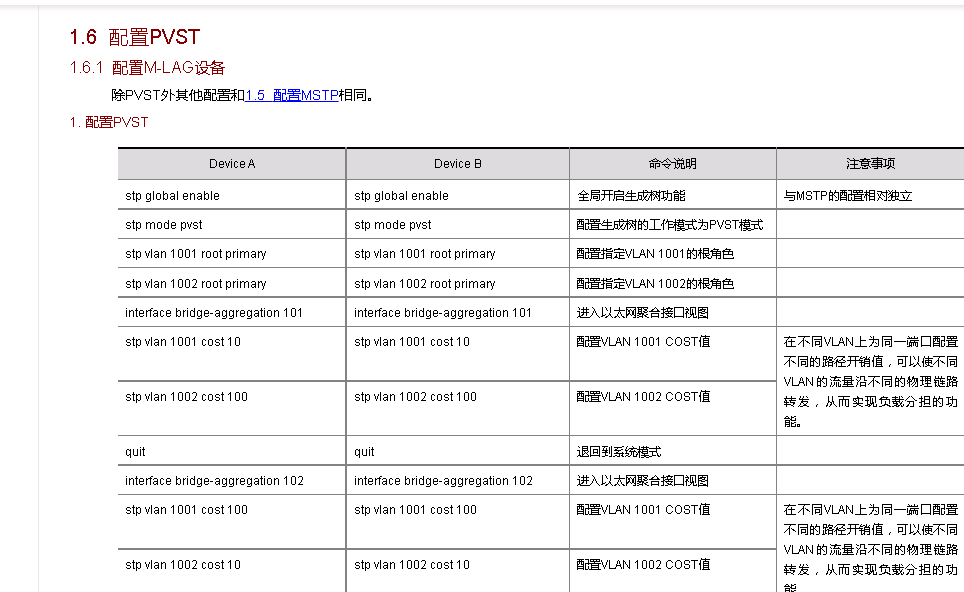

你好,参考这个配置https://www.h3c.com/cn/d_202209/1699112_30005_0.htm#_Toc112838767
