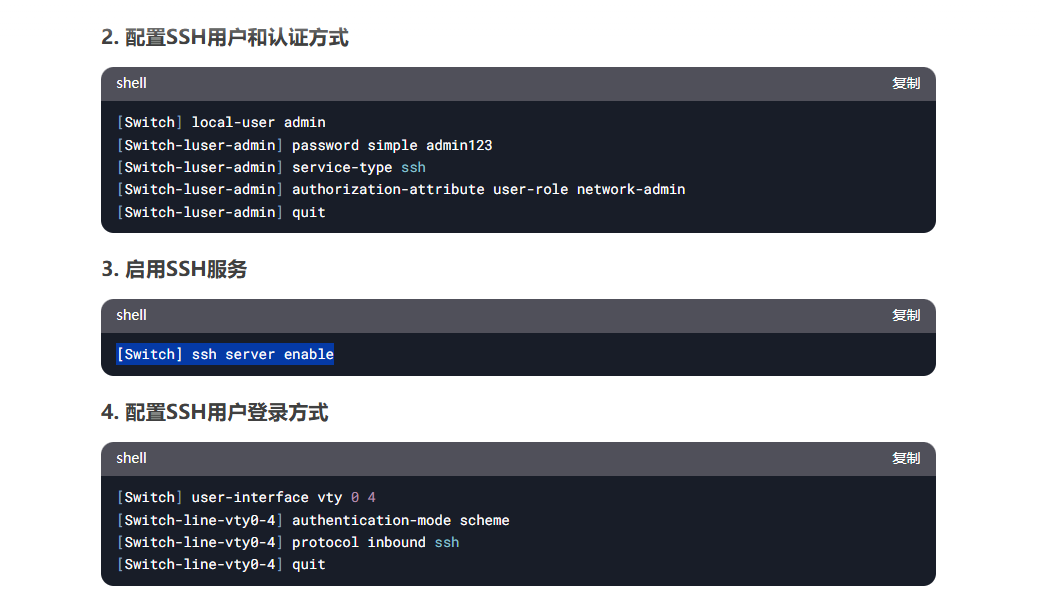

在crt上怎么操作呢,现在交换机没有账户,需要添加一个账户和密码
[Switch] local-user admin [Switch-luser-admin] password simple admin123 [Switch-luser-admin] service-type ssh [Switch-luser-admin] authorization-attribute user-role network-admin [Switch-luser-admin] quit [Switch] user-interface vty 0 4 [Switch-line-vty0-4] authentication-mode scheme [Switch-line-vty0-4] protocol inbound ssh [Switch-line-vty0-4] quit [Switch] ssh server enable

sys
local-user admin
password sim ****
ser-type  http ***
