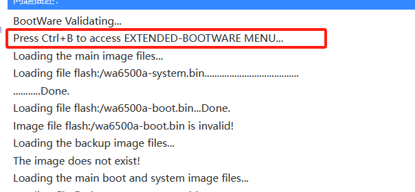

6522H-HI系统进不去,BootWare似乎也不行
2025-03-28提问
  • 0收藏,1471浏览
BootWare Validating...
Press Ctrl+B to access EXTENDED-BOOTWARE MENU...
Loading the main image files...
Loading file flash:/wa6500a-system.bin......................................
...........Done.
Loading file flash:/wa6500a-boot.bin...Done.
Image file flash:/wa6500a-boot.bin is invalid!
Loading the backup image files...
The image does not exist!
Loading the main boot and system image files...
...........Done.
Loading file flash:/wa6500a-boot.bin....Done.
Loading images fails.
Trying to get the IP address from the DHCP server......
粉丝:44人 关注:1人
提示boot 文件是无效的,做了什么操作吗
在这个时候进入bootware
看看是不是输入法有问题,重启再输入一下
