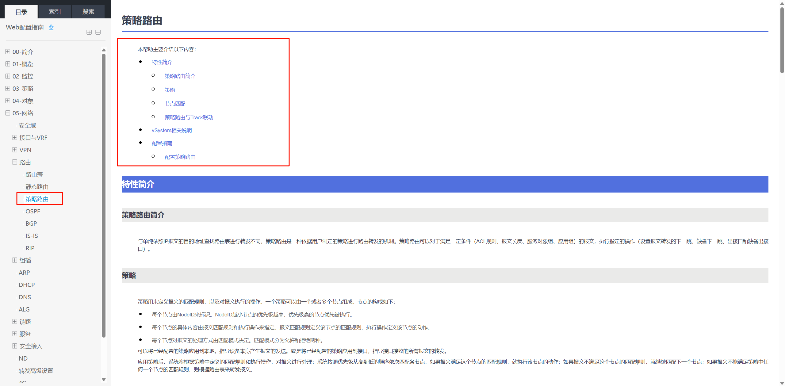

参考官方文档
https://www.h3c.com/cn/d_202203/1570245_30005_0.htm
