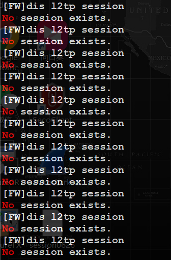

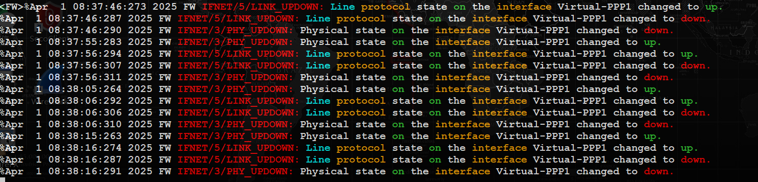

F100-S-G2做为网关或旁挂核心交换机(两个模式都测试过),防火墙固件版本为官方最新版,配置l2tp mode lac 对接友商设备,某捷,某为,隧道可以成功建立,但是没有会话,virtual-ppp 频繁up down
配置应该没问题的,用户名密码,隧道密码,多次确认了没错,相同网络环境下使用msr800路由器配置lac模式能正常通信
请问各位大佬,是什么原因导致的呀,安全策略放行了呀,不然隧道也建立不起来呀
 F100-S-G2防火墙L2TP LAC模式隧道建立成功但无会话、Virtual-PPP频繁UP/DOWN的可能原因如下:

debug 来了,大佬们帮帮忙,谢谢,lns-ip 替换为了X.X.X.X
​<FW>terminal de
<FW>terminal debugging
The current terminal is enabled to display debugging logs.
<FW>ter
<FW>terminal m
<FW>terminal monitor
The current terminal is enabled to display logs.

*Apr 1 08:48:45:262 2025 FW L2TPV2/7/KEVENT:
AutoClient Notify ppp up(IF_LINKUP_UP). (ifIndex = 137)
%Apr 1 08:48:45:263 2025 FW IFNET/3/PHY_UPDOWN: Physical state on the interface Virtual-PPP1 changed to up.

%Apr 1 08:48:46:277 2025 FW IFNET/5/LINK_UPDOWN: Line protocol state on the interface Virtual-PPP1 changed to up.
