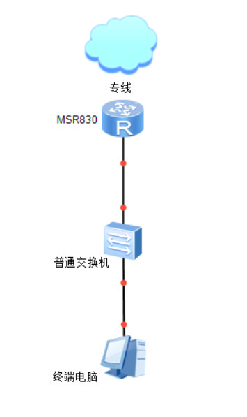

路由DHCP地址池如下:
[H3C]dhcp server ip-pool vlan1 extended
[H3C-dhcp-pool-vlan1]dis this
 network ip range 192.168.200.2 192.168.200.254
 network mask 255.255.255.0
 gateway-list 192.168.200.1
 dns-list 192.168.200.1
但dhcp地址池下没有静态绑定ip的命令:

请问技术大牛,这该怎么操作,才能将IP和MAC绑定?谢谢。

vlan接口信息如下:
[H3C]dis cur interface vlan1
interface Vlan-interface1
ip address 192.168.200.1 255.255.255.0
tcp mss 1024
dhcp server apply ip-pool vlan1
