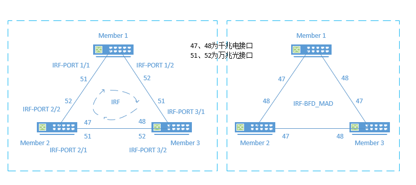

环形堆叠bfdmad该怎么配?
粉丝:0人 关注:3人
irf-port 1/1
port group interface Ten-GigabitEthernet1/0/52
irf-port 1/2
port group interface Ten-GigabitEthernet1/0/51
irf-port 2/1
port group interface Ten-GigabitEthernet2/0/51
irf-port 2/2
port group interface Ten-GigabitEthernet2/0/52
irf-port 3/1
port group interface Ten-GigabitEthernet3/0/51
irf-port 3/2
port group interface Ten-GigabitEthernet3/0/52
interface Vlan-interface99
mad bfd enable
mad ip address 192.168.130.3 255.255.255.0 member 1
mad ip address 192.168.130.4 255.255.255.0 member 2
mad ip address 192.168.130.5 255.255.255.0 member 3
interface GigabitEthernet1|2|3/0/48
port link-mode bridge
port access vlan 99
undo stp enable
interface GigabitEthernet1|2|3/0/47
port access vlan 99
undo stp enable
每台设备都接一根线到中间设备做检测
聚合做LDAP

没有中间设备
zhiliao_9srwzR 发表时间:2025-04-27
聚合做LDAP
zhiliao_sEUyB 发表时间:2025-04-27
我之前是这样子做的,你可以参考一下
看了下面的,mad检测的物理接口是环路的,又关闭了STP,要么是一根线,要么两根线做聚合,等于说 47口和48口做聚合就行了
沉鱼落雁_解决问题看主页 发表时间:2025-04-27 更多>>
你mad检测怎么配置的?
和手册案例的一样,不过这个是真机,不是模拟器做出来的,模拟器会卡死机
我按你这个方法做mad检测,mad三台设备三个ip,插上拔掉一根堆叠线后回重启设备
堆叠分裂本来就是会重启设备,mad检测会让备堆叠组的设备关闭接口
问题是我不是一个环形的吗,拔一根不会分裂吧?
是真机吗,环形是不会分裂,看下堆叠是否是三个,可以看我主页
兄弟,看看这样是否正确配置? # irf-port 1/1 port group interface Ten-GigabitEthernet1/0/52 # irf-port 1/2 port group interface Ten-GigabitEthernet1/0/51 # irf-port 2/1 port group interface Ten-GigabitEthernet2/0/51 # irf-port 2/2 port group interface Ten-GigabitEthernet2/0/52 # irf-port 3/1 port group interface Ten-GigabitEthernet3/0/51 # irf-port 3/2 port group interface Ten-GigabitEthernet3/0/52 # interface Vlan-interface99 mad bfd enable mad ip address 192.168.130.3 255.255.255.0 member 1 mad ip address 192.168.130.4 255.255.255.0 member 2 mad ip address 192.168.130.5 255.255.255.0 member 3 # interface GigabitEthernet1|2|3/0/48 port link-mode bridge port access vlan 99 undo stp enable # interface GigabitEthernet1|2|3/0/47 port link-mode bridge port access vlan 99 undo stp enable
