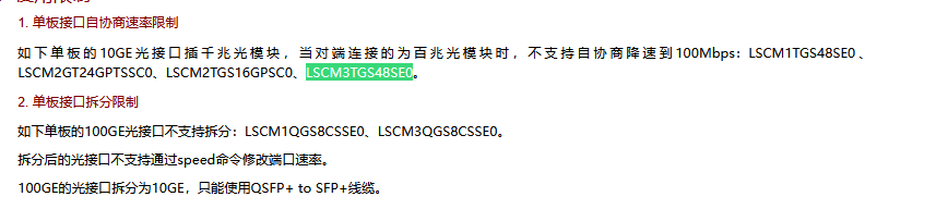

H3C S7506X-G的10GBASE-RSFP+板卡支持百兆光模块吗?
  • 0收藏,2063浏览
交换机型号:H3C S7506X-G
板卡:10GBASE-RSFP+
支持百兆光模块吗?交换机上需要加什么配置才能用百兆光模块呢?
粉丝:45人 关注:1人
不支持
1.2  单板与光模块适配关系表
表1-1 单板与光模块适配关系表

R7756P06
QSFP-40G-LR4-PSM1310
R7756P06
QSFP-40G-LR4-WDM1300
R7756P06
QSFP-40G-LX4-WDM1300
R7756P06
QSFP-40G-SR4-MM850
R7756P06
5~12
LSWM1QSTK0
R7756P06
LSWM1QSTK1
R7756P06
LSWM1QSTK2
R7756P06
LSWM1QSTK3
R7756P06
LSWM1QSTK4
R7756P06
LSWM1QSTK5
R7756P06
OT-QSFP+-SFP+-ADAPTER
R7756P06
QSFP-100G-4SFP-25G-CAB-1M
R7756P06
QSFP-100G-4SFP-25G-CAB-3M
R7756P06
QSFP-100G-CWDM4-SM1300-A
R7756P06
QSFP-100G-D-AOC-10M
R7756P06
QSFP-100G-D-AOC-20M
R7756P06
QSFP-100G-D-AOC-7M
R7756P06
QSFP-100G-D-CAB-1M
R7756P06
QSFP-100G-D-CAB-3M
R7756P06
QSFP-100G-DR1-SM1310
E7760
QSFP-100G-eSR4-MM850
R7756P06
QSFP-100G-FR1-SM1310
E7760
QSFP-100G-LR4L-WDM1300
R7756P06
QSFP-100G-LR4-WDM1300
R7756P06
QSFP-100G-LR4-WDM1300-A
R7756P06
QSFP-100G-PSM4-SM1310
R7756P06
QSFP-100G-SR4-MM850
R7756P06
QSFP-100G-SR4-MM850-A
R7756P06
QSFP-100G-SWDM4-MM850
R7756P06
QSFP-40G-BIDI-SR-MM850
R7756P06
QSFP-40G-BIDI-WDM850
R7756P06
QSFP-40G-CSR4-MM850
R7756P06
QSFP-40G-D-AOC-10M
R7756P06
QSFP-40G-D-AOC-10M-H
R7756P06
QSFP-40G-D-AOC-20M
R7756P06
QSFP-40G-D-AOC-20M-H
R7756P06
QSFP-40G-D-AOC-7M
R7756P06
QSFP-40G-D-AOC-7M-H
R7756P06
QSFP-40G-ER4-WDM1300
R7756P06
QSFP-40G-LR4L-WDM1300
R7756P06
R7756P06
R7756P06
R7756P06
QSFP-40G-SR4-MM850
R7756P06
LSCM3MPUS06A0
1
SFP-GE-LH100-SM1550
R7743P05
SFP-GE-LH40-SM1310
R7743P05
SFP-GE-LH40-SM1310-D
R7743P05
SFP-GE-LH40-SM1550
R7743P05
SFP-GE-LH80-SM1550
R7743P05
SFP-GE-LH80-SM1550-D
R7743P05
SFP-GE-LX-SM1310-A
R7743P05
SFP-GE-LX-SM1310-BIDI
R7743P05
SFP-GE-LX-SM1310-D
R7743P05
SFP-GE-LX-SM1490-BIDI
R7743P05
SFP-GE-SX-MM850-A
R7743P05
SFP-GE-SX-MM850-D
R7743P05
LSCM3MPUS06A0-G3
MANAGEMENT
SFP-GE-LH100-SM1550
R7756P06
SFP-GE-LH40-SM1310
R7756P06
R7756P06
SFP-GE-LH40-SM1550
R7756P06
SFP-GE-LH80-SM1550
R7756P06
R7756P06
SFP-GE-LX-SM1310-A
R7756P06
R7756P06
SFP-GE-LX-SM1310-D
R7756P06
R7756P06
SFP-GE-SX-MM850-A
R7756P06
SFP-GE-SX-MM850-D
R7756P06
LSCM3MPUS10B0
MANAGEMENT
SFP-GE-LH100-SM1550
E7744P05
SFP-GE-LH40-SM1310
E7744P05
E7744P05
SFP-GE-LH40-SM1550
E7744P05
SFP-GE-LH80-SM1550
E7744P05
E7744P05
SFP-GE-LX-SM1310-A
E7744P05
E7744P05
SFP-GE-LX-SM1310-D
E7744P05
E7744P05
SFP-GE-SX-MM850-A
E7744P05
SFP-GE-SX-MM850-D
E7744P05
LSCM3MPUS10B0-G3
MANAGEMENT
SFP-GE-LH100-SM1550
R7756P06
SFP-GE-LH40-SM1310
R7756P06
R7756P06
SFP-GE-LH40-SM1550
R7756P06
SFP-GE-LH80-SM1550
R7756P06
R7756P06
SFP-GE-LX-SM1310-A
R7756P06
R7756P06
SFP-GE-LX-SM1310-D
R7756P06
R7756P06
SFP-GE-SX-MM850-A
R7756P06
SFP-GE-SX-MM850-D
R7756P06
LSCM3MPUS10C0
MANAGEMENT
SFP-GE-LH100-SM1550
E7755
SFP-GE-LH40-SM1310
E7755
E7755
SFP-GE-LH40-SM1550
E7755
SFP-GE-LH80-SM1550
E7755
E7755
SFP-GE-LX-SM1310-A
E7755
E7755
SFP-GE-LX-SM1310-D
E7755
E7755
SFP-GE-SX-MM850-A
E7755
SFP-GE-SX-MM850-D
E7755
LSCM3QGS8CSSE0
1~4,9~12,5~8
LSWM1QSTK0
R7743P05, Can only be used for IRF/M-LAG setup connections.
LSWM1QSTK1
LSWM1QSTK2
R7743P05
R7743P05
QSFP-40G-CSR4-MM850
R7743P05
QSFP-40G-D-AOC-10M
R7743P05
QSFP-40G-D-AOC-20M
R7743P05
QSFP-40G-D-AOC-7M
R7743P05
R7743P05
R7743P05
R7743P05
R7754P10
QSFP-40G-SR4-MM850
R7743P05
5~8
R7743P05
QSFP-100G-D-AOC-10M
R7743P05
QSFP-100G-D-AOC-20M
R7743P05
QSFP-100G-D-AOC-7M
R7743P05
QSFP-100G-ER4L-WDM1300
R7743P05
R7743P05
R7743P05
R7743P05
R7743P05
QSFP-100G-SR4-MM850
R7743P05
R7743P05
R7743P05
LSCM3SRP6C4Y06A0
1~6
LSWM1QSTK0
R7753P08
LSWM1QSTK1
R7753P08
LSWM1QSTK2
R7753P08
LSWM1QSTK3
R7753P08
LSWM1QSTK4
R7753P08
LSWM1QSTK5
R7753P08
E7756P02
R7753P08
R7753P08
QSFP-100G-D-AOC-10M
R7753P08
QSFP-100G-D-AOC-20M
R7753P08
QSFP-100G-D-AOC-7M
R7753P08
QSFP-100G-D-CAB-1M
R7753P08
R7753P08
R7753P08
R7753P08
R7753P08
R7753P08
QSFP-100G-SR4-MM850
R7753P08
R7753P08
R7753P08
R7753P08
R7753P08
QSFP-40G-CSR4-MM850
R7753P08
QSFP-40G-D-AOC-10M
R7753P08
R7755P01
QSFP-40G-D-AOC-20M
R7753P08
R7755P01
QSFP-40G-D-AOC-7M
R7753P08
QSFP-40G-D-AOC-7M-H
R7755P01
R7753P08
R7753P08
R7753P08
R7753P08
QSFP-40G-SR4-MM850
R7753P08
7~10
CAB-0.5M-SFP+
R7753P08
CAB-1M-SFP+
R7753P08
CAB-3M-SFP+
R7753P08
LSTM1STK
R7753P08
LSWM1STK
R7753P08
LSWM2STK
R7753P08
LSWM3STK
R7753P08
SFP-25G-D-AOC-10M
R7753P08
SFP-25G-D-AOC-20M
R7753P08
SFP-25G-D-AOC-3M
R7753P08
SFP-25G-D-AOC-5M
R7753P08
SFP-25G-D-AOC-7M
R7753P08
SFP-25G-D-CAB-1M
R7753P08
SFP-25G-LR-SM1310
R7753P08
SFP-25G-SR-MM850
R7753P08
SFP-GE-LH100-SM1550
R7753P08
SFP-GE-LH40-SM1310
R7753P08
SFP-GE-LH40-SM1310-BIDI
R7753P08
R7753P08
SFP-GE-LH40-SM1550
R7753P08
SFP-GE-LH40-SM1550-BIDI
R7753P08
SFP-GE-LH70-SM1490-BIDI
R7753P08
SFP-GE-LH70-SM1550-BIDI
R7753P08
SFP-GE-LH80-SM1550
R7753P08
R7753P08
SFP-GE-LX-SM1310-A
R7753P08
R7753P08
SFP-GE-LX-SM1310-D
R7753P08
SFP-GE-LX-SM1310-S
R7753P08
R7753P08
SFP-GE-SX-MM850-A
R7753P08
SFP-GE-SX-MM850-D
R7753P08
SFP-GE-SX-MM850-S
R7753P08
SFP-GE-T
R7753P08
SFP-GE-T-D
R7753P08
SFP-XG-LH40-SM1270-BIDI
R7753P08
SFP-XG-LH40-SM1330-BIDI
R7753P08
SFP-XG-LH40-SM1550
R7753P08
SFP-XG-LH40-SM1550-D
R7753P08
SFP-XG-LH80-SM1490-BIDI
R7753P08
SFP-XG-LH80-SM1550
R7753P08
SFP-XG-LH80-SM1550-BIDI
R7753P08
SFP-XG-LH80-SM1550-D
R7753P08
SFP-XG-LX-SM1270-BIDI
R7753P08
SFP-XG-LX-SM1310
R7753P08
SFP-XG-LX-SM1310-D
R7753P08
SFP-XG-LX-SM1310-E
R7753P08
SFP-XG-LX-SM1310-S
R7753P08
SFP-XG-LX-SM1330-BIDI
R7753P08
SFP-XG-SX-MM850-A
R7753P08
SFP-XG-SX-MM850-D
R7753P08
SFP-XG-SX-MM850-E
R7753P08
SFP-XG-SX-MM850-S
R7753P08
MANAGEMENT
SFP-GE-LH100-SM1550
R7753P08
SFP-GE-LH40-SM1310
R7753P08
R7753P08
SFP-GE-LH40-SM1550
R7753P08
SFP-GE-LH80-SM1550
R7753P08
R7753P08
SFP-GE-LX-SM1310-A
R7753P08
R7753P08
SFP-GE-LX-SM1310-D
R7753P08
R7753P08
SFP-GE-SX-MM850-A
R7753P08
SFP-GE-SX-MM850-D
R7753P08
LSCM3SUP03A0
1
SFP-GE-LH100-SM1550
R7743P05
SFP-GE-LH40-SM1310
R7743P05
R7743P05
SFP-GE-LH40-SM1550
R7743P05
SFP-GE-LH80-SM1550
R7743P05
R7743P05
SFP-GE-LX-SM1310-A
R7743P05
R7743P05
SFP-GE-LX-SM1310-D
R7743P05
R7743P05
SFP-GE-SX-MM850-A
R7743P05
SFP-GE-SX-MM850-D
R7743P05
LSCM3TGS32GP16SF0
1~16
SFP-GE-LH100-SM1550
R7754P10
SFP-GE-LH40-SM1310
R7754P10
SFP-GE-LH40-SM1310-A-Z
R7754P10
R7754P10
R7754P10
SFP-GE-LH40-SM1550
R7754P10
R7754P10
R7754P10
R7754P10
SFP-GE-LH80-SM1550
R7754P10
R7754P10
SFP-GE-LH80-SM1550-Z
R7754P10
SFP-GE-LX-SM1310-A
R7754P10
SFP-GE-LX-SM1310-A-Z
R7754P10
R7754P10
SFP-GE-LX-SM1310-D
R7754P10
SFP-GE-LX-SM1310-S
R7754P10
R7754P10
SFP-GE-SX-MM850-A
R7754P10
SFP-GE-SX-MM850-A-H-Z
E7756P02
SFP-GE-SX-MM850-A-Z
E7756P02
SFP-GE-SX-MM850-A-Z
R7754P10
SFP-GE-SX-MM850-D
R7754P10
SFP-GE-SX-MM850-S
R7754P10
SFP-GE-T
R7754P10
SFP-GE-T-D
R7754P10
SFP-GE-T-Z
R7754P10
17~48
CAB-0.5M-SFP+
R7754P10
CAB-1M-SFP+
R7754P10
CAB-3M-SFP+
R7754P10
LSTM1STK
R7754P10
LSWM1STK
R7754P10
LSWM2STK
R7754P10
LSWM3STK
R7754P10
SFP-10GE-T
R7756P06,
Up to eight interfaces are supported. For an interface inserted with a transceiver module, you cannot insert transceiver modules of the same model into the adjacent interfaces on the top, bottom, left, and right of the interface.
SFP-2.5G-LX10-SM1310-DR-I
R7755P01
SFP-GE-LH100-SM1550
R7754P10
SFP-GE-LH40-SM1310
R7754P10
R7754P10
R7754P10
R7754P10
SFP-GE-LH40-SM1550
R7754P10
R7754P10
R7754P10
R7754P10
SFP-GE-LH80-SM1550
R7754P10
R7754P10
R7754P10
SFP-GE-LX-SM1310-A
R7754P10
R7754P10
R7754P10
SFP-GE-LX-SM1310-D
R7754P10
SFP-GE-LX-SM1310-S
R7754P10
R7754P10
SFP-GE-SX-MM850-A
R7754P10
E7756P02
SFP-GE-SX-MM850-A-Z
E7756P02
SFP-GE-SX-MM850-A-Z
R7754P10
SFP-GE-SX-MM850-D
R7754P10
SFP-GE-SX-MM850-S
R7754P10
SFP-GE-T
R7754P10
SFP-GE-T-D
R7754P10
SFP-GE-T-Z
R7754P10
R7754P10
R7754P10
SFP-XG-LH40-SM1550
R7754P10
R7754P10
SFP-XG-LH80-SM1550
R7754P10
R7754P10
R7754P10
SFP-XG-LX-SM1310
R7754P10
SFP-XG-LX-SM1310-D
R7754P10
SFP-XG-LX-SM1310-E
R7754P10
SFP-XG-LX-SM1310-S
R7754P10
R7754P10
SFP-XG-SX-MM850-A
R7754P10
SFP-XG-SX-MM850-D
R7754P10
SFP-XG-SX-MM850-E
R7754P10
SFP-XG-SX-MM850-S
R7754P10
LSCM3TGS48SE0
1~48
CAB-0.5M-SFP+
CAB-1M-SFP+
CAB-3M-SFP+
LSTM1STK
LSWM1STK
LSWM2STK
LSWM3STK
SFP-GE-LH100-SM1550
R7743P05
SFP-GE-LH40-SM1310
R7743P05
R7743P05
SFP-GE-LH40-SM1550
R7743P05
SFP-GE-LH80-SM1550
R7743P05
R7743P05
SFP-GE-LX-SM1310-A
R7743P05
R7743P05
SFP-GE-LX-SM1310-D
R7743P05
R7743P05
SFP-GE-SX-MM850-A
R7743P05
SFP-GE-SX-MM850-D
R7743P05
SFP-GE-T
R7743P05
SFP-GE-T-D
R7743P05
SFP-XG-LH40-SM1550
R7743P05

上面有一些支持SFP-FE-LH40-SM1310百兆的板卡,你可以看看现场有没有
zhiliao_v6hOyc 发表时间:2025-06-16 更多>>
千兆或者万兆光模块来强制速率,服务器那边用百兆模块吗?
zhiliao_fxq4Ed 发表时间:2025-06-16
为什么一定要用百兆,后面速率不够怎么办
估计末端用的设备是百兆的收发器
zzyzzyboy 发表时间:2025-06-16
末端设备服务器不支持万兆,只支持百兆光模块。
你发一下板卡的具体型号看看,你上面发的不对
LSCM3TGS48SE0
LSCM3TGS48SE0
更新了这个板卡不支持接入百兆的,没办法了
