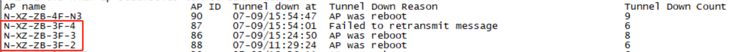

无线ap未知原因离线,想知道离线原因

看掉线原因回显是链路超时了,检查一下AC与AP之间链路吧
需要看看过路的接入设备是否有异常日志
dis wlan ap sta tu
有重启 ,还有检查下连通性

AP name AP ID Tunnel down at Tunnel Down Reason Tunnel Down Count N-XZ-ZB-4F-N3 90 07-09/15:54:47 AP was reboot 9 N-XZ-ZB-3F-4 87 07-09/15:54:01 Failed to retransmit message 6 N-XZ-ZB-3F-3 86 07-09/15:24:50 AP was reboot 8 N-XZ-ZB-3F-2 88 07-09/11:29:24 AP was reboot 6 XZ-SYJD-1F-N-Z 20 07-09/10:26:11 AP was reboot 6

老师。下面有截图。

有重启 ,还有检查下连通性

是不是授权不够,或者 ,POE供电光率不够
授权是够的,已经确认了。poe供电这个不会查,网线供电
