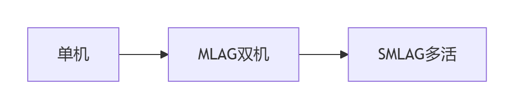

H3C S6850-56HF 基础MLAG配置实例​​
​​拓扑结构​​
​​配置步骤​​
# Step 1. 启用MLAG功能并配置集群名称 system-view mad enable # 启用多活检测 mad domain name MLAG_CLUSTER # 集群名 # Step 2. 配置Peer-Link(关键物理链路) interface Ten-GigabitEthernet1/0/49 # 推荐49-50口作Peer-Link port link-aggregation group 1 # 创建逻辑聚合口 quit interface Bridge-Aggregation1 # 逻辑聚合口1 port link-type trunk port trunk permit vlan all mad peer-link enable # 声明为Peer-Link quit # Step 3. 创建Keepalive链路(防脑裂) interface Vlan-interface100 # 独立管理VLAN ip address 10.1.100.1 255.255.255.252 mad keepalive destination 10.1.100.2 source 10.1.100.1 # 指向对端IP quit # Step 4. 配置MLAG接口组 interface Bridge-Aggregation10 # 服务器聚合口 port link-type trunk port trunk permit vlan 10,20 mlag group 1 # 绑定到MLAG组1 quit # Step 5. 将物理口加入聚合组(两端相同配置) interface Ten-GigabitEthernet1/0/1 port link-aggregation group 10 quit

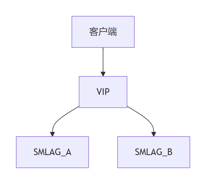

  • ​​SMLAG​​
    所有流量先进入 ​​逻辑统一网关(VIP)​​ → 智能负载均衡到最优路径

SMLAGPECP(私有隧道探测)VIP漂移至健康节点
​​3. 配置关键差异​​
​​SMLAG必备配置​​(MLAG无此要求):
# 启用VXLAN和分布式网关 evpn-overlay enable vxlan tunnel arp-learning distributed-gateway # 创建SMLAG逻辑网关 interface Vsi-interface1 ip address 10.1.1.254 255.255.255.0 vrrp # 虚拟IP vrrp version 3 vrrp priority 120
