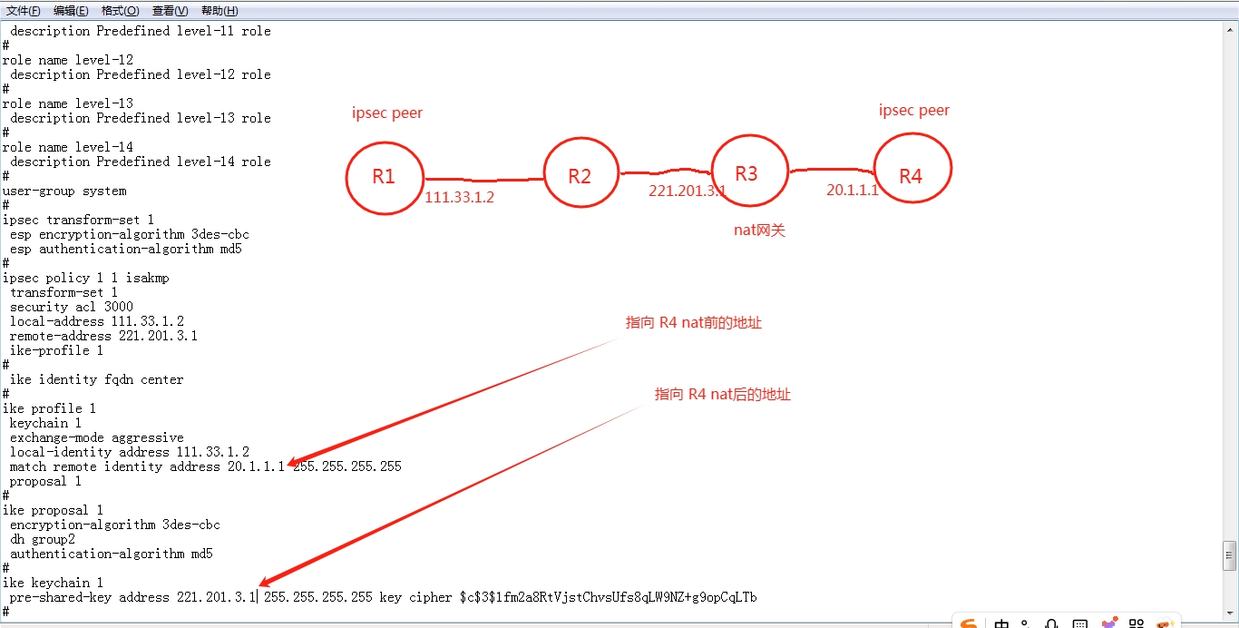

IPSECnat穿越 总部和分支都指向对方的ip地址但建立不起来,关键报错信息含义是什么意思
2025-08-09提问
  • 0收藏,1307浏览
从分支向总部发起,建立不起来,在R1总部端查看debugging ike all关键报错信息含义是什么
*Aug  9 11:23:44:715 2025 H3C IKE/7/EVENT: No pre-shared key found based on address 20.1.1.2.
*Aug  9 11:23:44:715 2025 H3C IKE/7/EVENT: vrf = 0, local = 111.33.1.2, remote = 221.201.3.1/2
Pre-shared key matching address 221.201.3.1 not found.
*Aug  9 11:23:44:715 2025 H3C IKE/7/ERROR: vrf = 0, local = 111.33.1.2, remote = 221.201.3.1/2
No acceptable transform.
Failed to parse the IKE SA payload.
*Aug  9 11:23:44:715 2025 H3C IKE/7/PACKET: vrf = 0, local = 111.33.1.2, remote = 221.201.3.1/2
Construct notification packet: NO_PROPOSAL_CHOSEN.
分部访问总部时在总部debugging ike all 的信息
完整的debugging信息

*Aug  9 11:23:14:711 2025 H3C IKE/7/EVENT: No pre-shared key found based on address 20.1.1.2.
*Aug  9 11:23:14:711 2025 H3C IKE/7/EVENT: vrf = 0, local = 111.33.1.2, remote = 221.201.3.1/2
*Aug  9 11:23:14:711 2025 H3C IKE/7/ERROR: vrf = 0, local = 111.33.1.2, remote = 221.201.3.1/2
*Aug  9 11:23:14:711 2025 H3C IKE/7/PACKET: vrf = 0, local = 111.33.1.2, remote = 221.201.3.1/2
Peer ID value: address 20.1.1.2.
The profile 1 is matched.
Process SA payload.
Check ISAKMP transform 1.
  Encryption algorithm is 3DES-CBC.
  HASH algorithm is HMAC-MD5.
  DH group is 5.
  Authentication method is Pre-shared key.
  Lifetime type is 1.
  Life duration is 86400.
Sending packet to 221.201.3.1 remote port 2, local port 500.
  I-COOKIE: 17cb312c607bac1b
  R-COOKIE: 0000000000000000
  next payload: NOTIFY
  version: ISAKMP Version 1.0
  exchange mode: Info
  flags:
  message ID: 0
  length: 56
Sending an IPv4 packet.
Sent data to socket successfully.
Failed to negotiate IKE SA.

打个400或联系购买渠道由专业工程师协助下吧
目前信息
1、配置不全判断不了
2、debug看协商密钥未匹配
3、信息都不全,没法分析。大概率还是配置问题可能性较大
zhiliao_cJ2xp 知了小白
粉丝:2人 关注:1人
需要远程调试,可以私聊!
