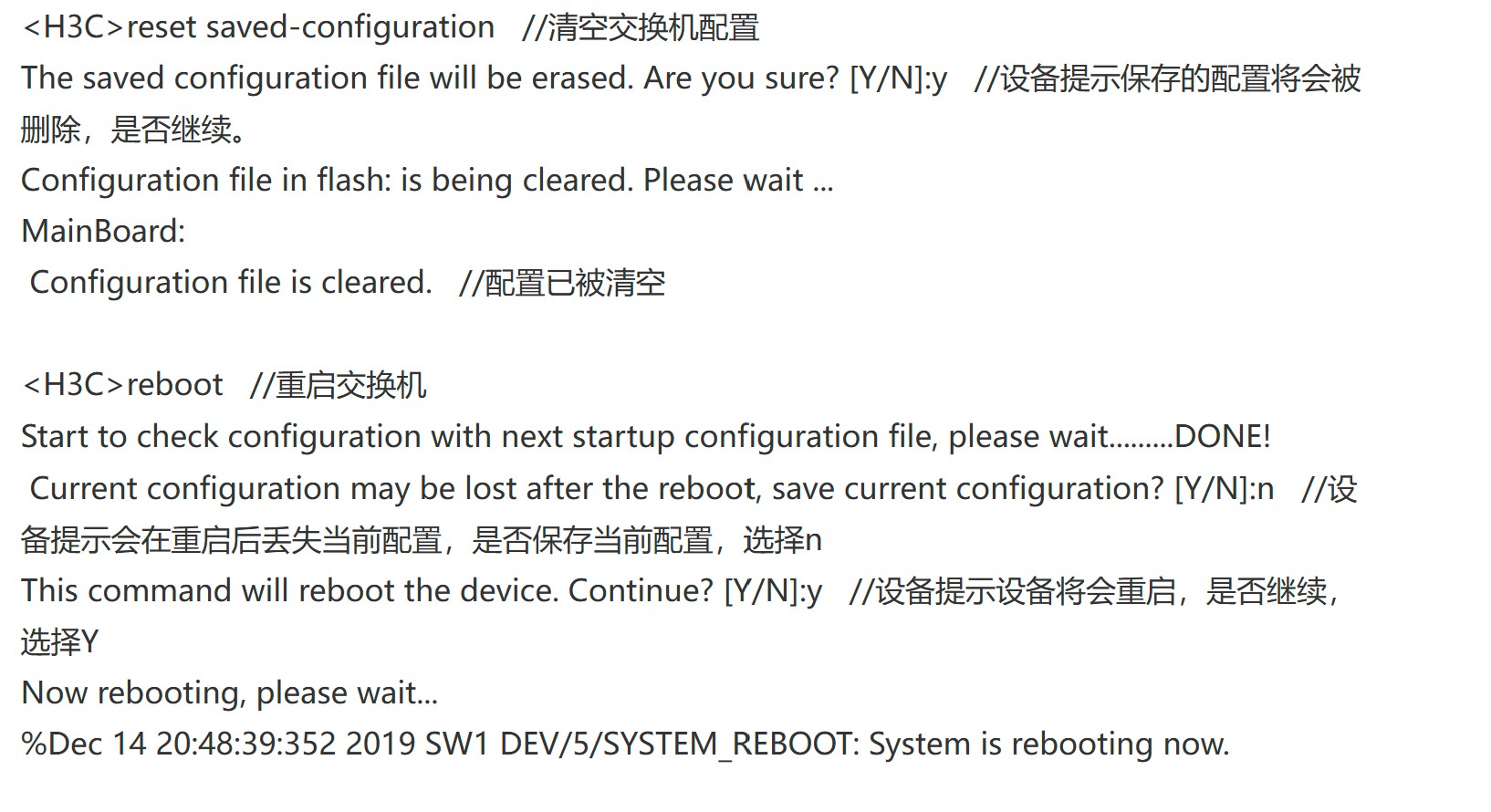

这样操作:
H3C>reset saved-configuration   //清空交换机配置
The saved configuration file will be erased. Are you sure? [Y/N]:y   //设备提示保存的配置将会被删除,是否继续。
Configuration file in flash: is being cleared. Please wait ...
MainBoard:
 Configuration file is cleared.   //配置已被清空
<H3C>reboot   //重启交换机
Start to check configuration with next startup configuration file, please wait.........DONE!
 Current configuration may be lost after the reboot, save current configuration? [Y/N]:n   //设备提示会在重启后丢失当前配置,是否保存当前配置,选择n
This command will reboot the device. Continue? [Y/N]:y   //设备提示设备将会重启,是否继续,选择Y
Now rebooting, please wait...
%Dec 14 20:48:39:352 2019 SW1 DEV/5/SYSTEM_REBOOT: System is rebooting now.

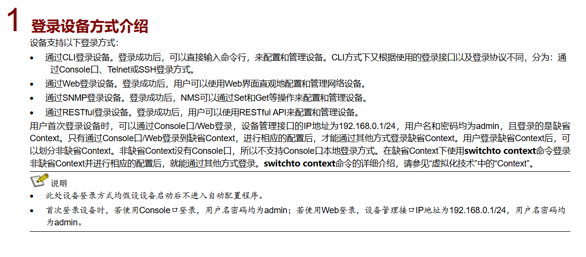

怎么复原的?命令行就dis ip int brie  然后电脑插有Ip的网口
