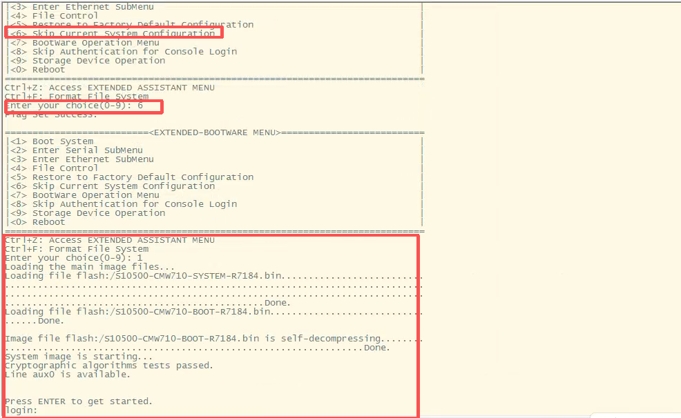

      按住“Ctrl+B”进入如下菜单。选择“<6> Skip Current System Configuration”跳过当前配置启动,不同设备可能不是数字6,
===========================<EXTEND-BOOTWARE MENU>===========================
|<1> Boot System                                                           |
|<2> Enter Serial SubMenu                                                  |
|<3> Enter Ethernet SubMenu                                                |
|<4> File Control                                                          |
|<5> Restore to Factory Default Configuration                              |
|<6> Skip Current System Configuration                                     |
|<7> BootWare Operation Menu                                               |
|<8> Clear Super Password                                                  |
|<9> Storage Device Operation                                              |
|<0> Reboot                                                                |
Ctrl+Z: Access EXTEND-ASSISTANT MENU
Ctrl+F: Format File System
Enter your choice(0-9): 6
Flag Set Success.
然后输入0重启设备

1.重启,进到EXTENDED BOOT MENU里,选7 Skip current system configuration(跳过当前配置)。前提是你没把密码恢复功能关掉。
2.等启动完以后用more startup.cfg命令把配置读出来编辑一下,然后刷进去保存。前提是你没开配置文件加密功能。当然,直接这时候直接用命令行配置ftp导出文件也可以。注意在拿到配置文件前不要保存,不然会覆盖掉。
Press Ctrl+B to access EXTENDED BOOT MENU...0
Password recovery capability is enabled.
EXTENDED BOOT MENU
1. Download image to flash
2. Select image to boot
3. Display all files in flash
4. Delete file from flash
5. Restore to factory default configuration
6. Enter BootRom upgrade menu
7. Skip current system configuration
8. Set switch startup mode
9. Set The Operating Device
0. Reboot
Ctrl+Z: Access EXTENDED ASSISTANT MENU
Ctrl+F: Format file system
Ctrl+P: Change authentication for console login
Ctrl+R: Download image to SDRAM and run
Ctrl+C: Display Copyright
