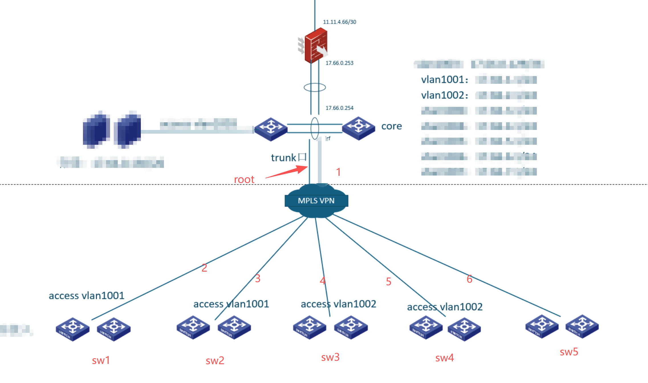

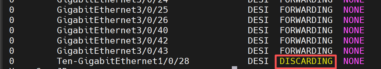

如图所示,sw1~sw5的端口都是access口对应vlan,网关都是core上,1口是根桥,4口被堵塞了,如何解决
%Jan 17 03:44:42:386 2013 **** STP/4/STP_DISPUTE: Instance  0's port Ten-GigabitEthernet1/0/28 received an inferior BPDU from a designated port which is in forwarding or learning state. The designated bridge ID contained in the BPDU is ****, and the designated port ID contained in the BPDU is 128.52.

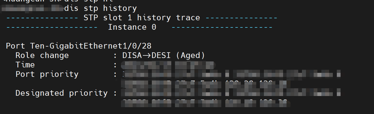

日志里端口收到了低优先级的bpdu,被dispute了,看下中间是不是单通了
09.《交换那些事儿 》- 基础维护篇 - 揭秘STP Dispute保护机制 - 知了社区
你拓扑不对吧,MPLS VPN是三层组网,你应该想表达的是MSTP电路吧

STP bpdu单通造成的阻塞问题(触发了stp dispute),这都排查不出来吗?4口的上联是否禁止vlan 1通过了?
