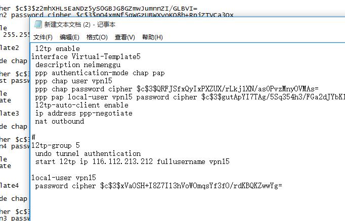

电脑上建立连接可以l2tp拨号成功,但是路由器就无法拨号成功,获得不了配置。
感觉配置没有问题,因为同样的配置拨号别的路由器就可以,但是不会拍错,求排错过程。
Internet protocol processing : disabled
应该是协议没有建立起来,这个如何解决
local-user vpn15配置少了service-type ppp
%Jan 1 17:38:34:557 2012 H3C IFNET/5/LINEPROTO_UPDOWN: Line protocol on the interface Virtual-Template5:1 is DOWN. %Jan 1 17:39:04:591 2012 H3C IFNET/5/LINEPROTO_UPDOWN: Line protocol on the interface Virtual-Template5:1 is UP. %Jan 1 17:39:04:592 2012 H3C IFNET/5/LINEPROTO_UPDOWN: Line protocol on the interface Virtual-Template5:0 is UP. %Jan 1 17:39:05:172 2012 H3C IFNET/5/LINEPROTO_UPDOWN: Line protocol on the interface Virtual-Template5:0 is DOWN. %Jan 1 17:39:08:355 2012 H3C IFNET/5/LINEPROTO_UPDOWN: Line protocol on the interface Virtual-Template5:1 is DOWN. %Jan 1 17:39:38:369 2012 H3C IFNET/5/LINEPROTO_UPDOWN: Line protocol on the interface Virtual-Template5:1 is UP. %Jan 1 17:39:38:369 2012 H3C IFNET/5/LINEPROTO_UPDOWN: Line protocol on the interface Virtual-Template5:0 is UP. %Jan 1 17:39:38:633 2012 H3C IFNET/5/LINEPROTO_UPDOWN: Line protocol on the interface Virtual-Template5:0 is DOWN. %Jan 1 17:39:41:659 2012 H3C IFNET/5/LINEPROTO_UPDOWN: Line protocol on the interface Virtual-Template5:1 is DOWN. %Jan 1 17:40:11:668 2012 H3C IFNET/5/LINEPROTO_UPDOWN: Line protocol on the interface Virtual-Template5:0 is UP. %Jan 1 17:40:11:668 2012 H3C IFNET/5/LINEPROTO_UPDOWN: Line protocol on the interface Virtual-Template5:1 is UP. %Jan 1 17:40:11:825 2012 H3C IFNET/5/LINEPROTO_UPDOWN: Line protocol on the interface Virtual-Template5:0 is DOWN. %Jan 1 17:40:14:967 2012 H3C IFNET/5/LINEPROTO_UPDOWN: Line protocol on the interface Virtual-Template5:1 is DOWN.
qq161040038 发表时间:2018-10-23 更多>>
粉丝:39人 关注:5人
%Jan 1 17:41:21:025 2012 H3C IFNET/5/LINEPROTO_UPDOWN: Line protocol on the interface Virtual-Template5:0 is UP.
 %Jan 1 17:41:21:158 2012 H3C IFNET/5/LINEPROTO_UPDOWN: Line protocol on the interface Virtual-Template5:0 is DOWN.
反复这样
