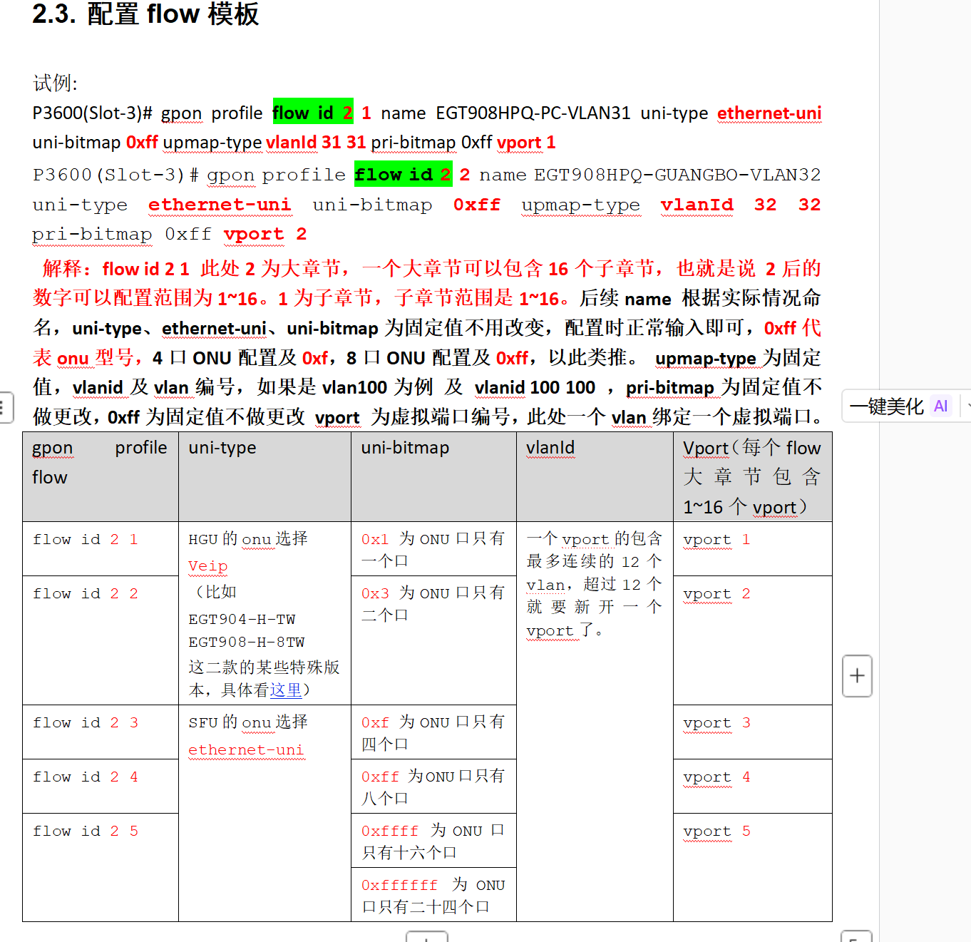

# 创建5条flow模板映射vlan和vport端口:
P3600(Slot-3)# gpon profile flow id 2 1 name EGT908HPQ-PC-VLAN31 uni-type ethernet-uni uni-bitmap 0xff upmap-type vlanId 31 31 pri-bitmap 0xff vport 1
P3600(Slot-3)# gpon profile flow id 2 2 name EGT908HPQ-GUANGBO-VLAN32 uni-type ethernet-uni uni-bitmap 0xff upmap-type vlanId 32 32 pri-bitmap 0xff vport 2
P3600(Slot-3)# gpon profile flow id 2 3 name EGT908HPQ-JIANKONG-VLAN33 uni-type ethernet-uni uni-bitmap 0xff upmap-type vlanId 33 33 pri-bitmap 0xff vport 3
P3600(Slot-3)# gpon profile flow id 2 4 name EGT908HPQ-AP-YEWU-VLAN34 uni-type ethernet-uni uni-bitmap 0xff upmap-type vlanId 34 34 pri-bitmap 0xff vport 4
P3600(Slot-3)# gpon profile flow id 2 5 name EGT908HPQ-AP-GUANLI-VLAN44 uni-type ethernet-uni uni-bitmap 0xff upmap-type vlanId 44 44 pri-bitmap 0xff vport 5

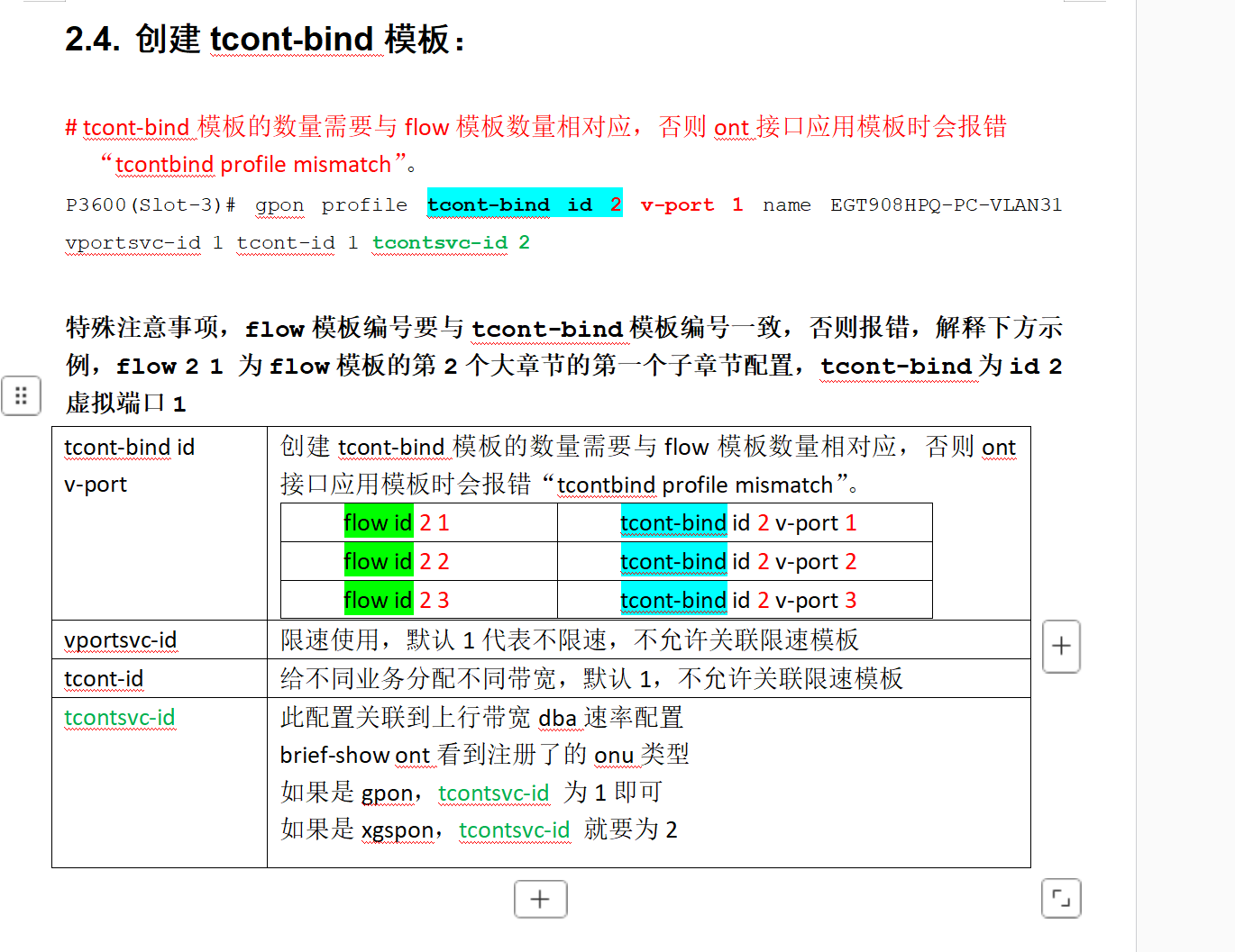

创建tcony-bind模板
P3600(Slot-3)# gpon profile tcont-bind id 2 v-port 1 name EGT908HPQ-PC-VLAN31 vportsvc-id 1 tcont-id 1 tcontsvc-id 2
P3600(Slot-3)# gpon profile tcont-bind id 2 v-port 2 name EGT908HPQ-GUANGBO-VLAN32 vportsvc-id 1 tcont-id 1 tcontsvc-id 2
P3600(Slot-3)# gpon profile tcont-bind id 2 v-port 3 name EGT908HPQ-JIANKONG-VLAN33 vportsvc-id 1 tcont-id 1 tcontsvc-id 2
P3600(Slot-3)# gpon profile tcont-bind id 2 v-port 4 name EGT908HPQ-AP-YEWU-VLAN34 vportsvc-id 1 tcont-id 1 tcontsvc-id 2
P3600(Slot-3)# gpon profile tcont-bind id 2 v-port 5 name EGT908HPQ-AP-GUANLI-VLAN44 vportsvc-id 1 tcont-id 1 tcontsvc-id 2

补充下flow模板和t-cont模板的一些详解:
