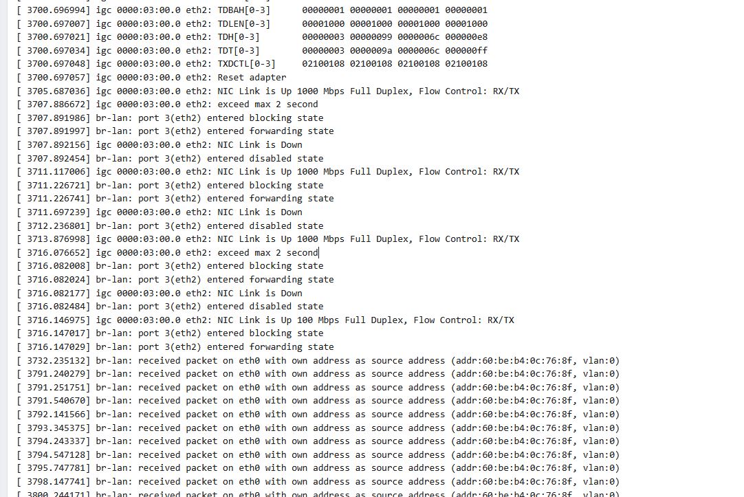

NX15000与NX54组有线回程mesh,均作为ap。 连接openwrt软路由,
设备型号:H3C Magic NX15000,需要渠道固件 NX15V100R015,用于优化有线 Mesh 组播异常, SN 序列号:219801A3HN7232K500SH;
设备型号:H3C Magic NX54,需要渠道固件 R014,用于优化有线 Mesh 组播异常, SN 序列号:219801A2V2722AK504F7;
nx54,nx15000分别连接到 openwrt软路由。组有线mesh。
目前排查就是mesh组网问题。
nx54 启动后,与软路由协商后,连接为1000兆, 间隔几分钟后,就降低到100兆。
软路由日志中可以看到:
[ 3711.117006] igc 0000:03:00.0 eth2: NIC Link is Up 1000 Mbps Full Duplex, Flow Control: RX/TX
[ 3711.226721] br-lan: port 3(eth2) entered blocking state
[ 3711.226741] br-lan: port 3(eth2) entered forwarding state
[ 3711.697239] igc 0000:03:00.0 eth2: NIC Link is Down
[ 3712.236801] br-lan: port 3(eth2) entered disabled state
[ 3713.876998] igc 0000:03:00.0 eth2: NIC Link is Up 1000 Mbps Full Duplex, Flow Control: RX/TX
[ 3716.076652] igc 0000:03:00.0 eth2: exceed max 2 second
[ 3716.082008] br-lan: port 3(eth2) entered blocking state
[ 3716.082024] br-lan: port 3(eth2) entered forwarding state
[ 3716.082177] igc 0000:03:00.0 eth2: NIC Link is Down
[ 3716.082484] br-lan: port 3(eth2) entered disabled state
[ 3716.146975] igc 0000:03:00.0 eth2: NIC Link is Up 100 Mbps Full Duplex, Flow Control: RX/TX
[ 3716.147017] br-lan: port 3(eth2) entered blocking state
[ 3716.147029] br-lan: port 3(eth2) entered forwarding state
[ 3732.235132] br-lan: received packet on eth0 with own address as source address (addr:60:be:b4:0c:76:8f, vlan:0)
[ 3791.240279] br-lan: received packet on eth0 with own address as source address (addr:60:be:b4:0c:76:8f, vlan:0)
[ 3791.251751] br-lan: received packet on eth0 with own address as source address (addr:60:be:b4:0c:76:8f, vlan:0)
[ 3791.540670] br-lan: received packet on eth0 with own address as source address (addr:60:be:b4:0c:76:8f, vlan:0)
[ 3792.141566] br-lan: received packet on eth0 with own address as source address (addr:60:be:b4:0c:76:8f, vlan:0)
[ 3793.345375] br-lan: received packet on eth0 with own address as source address (addr:60:be:b4:0c:76:8f, vlan:0)
[ 3794.243337] br-lan: received packet on eth0 with own address as source address (addr:60:be:b4:0c:76:8f, vlan:0)

一、日志关键异常拆解(两张日志对应故障点)
1. OpenWrt eth2(对接 NX54)网卡日志核心问题
端口频繁闪断(Link Up/Down 循环)
上电协商千兆→几秒后端口 Down→重新协商,直接降速为 100M 全双工,循环反复。
plaintext
NIC Link is Up 1000M → NIC Link is Down → NIC Link is Up 100M
exceed max 2 second 网卡协商超时告警
桥环路风暴告警
有线 Mesh 组网产生二层环路,自环报文泛滥,大量组播 / 广播风暴占用 CPU。
网卡 IGC 驱动持续复位适配器Reset adapter,协商不稳定加剧闪断。

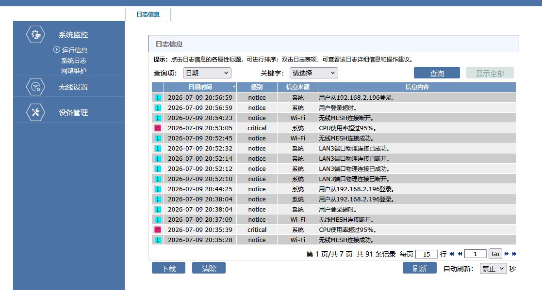

LAN3(有线回程口)反复物理连接断开 / 成功,和 OpenWrt eth2 闪断完全对应;
CPU使用率超过95% critical:环路广播风暴 + 端口反复协商,CPU 打满;
无线 MESH 频繁断开重连:有线回程不稳定,无线 Mesh 被迫切换,叠加组播异常。

从你的描述和软路由日志来看,问题核心是NX54与软路由之间的物理链路不稳定,在千兆和百兆间反复震荡,这很可能是导致Mesh组播异常的根源。
🔍 问题根因分析
你的软路由日志清晰地记录了问题发生的过程:
  1. 链路震荡:NX54的端口eth2在1000 Mbps(千兆)和100 Mbps(百兆)之间反复切换。
  2. 协商超时:日志中的exceed max 2 second表明,接口在千兆模式下因某种原因(如信号质量差)协商失败,导致降速。
  3. 环路风险:br-lan: received packet on eth0 with own address as source address这条日志非常关键,意味着OpenWrt软路由的br-lan收到了源MAC地址为自己的数据包,这是典型的网络环路迹象。
综合来看,物理链路问题(如网线、接口)引发了速率震荡,而速率震荡又可能触发了某种环路,最终导致组播等业务异常。

zhiliao_fp4IGf 知了小白
网线已经测试过了。更换软路由接口,问题依旧。 目前只能申请升级估计。
登录账号通常为 yx800,密码 01230123    这个网页显示账号停用。
联系400,目前是等待 确认是否有这个固件。 如果400,不提供升级。咱们社区能帮忙解决吗?
