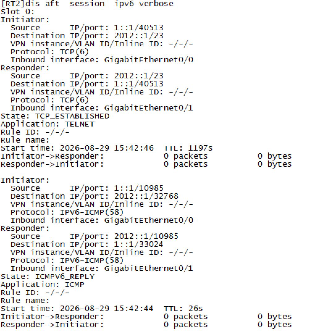

模拟器测试了下案例没有问题。
RT1 (g0/0)-----(g0/0)RT2(g0/1)---- (g0/0)  RT3
[RT1]dis cu interface g0/0
# interface GigabitEthernet0/0
      ipv6 address 1::1/64
 ipv6 route-static :: 0 1::2
RT2
  ipv6 address 1::2/64
 aft enable
interface GigabitEthernet0/1
 aft enable
aft v6tov4 source acl ipv6 number 2000 address-group 0
 aft v4tov6 source 192.168.1.2 2012::1
aft address-group 0
address 30.1.1.1 30.1.1.1
acl ipv6 basic 2000
rule 0 permit
[R3]
ip address 192.168.1.2 255.255.255.0
 ip route-static 0.0.0.0 0 192.168.1.1
