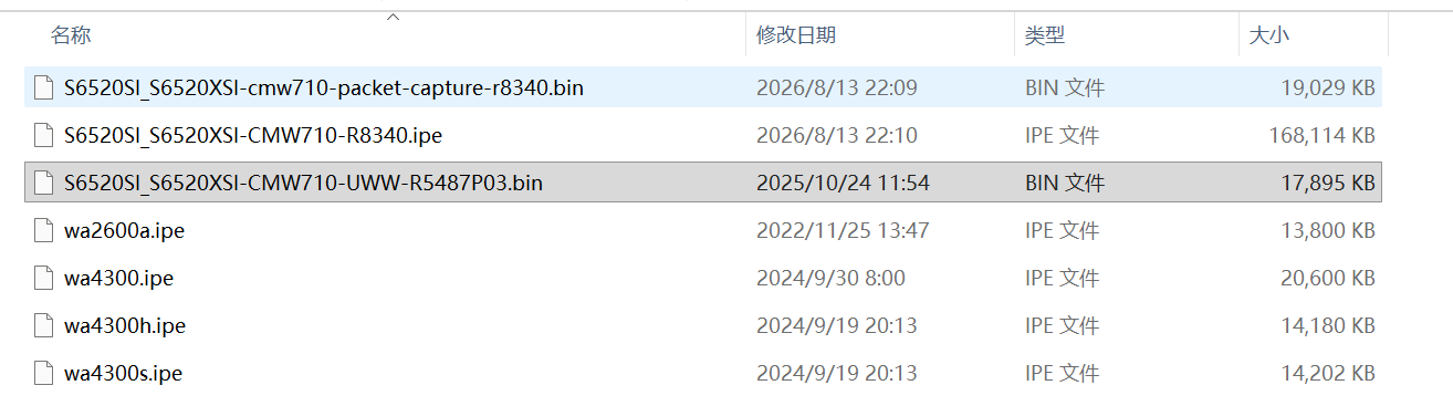

最新的H3C S6520SI_S6520XSI-CMW710-R8340版本固件包,里面附带的是S6520SI_S6520XSI-CMW710-UWW-R5487P03.bin。
UWW 包(wlan):Platform version: 7.1.064
交换机当前系统内核:7.1.070 Release8340
Platform version匹配不上,启用了之后点击打开“无线ac”页面是空白。

从文件日期来看UWW就一直没更新

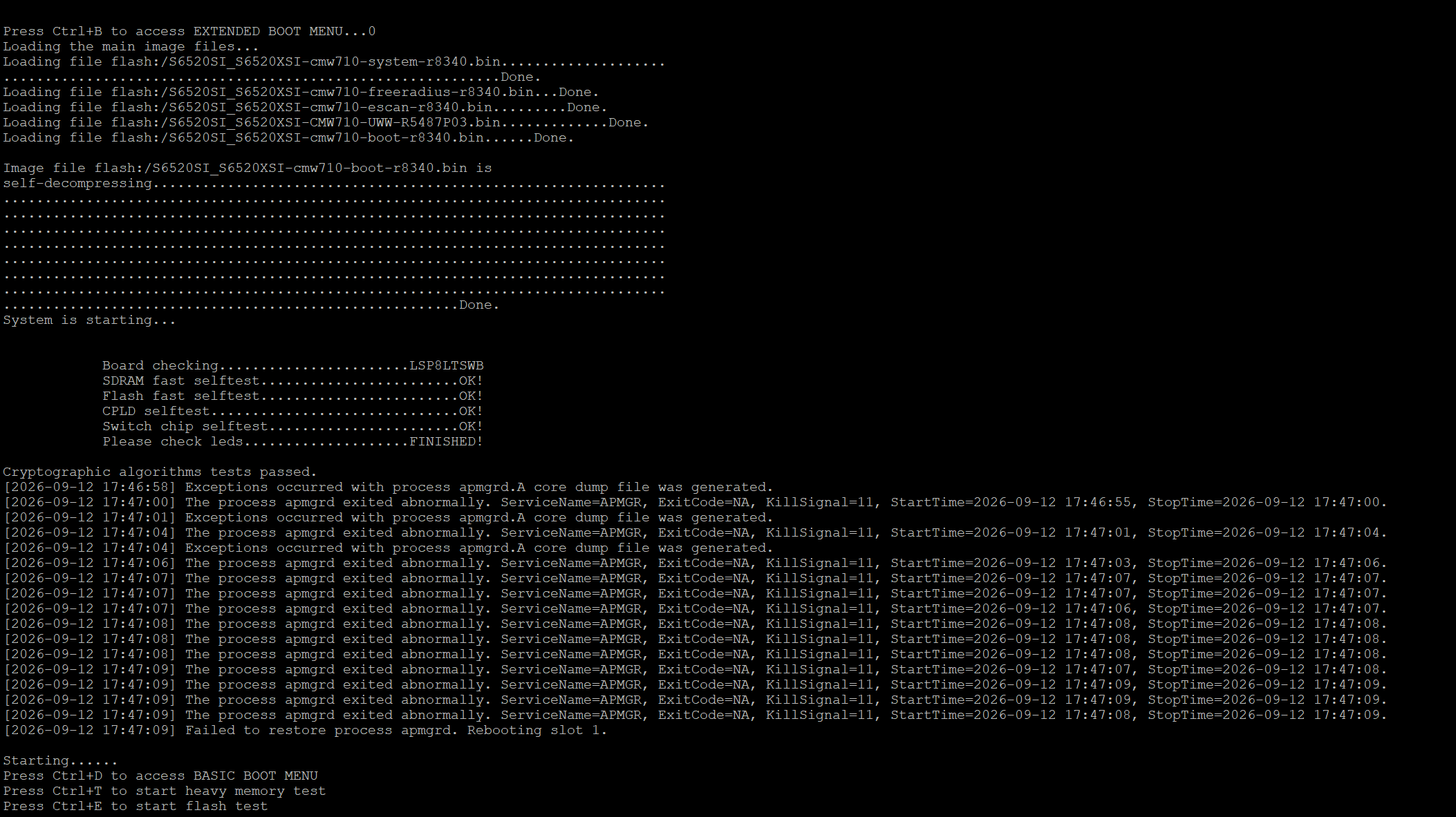

这是安装该UWW重启系统后出现的错误日志,系统就这样循环重启。在启动项里排除UWW的bin才启动成功和停用成功。

是按照命令来的。安装后重启了一下,陷入重启循环了,刚停用UWW恢复正常。 [2026-09-12 17:47:011 Exceptions occurred with process apmgrd.A core dump ,file generated. [2026-09-12 17:47:04] The process apmgrd exited abnormally. ServiceName-APMGR, xitode-NAKil1signal11StartTime-2026-09-1217:47:01StopTime-2026-09-1217:47:04. [2026-09-12 17:47:04]Exceptions occurred with process apmgrd.Acoredumpfilewasgenerated. [2026-09-12 17:47:061 Thei process 3apmgrde exited: abnorma. ServiceName-APMGR, ExitCode-NA, KillSignal-11, ,StartTime=2026-09-12 17:47:03, ,StopTime-2026-09-12 17:47:06. [2026-09-12 17:47:07 The process apmgrd exitedabnormally. ExitCode-NA, Kil1Signal-11, StartTime=2026-09-12 17:47:07, StopTime-2026-09-12 17:47:07. ServiceName-APMGR, [2026-09-12 17:47:071 ServiceName-APMGR, ExitCode-NA, Killsignal-11, StartTime-2026-09-12 17:47:07, StopTime-2026-09-12 The process apmgrde exited abnormally. 17:47:07. [2026-09-12 17:47:07] The process apmgrdexitedabnormally. ServiceName-APMGR, ExitCode-NA, Kilisignal-11, StartTime-2026-09-12 17:47:06, StopTime-2026-09-121 17:47:07. [2026-09-12 17:47:08] apmgrde StartTime-2026-09-12 StopTime-2026-09-12 The process exited abnormally. ServiceName-APMGR, ExitCode-NA, KillSignal-11, 17:47:08, 17:47:08. [2026-09-12 17:47:081 The process apmgrd exitedabnormally. ServiceName-APMGR, ExitCode-NA, KiliSignal-11, StartTime-2026-09-12 17:47:08, StopTime-2026-09-12 17:47:08. [2026-09-12 17:47:081 The process apmgrdexited ServiceName-APMGR, ExitCode-NA, KillSignal-11, StartTime-2026-09-12 17:47:08, StopTime-2026-09-12 17:47:08. [2026-09-12 17:47:091 The abnormally. ,apmgrd exited abnormally. ExitCode-NA, Kil1Signal-11, StartTime-2026-09-12 17:47:07, StopTime-2026-09-12: process ServiceName-APMGR, 17:47:08. [2026-09-12 StopTime-2026-09-12 17:47:091 The process apmgrd exited abnormally. ServiceName-APMGR, ExitCode-NA, Kil1Signal-11, StartTime-2026-09-12 17:47:09, 17:47:09. [2026-09-12: 17:47:09] The apmgrd exitedabnormally. ServiceName-APMGR, ExitCode-NA, Kil1Signal-11, StartTime-2026-09-12 17:47:09, StopTime-2026-09-12 :process 17:47:09. [2026-09-12 17:47:09] The process apmgrd exited 1abnormally. .ServiceName-APMGR, ,ExitCode-NA, . KillSignal-ll, : StartTime-2026-09-1217:47:08, StopTime-2026-09-12 17:47:09. [2026-09-1217:47:09]Failed to restore process apmgrd.Rebooting slot] 1.
