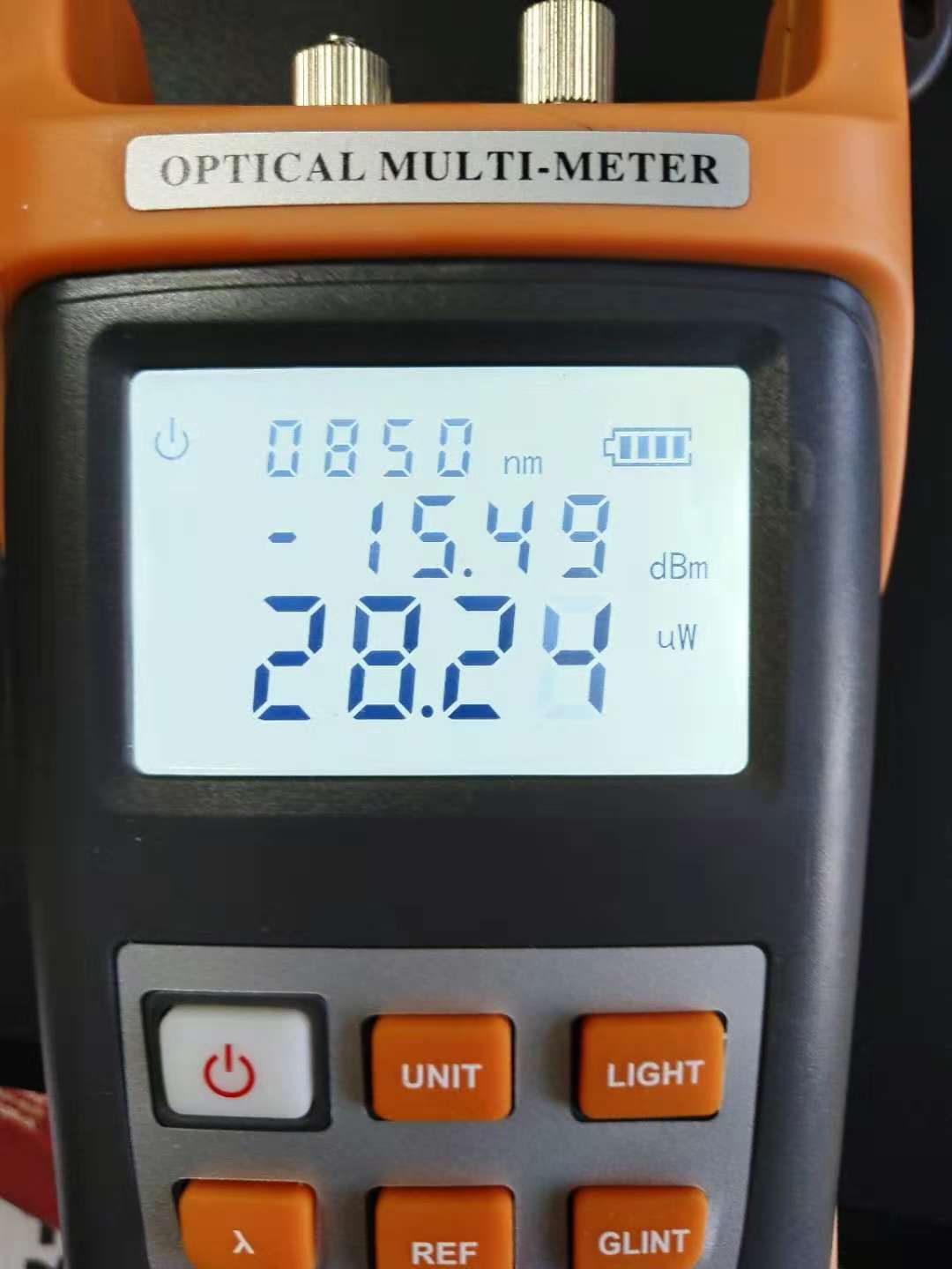

交换机显示光功率与实际测得的光功率差距大
2018-11-28提问
  • 1收藏,4312浏览
[H3C]display transceiver diagnosis interface
GigabitEthernet1/0/25 transceiver diagnostic information:
  Current diagnostic parameters:
    Temp.(°C) Voltage(V)  Bias(mA)  RX power(dBm)  TX power(dBm)
    35         3.31        4.53      -40.00         -5.08
  Alarm thresholds:
    High  81         3.80        44.00     0.00           3.00
    Low   0          2.81        1.00      -16.99         -12.50
GigabitEthernet1/0/26 transceiver diagnostic information:
The transceiver does not support this function.
GigabitEthernet1/0/27 transceiver diagnostic information:
    43         3.35        4.76      -40.00         -5.51
  Alarm thresholds:
          Temp.(°C) Voltage(V)  Bias(mA)  RX power(dBm)  TX power(dBm)      交换机型号华三(H3C) S3100V3-28TP-SI    光模块SFP-GE-SX-MM850-A
是不是还要设置什么  请教大佬们
粉丝:31人 关注:3人
从交换机的显示来看收发光是正常的,不太懂你的测试仪是怎么用的,建议拨打测试的售后问问。
