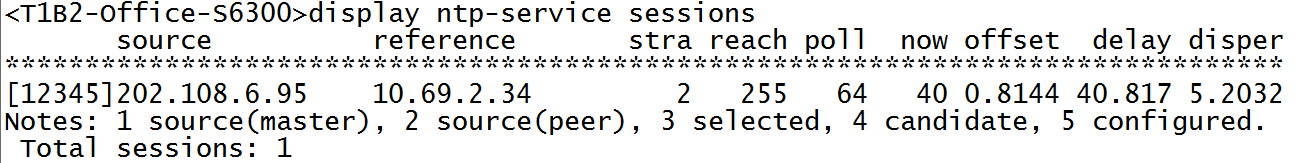

<T1B2-Office-S6300>dis ntp status
Clock status: synchronized
Clock stratum: 3
System peer: 202.108.6.95
Local mode: client Reference
clock ID: 202.108.6.95
Leap indicator: 00
Clock jitter: 0.000443 s
Stability: 0.000 pps
Clock precision: 2^-17
Root delay: 41.30554 ms
Root dispersion: 53.13110 ms
Reference time: dda6a833.db1daca9 Fri, Nov 3 2017 8:32:51.855
<T1B2-Office-S6300>display clock
08:37:30 UTC Fri 11/03/2017
当前实际已经是下午了,时间不对!
<T1B2-Office-S6300>display ntp-service
trace Server 127.0.0.1
Stratum 3, jitter 0.0000, synch distance 0.0414.
Server 202.108.6.95 Stratum 2, jitter 0.3350, synch distance 0.8850.
Server 10.6.63.22: Timeout. RefID 10.6.63.22
