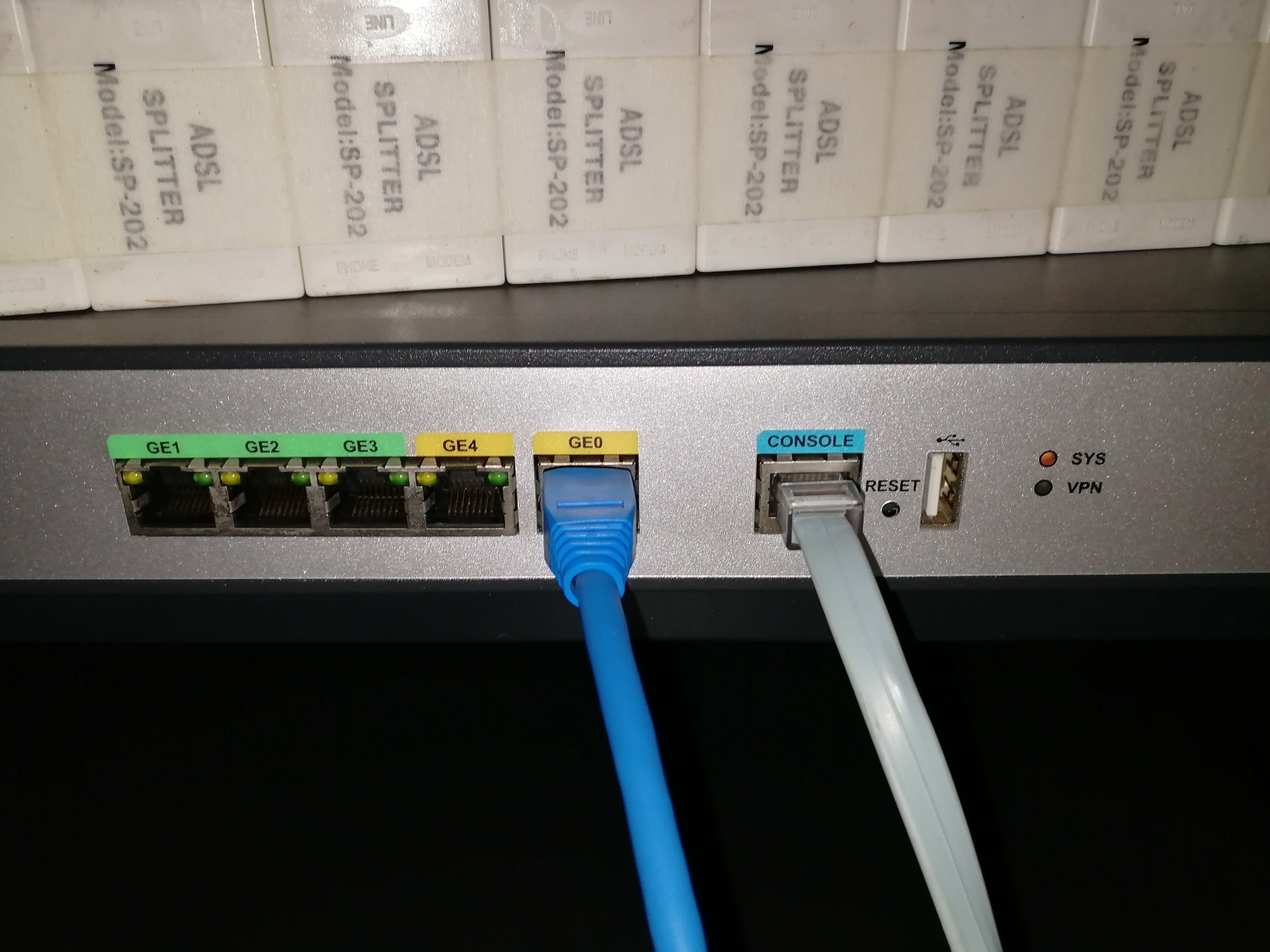

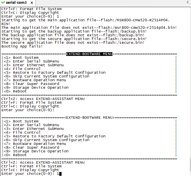

大家好,我们公司有一台旧的 RT-MSR830-WiNet路由器,想进行测试使用。我登录了默认的192.168.0.1地址,电脑网段为同网段,电脑一直ping不通,无法进去;然后通过串口线命令行进去的状态如图 RT-MSR830-WiNet所示,目前的设备等状态如图2所示。已经按过reset键重置,还是这样的状态。华三路由器小白,想请教诸位大神怎么处理,谢谢

版本丢失,开机自动进入bootware界面,可以官网下载对应的版本,参照版本说明书中的指导完成升级
回复MH:
兄嘚,好好看看版本说明书,要用5> Modify Ethernet Parameter来对接ftp或者tftp服务器,可以自己搭。对接完了才能传文件,传完了再指定升级。

pc搭建TFTP服务,在路由器界面选3,配置ip地址和需要升级的固件文件名。

参照bootware升级的指导,版本说明书里有

===========================<EXTEND-BOOTWARE MENU>=========================== |<1> Boot System | |<2> Enter Serial SubMenu | |<3> Enter Ethernet SubMenu | |<4> File Control | |<5> Restore to Factory Default Configuration | |<6> Skip Current System Configuration | |<7> BootWare Operation Menu | |<8> Clear Super Password | |<9> Storage Device Operation | |<0> Reboot | ============================================================================ Ctrl+Z: Access EXTEND-ASSISTANT MENU Ctrl+F: Format File System Ctrl+C: Display Copyright Enter your choice(0-9): 3 ==========================<Enter Ethernet SubMenu>========================== |Note:the operating device is flash | |<1> Download Application Program To SDRAM And Run | |<2> Update Main Application File | |<3> Update Backup Application File | |<4> Update Secure Application File | |<5> Modify Ethernet Parameter | |<0> Exit To Main Menu | |<Ensure The Parameter Be Modified Before Downloading!> | ============================================================================ Enter your choice(0-5): 你好,我进入界面没有东西配置不了

==========================<Enter Ethernet SubMenu>========================== |Note:the operating device is flash | |<1> Download Application Program To SDRAM And Run | |<2> Update Main Application File | |<3> Update Backup Application File | |<4> Update Secure Application File | |<5> Modify Ethernet Parameter | |<0> Exit To Main Menu | |<Ensure The Parameter Be Modified Before Downloading!> | ============================================================================ Enter your choice(0-5): 1 Loading...Failed!

GE0到GE4口灯都不亮,sys系统灯黄灯,VPN灯不亮

版本丢了 上华三官网下载个版本 上传上去
