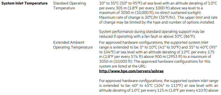

HP DL380G10服务器的工作温度是多少?哪位大侠能告知?最好是官方的说明。

摄氐45度以下
Hewlett Packard Enterprise Extended Ambient 45°C Operating Support (ASHRAE Class A4 compliant) 能到达A4标准也取决于具体的硬件配置. For approved hardware configurations, the supported system inlet range is extended to be: 40° to 45°C (104° to 113°F) at sea level with an altitude derating of 1.0°C per every 125 m (1.8°F per every 410 ft) above 900 m (2953 ft) to a maximum of 3050 m (10,000 ft). The approved hardware configurations for this system are listed at the URL:http://www.hpe.com/servers/ashrae 具体可以参考上面的ashrae标准.

有出处和来源吗?最好是官网或产品宣传资料上的
zhiliao_q0uCw 发表时间:2018-12-17

Mark 八段
粉丝:34人 关注:10人
10° to 35°C (50° to 95°F) at sea level with an altitude derating of 1.0°C per every 305 m (1.8°F per every 1000 ft) above sea level to a maximum of 3050 m (10,000 ft), no direct sustained sunlight.? Maximum rate of change is 20°C/hr (36°F/hr).? The upper limit and rate of change may be limited by the type and number of options installed.
参考:
https://h20195.www2.hpe.com/v2/getdocument.aspx?docname=a00008180enw
您帮我发的链接我打不能,能不能帮忙截个图发我邮箱 ? 113572615@***.*** 谢谢
zhiliao_q0uCw 发表时间:2018-12-17 更多>>
