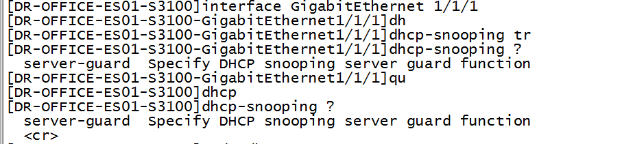

zhiliao_x09ed 知了小白
上连口没有dhcp-snooping trust    ???
