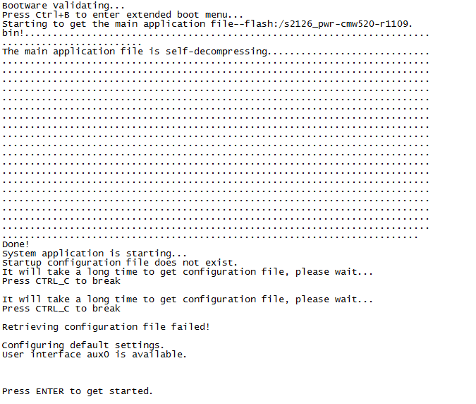

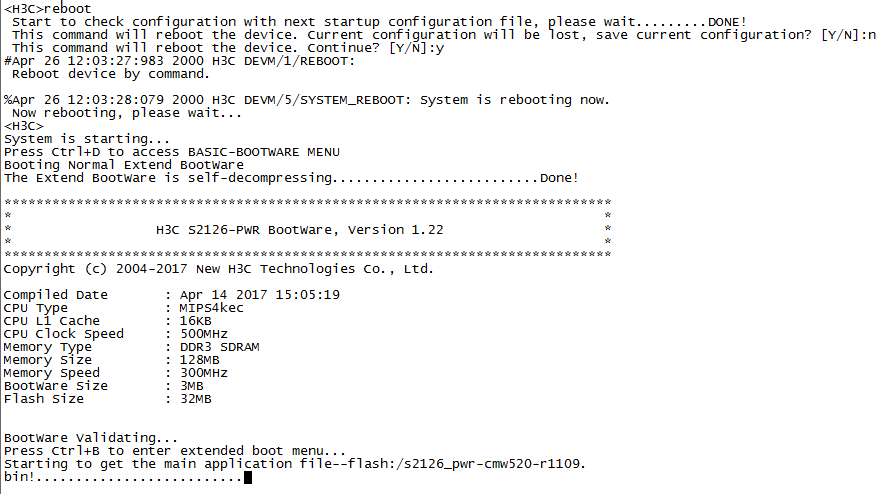

H3C S2126-PWR交换机 升级S2126_PWR-CMW520-R1109.bin后,
设置boot-loader file flash:/s2126_pwr-cmw520-r1109.bin slot 1 main提示成功,
重启就提示Specified boot file does not exist
请问该怎能办?
谢谢。

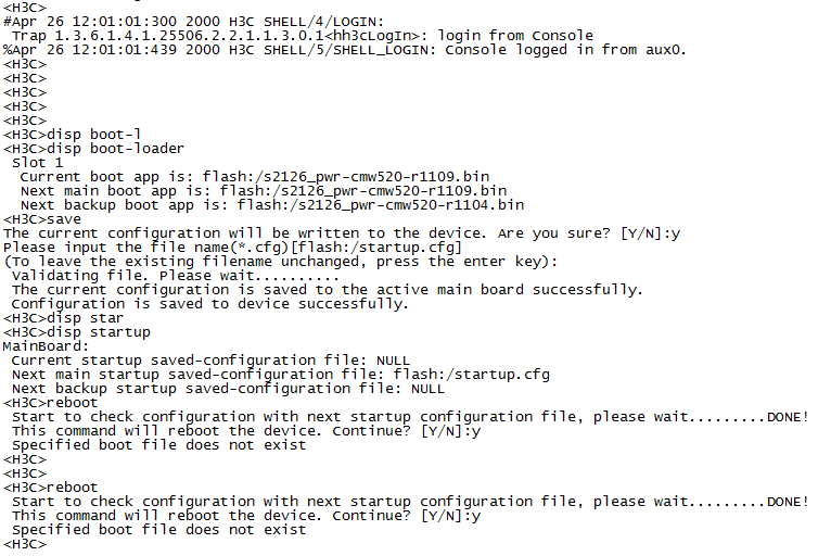

现在设备是空配置的,save保存配置(因为什么都没配置)相当于没保存,所以重启会有提示,你可以在命令行随便锹几条命令,比如interface vlan 1, ip add 192.168.1.1 24给vlan1配置一个IP,再保存重启就不会有问题了。
知了知了 发表时间:2019-03-30
我重新粘贴了之前的配置文件并保存配置文件后重启还是提示Specified boot file does not exist,是不是flash出了问题,我之前format过flash的。
zhiliao_BLlUP 发表时间:2019-03-30
不会的,交换设备不会这么脆弱。你复制粘贴的时候是不是没有在命令行里面敲system进入到[H3C]这个视图,默认用户视图<H3C>配置敲不进去的。

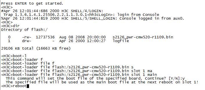

<H3C>dir Directory of flash:/ 0 -rw- 12711936 Aug 08 2008 20:00:00 s2126_pwr-cmw520-r1104.bin 1 drw- - Apr 26 2000 12:00:30 logfile 2 -rw- 7328 Apr 26 2000 12:02:56 config.cwmp 3 -rw- 1424 Apr 26 2000 12:03:03 startup.cfg 4 -rw- 151 Apr 26 2000 12:03:00 system.xml 29106 KB total (16675 KB free) <H3C>reboot Start to check configuration with next startup configuration file, please wait.........DONE! This command will reboot the device. Continue? [Y/N]:y Specified boot file does not exist <H3C>disp <H3C>display boo-l <H3C>display boot-l <H3C>display boot-loader Slot 1 Current boot app is: flash:/s2126_pwr-cmw520-r1104.bin Next main boot app is: flash:/s2126_pwr-cmw520-r1104.bin Next backup boot app is: flash:/s2126_pwr-cmw520-r1104.bin <H3C>disp star <H3C>disp startup MainBoard: Current startup saved-configuration file: NULL Next main startup saved-configuration file: flash:/startup.cfg Next backup startup saved-configuration file: NULL <H3C>reboot Start to check configuration with next startup configuration file, please wait.........DONE! This command will reboot the device. Continue? [Y/N]:y Specified boot file does not exist 我重新格式化了flash,TPTP重传版本文件s2126_pwr-cmw520-r1104.bin,还是这样提示,我修改了文件名,也是一样提示。
