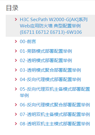

透明的话好像也支持双主的.
http://www.h3c.com/cn/Service/Document_Software/Document_Center/Home/Security/00-Public/Configure/Typical_Configuration_Example/H3C_W2000-G[AK]_Web_CE(E6711)-6W106/
