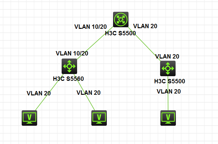

由于VLAN 10和VLAN 20有共同端口,有没有办法监控VLAN 10的流量?

一、流配置如下(将G1/0/1口VLAN 10镜像到G1/0/2口): # traffic classifier mirror_vlan10 operator and if-match customer-vlan-id 10 # traffic behavior mirror_vlan10 mirror-to interface GigabitEthernet1/0/1 # qos policy mirror_vlan10 classifier mirror_vlan10 behavior mirror_vlan10 # interface GigabitEthernet1/0/1 port link-mode bridge port link-type trunk undo port trunk permit vlan 1 port trunk permit vlan 10 20 # interface GigabitEthernet1/0/2 port link-mode bridge port access vlan 20 undo stp enable qos lr inbound cir 61440 cbs 3840000 qos lr outbound cir 61440 cbs 3840000 qos apply policy mirror_vlan10 inbound qos apply policy mirror_vlan10 outbound 最后没生效时什么问题?
