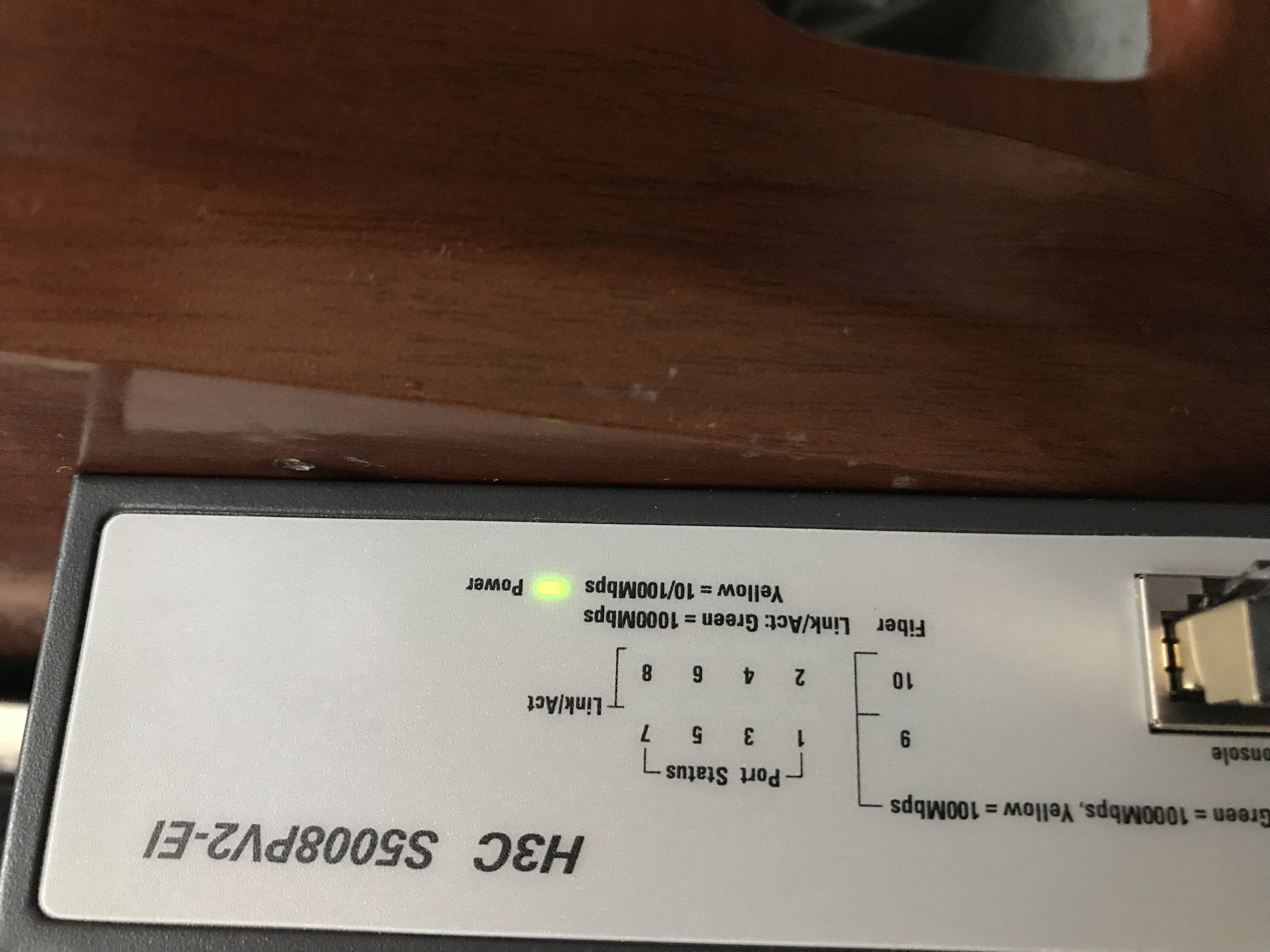

设备开机,power指示灯闪烁,无法进入系统,lan口插入网线,无任何反应,请问怎么升级设备。(希望大神能够将设备与电脑设置同一IP方法也传授一下。谢谢!有图的指导最好了)

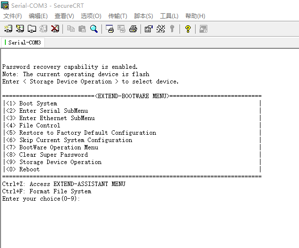

power灯什么颜色,可以登录命令行看一下吗?
你好,看一下,已经截图过去了,谢谢

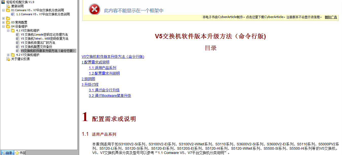

您好,点击以下链接 轻轻松松配交换  下载手册,在04设备维护中有详细的放方法。

应该是版本丢失 https://zhiliao.h3c.com/topic/huati/1246 下载这个链接中有版本升级方式

按 4 再按 1看一下flash里面有没有软件版本,如果没有的话就是软件版本丢失了

===========================<EXTEND-BOOTWARE MENU>=========================== |<1> Boot System | |<2> Enter Serial SubMenu | |<3> Enter Ethernet SubMenu | |<4> File Control | |<5> Restore to Factory Default Configuration | |<6> Skip Current System Configuration | |<7> BootWare Operation Menu | |<8> Clear Super Password | |<9> Storage Device Operation | |<0> Reboot | ============================================================================ Ctrl+Z: Access EXTEND-ASSISTANT MENU Ctrl+F: Format File System Enter your choice(0-9): 3 ==========================<Enter Ethernet SubMenu>========================== |Note:the operating device is flash | |<1> Download Application Program To SDRAM And Run | |<2> Update Main Application File | |<3> Update Backup Application File | |<4> Update Secure Application File | |<5> Modify Ethernet Parameter | |<0> Exit To Main Menu | |<Ensure The Parameter Be Modified Before Downloading!> | ============================================================================ Enter your choice(0-5): 5 ==========================<ETHERNET PARAMETER SET>========================== |Note: '.' = Clear field. | | '-' = Go to previous field. | | Ctrl+D = Quit. | ============================================================================ Protocol (FTP or TFTP) :tftp Load File Name :S5008PV2_EI-CMW520-R1112.ipe :S5008PV2_EI-CMW520-R1112.bin Target File Name :S5008PV2_EI-CMW520-R1112.ipe :S5008PV2_EI-CMW520-R1112.bin Server IP Address :192.168.10.1 Local IP Address :192.168.10.2 Gateway IP Address :0.0.0.0 ==========================<Enter Ethernet SubMenu>========================== |Note:the operating device is flash | |<1> Download Application Program To SDRAM And Run | |<2> Update Main Application File | |<3> Update Backup Application File | |<4> Update Secure Application File | |<5> Modify Ethernet Parameter | |<0> Exit To Main Menu | |<Ensure The Parameter Be Modified Before Downloading!> | ============================================================================ Enter your choice(0-5): 2 Loading..................................................................... ............................................................................ ............................................................................ .............................Done! 12651520 bytes downloaded! Updating File flash:/S5008PV2_EI-CMW520-R1112.bin........................... .......................................................................Done! ==========================<Enter Ethernet SubMenu>========================== |Note:the operating device is flash | |<1> Download Application Program To SDRAM And Run | |<2> Update Main Application File | |<3> Update Backup Application File | |<4> Update Secure Application File | |<5> Modify Ethernet Parameter | |<0> Exit To Main Menu | |<Ensure The Parameter Be Modified Before Downloading!> | ============================================================================ Enter your choice(0-5): 0 ===========================<EXTEND-BOOTWARE MENU>=========================== |<1> Boot System | |<2> Enter Serial SubMenu | |<3> Enter Ethernet SubMenu | |<4> File Control | |<5> Restore to Factory Default Configuration | |<6> Skip Current System Configuration | |<7> BootWare Operation Menu | |<8> Clear Super Password | |<9> Storage Device Operation | |<0> Reboot | ============================================================================ Ctrl+Z: Access EXTEND-ASSISTANT MENU Ctrl+F: Format File System Enter your choice(0-9): 0 System is starting... Press Ctrl+D to access BASIC-BOOTWARE MENU Booting Normal Extend BootWare The Extend BootWare is self-decompressing.......................Done! **************************************************************************** * * * H3C S5008PV2-EI BootWare, Version 1.10 * * * **************************************************************************** Copyright (c) 2004-2014 Hangzhou H3C Technologies Co., Ltd. Compiled Date : Jun 5 2014 11:34:07 CPU Type : MIPS4kec CPU L1 Cache : 16KB CPU Clock Speed : 500MHz Memory Type : DDR3 SDRAM Memory Size : 128MB Memory Speed : 300MHz BootWare Size : 3MB Flash Size : 32MB BootWare Validating... Press Ctrl+B to enter extended boot menu... Starting to get the main application file--flash:/S5008PV2_EI-CMW520-R1112.bin!.................................. .............................................................. The main application file is self-decompressing............................. ............................................................................ ............................................................................ ............................................................................ ............................................................................ ............................................................................ ............................................................................ ............................................................................ ............................................................................ ............................................................................ ............................................................................ ............................................................................ ............................................................................ ............................................................................ ............................................................................ ............................................................................ ............................................................................ ............................................................................ ............................................................................ ............................................................................ ............................................................................ .........................Done! Extend BootWare Version is not equal,updating? [Y/N] Updating Extend BootWare..........Done! Basic BootWare Version is not equal,updating? [Y/N] Updating Basic BootWare..........Done! BootWare updated,System is rebooting now. System is starting... Press Ctrl+D to access BASIC-BOOTWARE MENU Booting Normal Extend BootWare The Extend BootWare is self-decompressing..........................Done! **************************************************************************** * * * H3C S5008PV2-EI BootWare, Version 1.22 * * * **************************************************************************** Copyright (c) 2004-2017 New H3C Technologies Co., Ltd. Compiled Date : Apr 14 2017 15:05:19 CPU Type : MIPS4kec CPU L1 Cache : 16KB CPU Clock Speed : 500MHz Memory Type : DDR3 SDRAM Memory Size : 128MB Memory Speed : 300MHz BootWare Size : 3MB Flash Size : 32MB BootWare Validating... Normal Basic BootWare Version is newer than Backup Basic BootWare! Begin to Update the Backup Basic BootWare............Done! Normal Extend BootWare Version is newer than Backup Extend BootWare! Begin to Update the Backup Extend BootWare..........Done! Press Ctrl+B to enter extended boot menu... Starting to get the main application file--flash:/S5008PV2_EI-CMW520-R1112.bin!.................................. .............................................................. The main application file is self-decompressing............................. ............................................................................ ............................................................................ ............................................................................ ............................................................................ ............................................................................ ............................................................................ ............................................................................ ............................................................................ ............................................................................ ............................................................................ ............................................................................ ............................................................................ ............................................................................ ............................................................................ ............................................................................ ............................................................................ ............................................................................ ............................................................................ ............................................................................ ............................................................................ .........................Done! System application is starting... Configuration file is skipped. User interface aux0 is available. Press ENTER to get started. <H3C> #Apr 26 12:02:15:250 2000 H3C SHELL/4/LOGIN: Trap 1.3.6.1.4.1.25506.2.2.1.1.3.0.1<hh3cLogIn>: login from Console %Apr 26 12:02:15:390 2000 H3C SHELL/5/SHELL_LOGIN: Console logged in from aux0.

因为现在power指示灯常亮

===========================<EXTEND-BOOTWARE MENU>=========================== |<1> Boot System | |<2> Enter Serial SubMenu | |<3> Enter Ethernet SubMenu | |<4> File Control | |<5> Restore to Factory Default Configuration | |<6> Skip Current System Configuration | |<7> BootWare Operation Menu | |<8> Clear Super Password | |<9> Storage Device Operation | |<0> Reboot | ============================================================================ Ctrl+Z: Access EXTEND-ASSISTANT MENU Ctrl+F: Format File System Ctrl+C: Display Copyright Enter your choice(0-9): 这样显示
