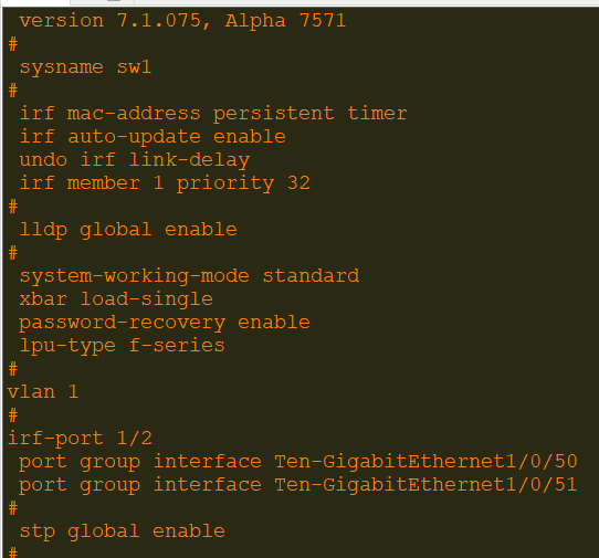

1、sw1
       sys
       irf member 1 renumber 1
       irf member 1 priority 32
       int range Ten 1/0/50 to Ten 1/0/51
       shutdown
       qu
       irf-port 1/2
       port group int Ten 1/0/50
       port group int Ten 1/0/51
       qu
       irf-port-configuration active
       undo shutdown
       sa f

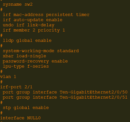

 2、sw2
       sys
       irf member 1 renumber 2
       sa f
       qu
       reboot
       int range Ten 2/0/50 to Ten 2/0/51
       shutdown
       qu
       irf-port 2/1
       port group int Ten 2/0/50
       port group int Ten 2/0/51
       qu
       undo shutdown
       sa f

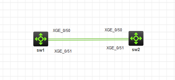

 3、连线
1、拓扑

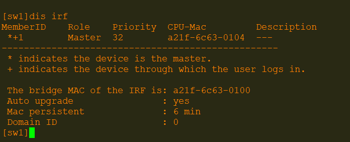

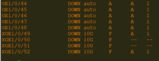

4、但是 它们的端口50、51 的状态都是 down,
5、查看 irf 堆叠成功
